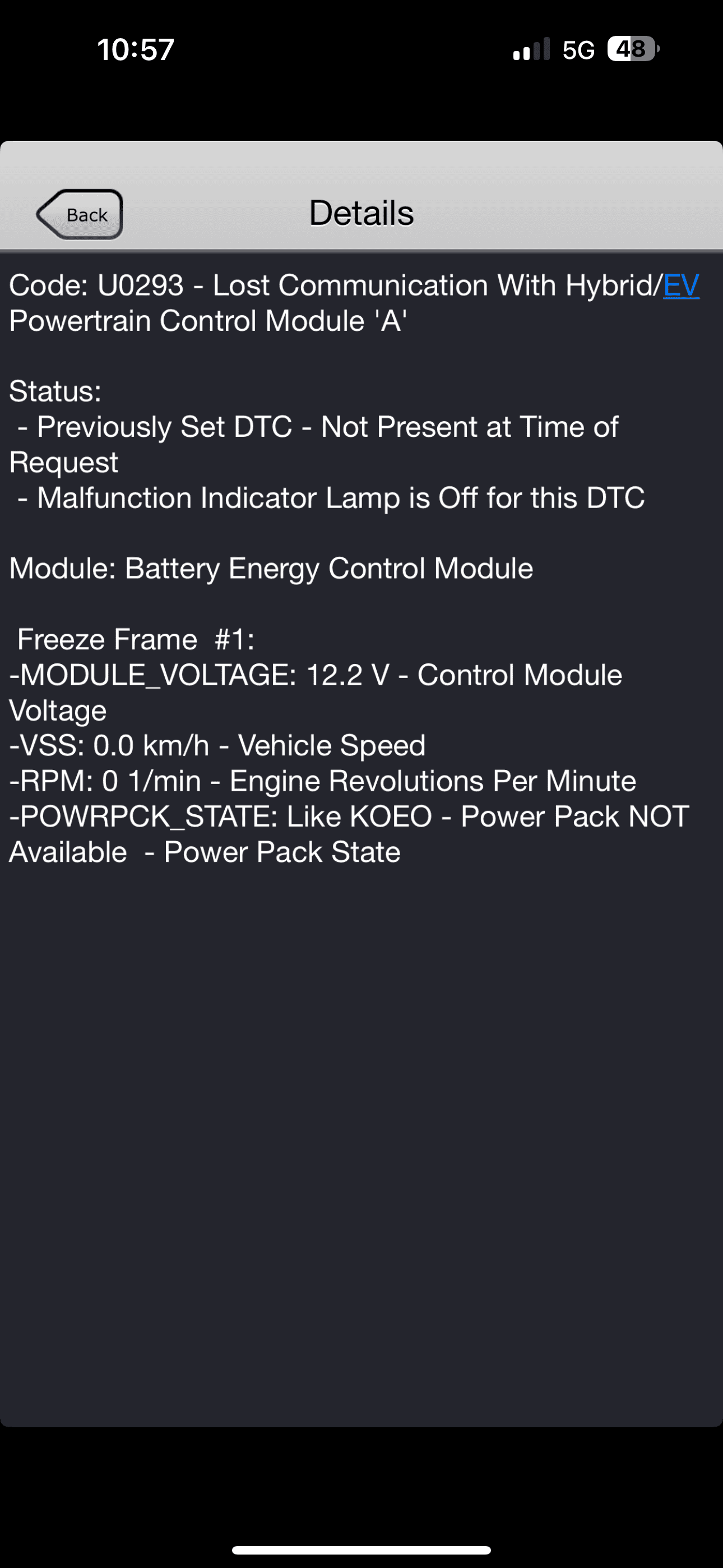

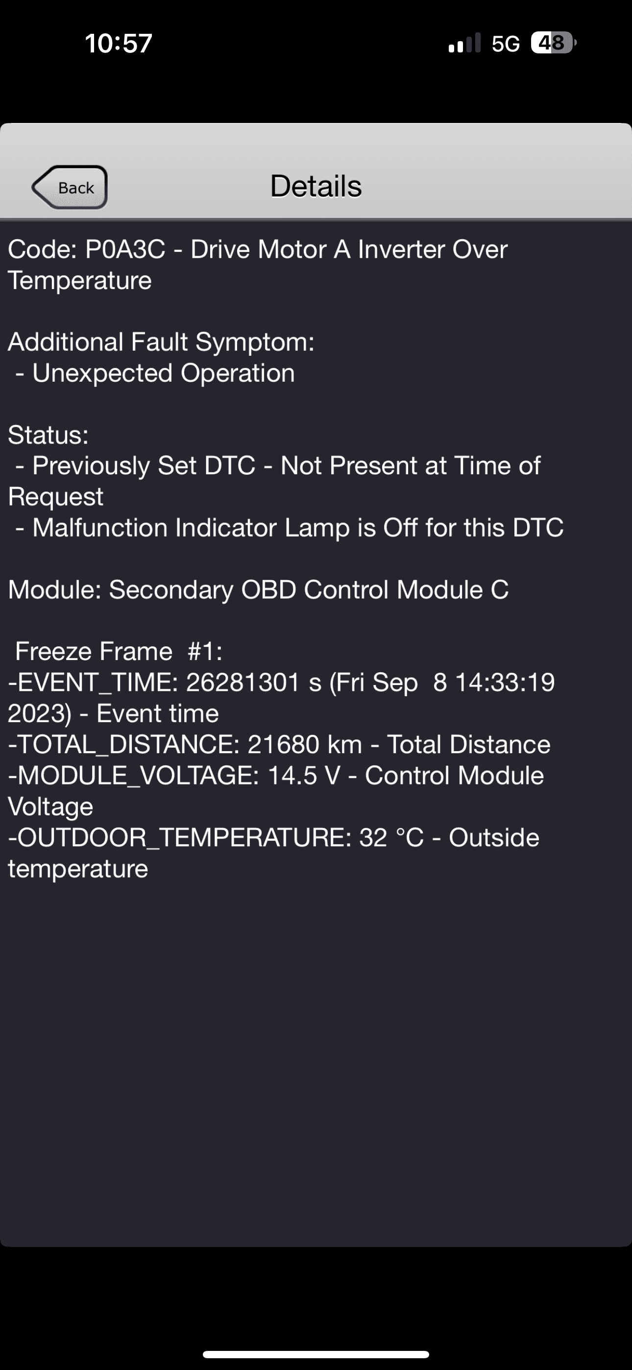

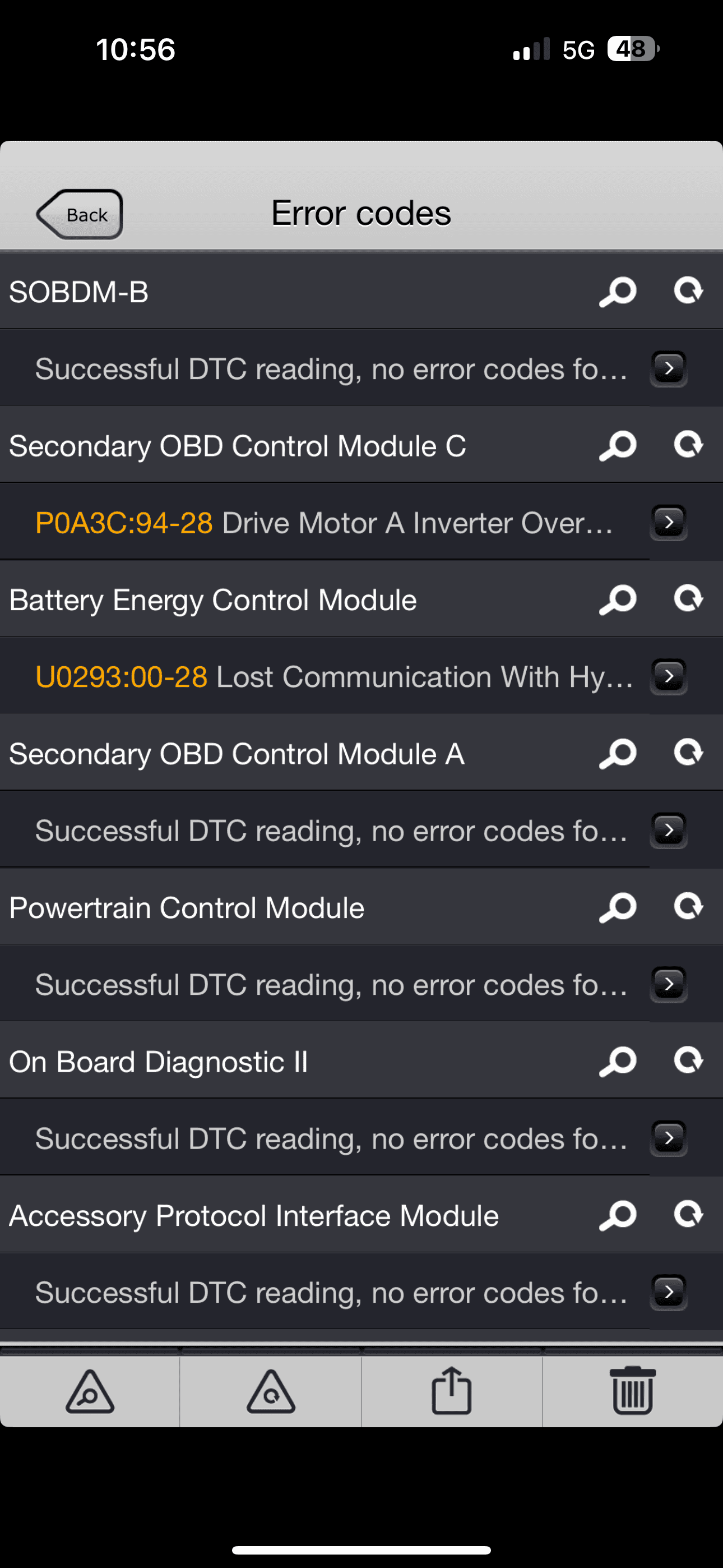

Plugged in my scanner, got no errors at all. So hooked up forscan and did pick up some errors, will attach screenshots.

Known bug, happens only at startup where it is not feasible to be over temp as it has been sitting. Don't bother taking to the dealer, they can't do anything. The fix is already in the code for an upcoming update
