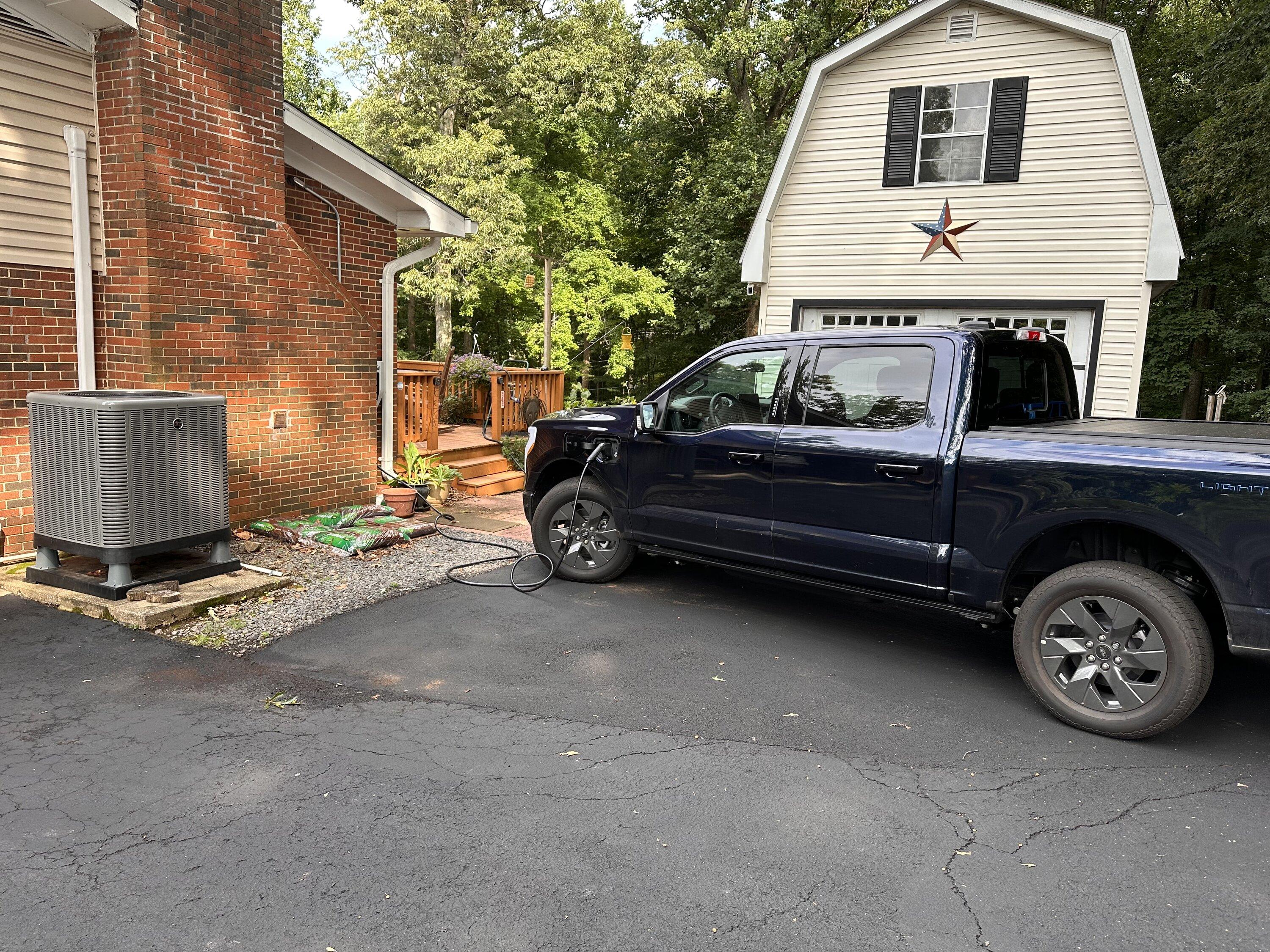

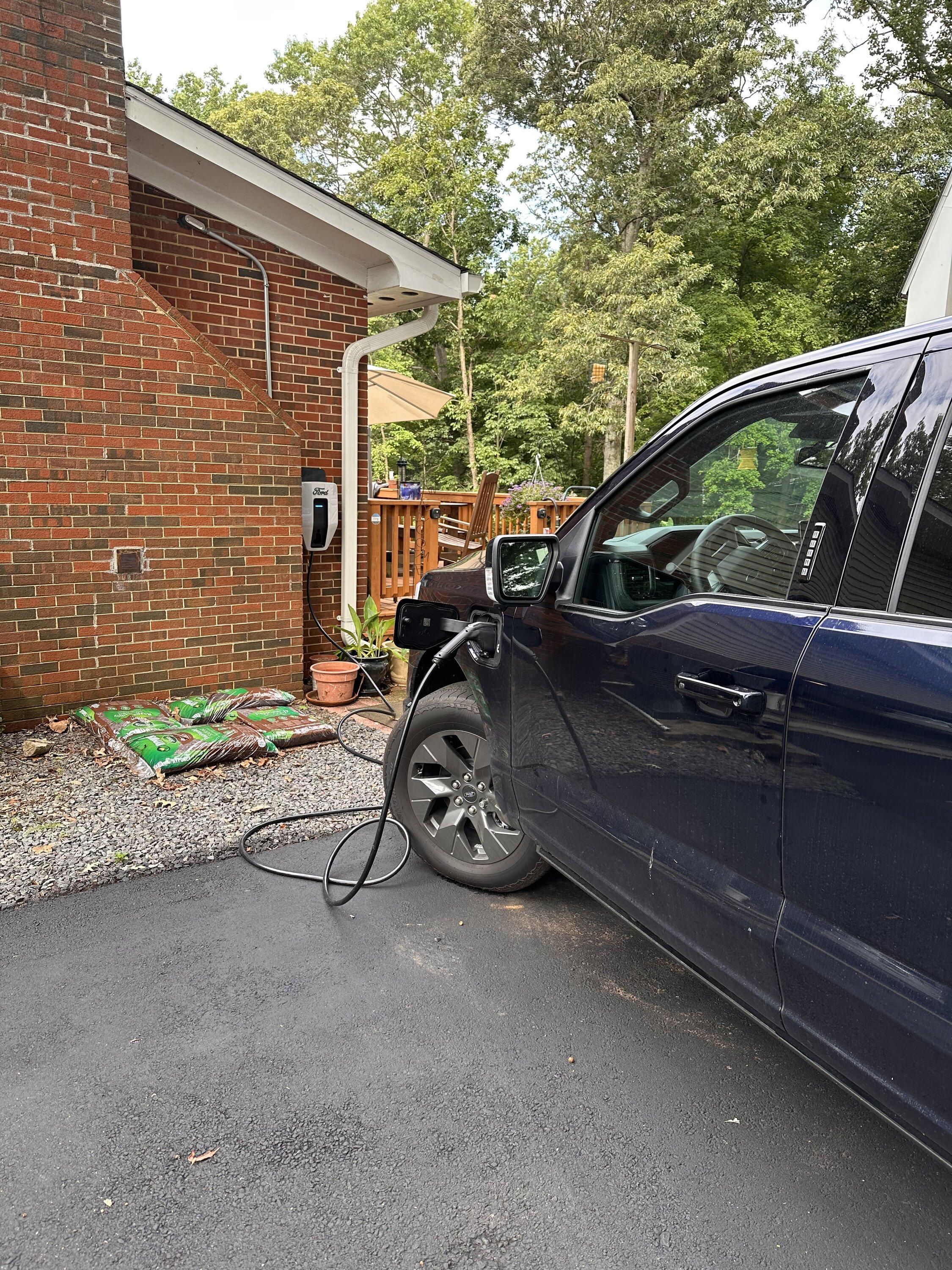

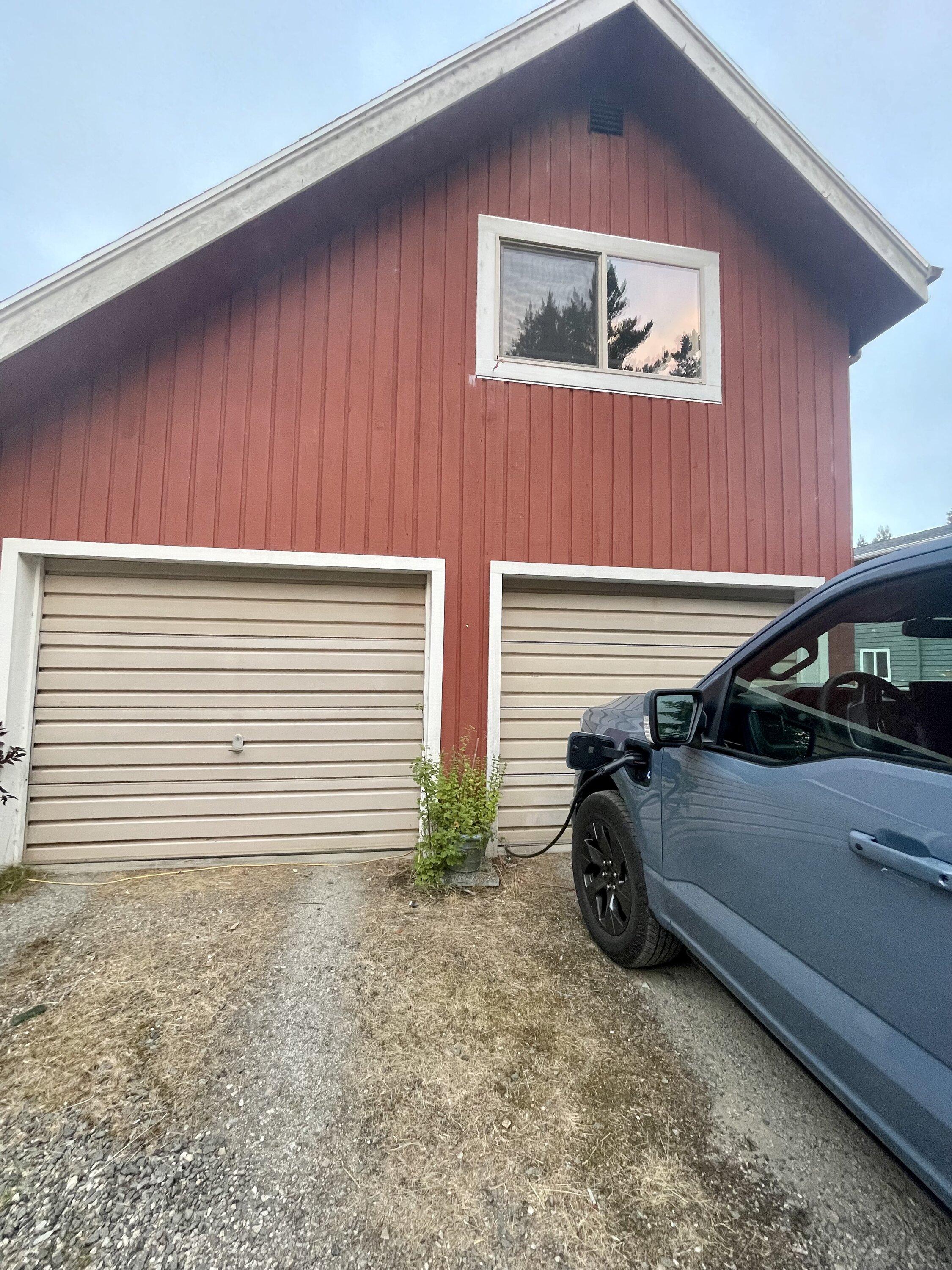

I have the same situation here - Garage is for my wife’s Explorer and I have my vehicles in the driveway. I have the charger on the outside of the house - it is rated for outdoor service - and I have about 15’ run but the cord may got 20’. I recommend not to stretch it.
Ford F-150 Lightning New guy- just ordered today.  Charge Station info needed-driveway charging? IMG_2126
Ford F-150 Lightning New guy- just ordered today.  Charge Station info needed-driveway charging? IMG_2125

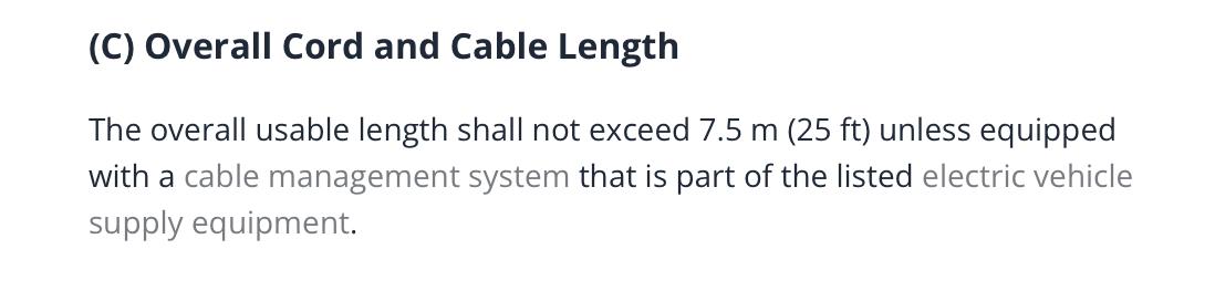

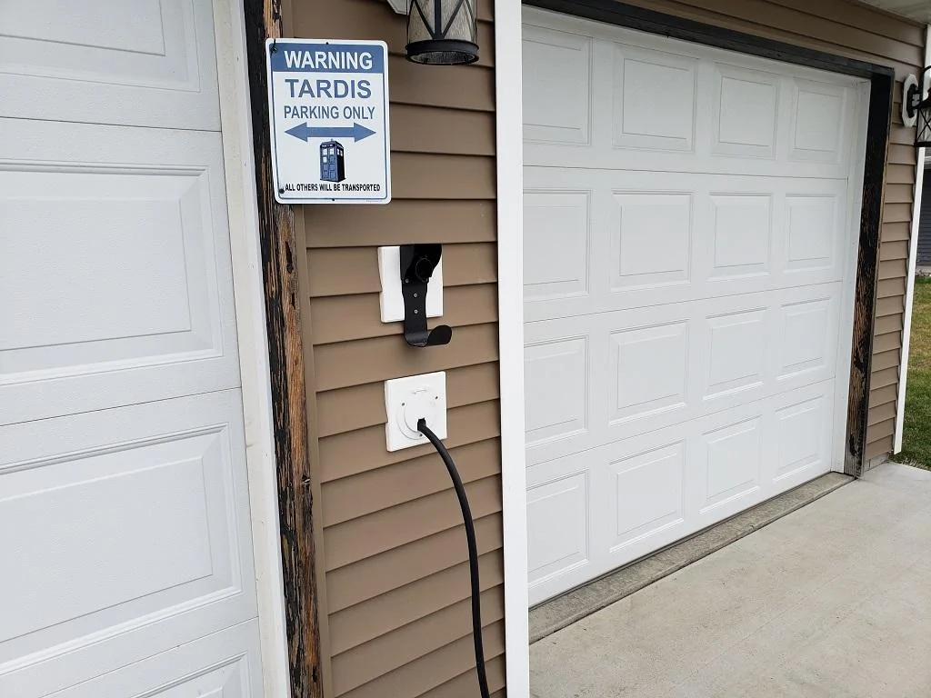

From the NEC….
Ford F-150 Lightning New guy- just ordered today.  Charge Station info needed-driveway charging? IMG_0578
If you see any EVSE with a cable longer than 25’, make sure it’s UL listed.

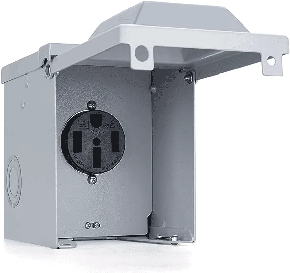

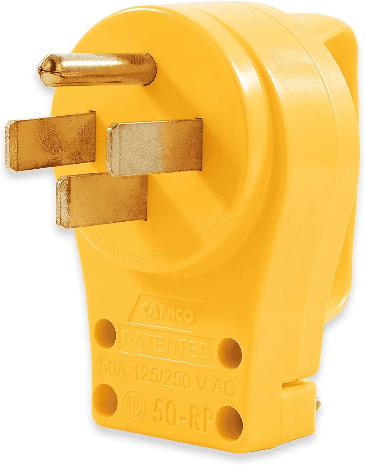

If anyone is curious, the nice little cover in the above post is an RV port cover. I have used several to set up things where I would rather have the actual plug on the inside, yet the option to pull things outside too.
Amazon RV Port cover
Thanks for the tip- that's exactly what I ordered. I needed to educate myself with some youtube on how to drill a 3 5/8" hole saw through cinder block- but in the end it's absolutely perfect, and functions properly. I needed to cut the back end off the two RV port covers (impossible to tell once installed) so the charging plug could slide through, but man these just make the install nice and clean.
