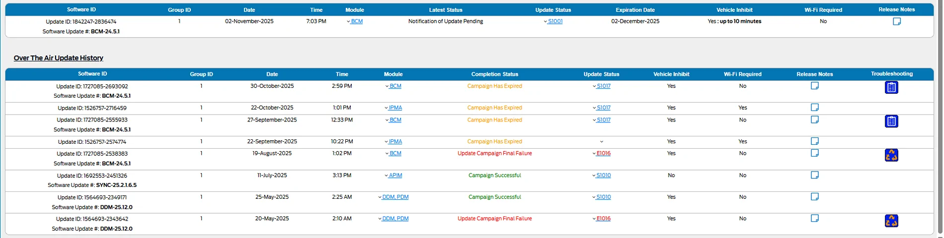

@Vegas Got your message. OTA hsitory for your truck is below. BCM OTA trigger was resent to you yesterday....right now it is sitting in the queue waiting for your truck to ping the server back to accept it.
If you look further down your OTA history, you have had several updates sent to you which have failed for various reasons. In some cases, it was due to the 12v battery being to low, and in othter cases, it was due to the truck just not pinging the server back to accept it. In the case of the failed BCM attempt in July, the error messages states the OTA packet was missing certain config in a

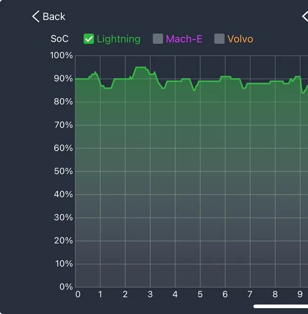

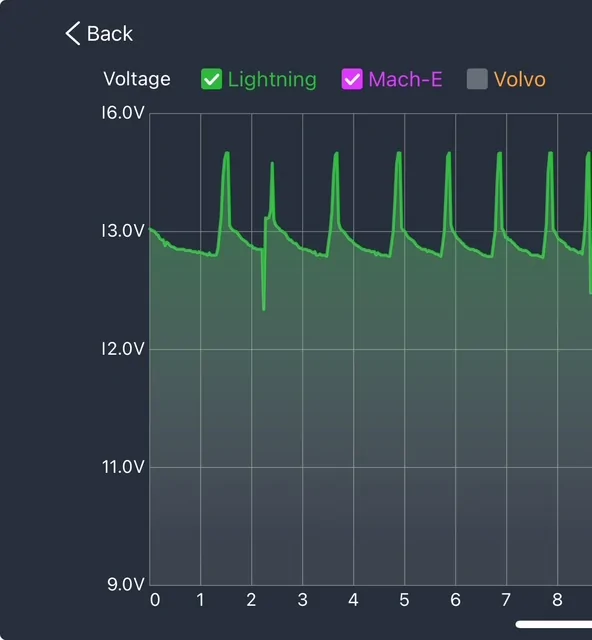

You are correct that it does need to charge to 100%, however, it doesn't hold it there like with a flooded battery. The modern chargers allow them to discharge a small amount and then top them back up so they aren't holding them on the high voltage for long periods of time like they do with the flooded batteries.
The first chart is the voltage at the battery with the NOCO attached - you can see it goes into charge mode about once per hour to top up to 100%. The second chart is an estimated SOC (accuracy isn't perfect on SOC since it is based only on voltage, so take it with a grain of salt but it is holding it between 85%-95% give or take a few percent). You can see the pattern that keeps the charger from burning the glass mats. Older AGM chargers held the float value above 13 volts, which shortened the life of the AGM batteries. The modern pulse charging that my NOCO does is safer.
Yes, I think that's where the confusion about what 100% charged is for an AGM.
A 12V AGM should be charged to a voltage of between 14 and 15 volts more or less, but then maintained at a lower voltage around 13.5 volts, the float voltage keeps it "full" without overcharging.
The 100% voltage is the 13.5 volts for an AGM, in my opinion anyway, and 100% "full" is where all lead acid battery are optimized for long life.
Note the exact voltages may differ between manufacturers these are 'ball park figures.'
The float voltage (full) is close to 90% of the charging voltage, which may be where the misunderstanding lay?
