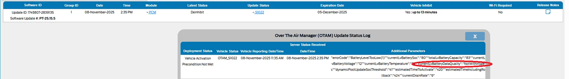

OTA's depend on the state of the LVB to install. The algorithm takes into account, SoC, capcaity, voltage, temperature, BMS data quality, estimated install time and if the calculation is below spec, the update will not attempt to install.
The case below is from an ICE F150 who upgraded his 12v to an H8 to allow for a higher capacity. SoC and capacity are high, but the BMS data quality is questionable, so the OTA is failing.
Ford F-150 Lightning Original owner of 22 lariat need help please Untitled
