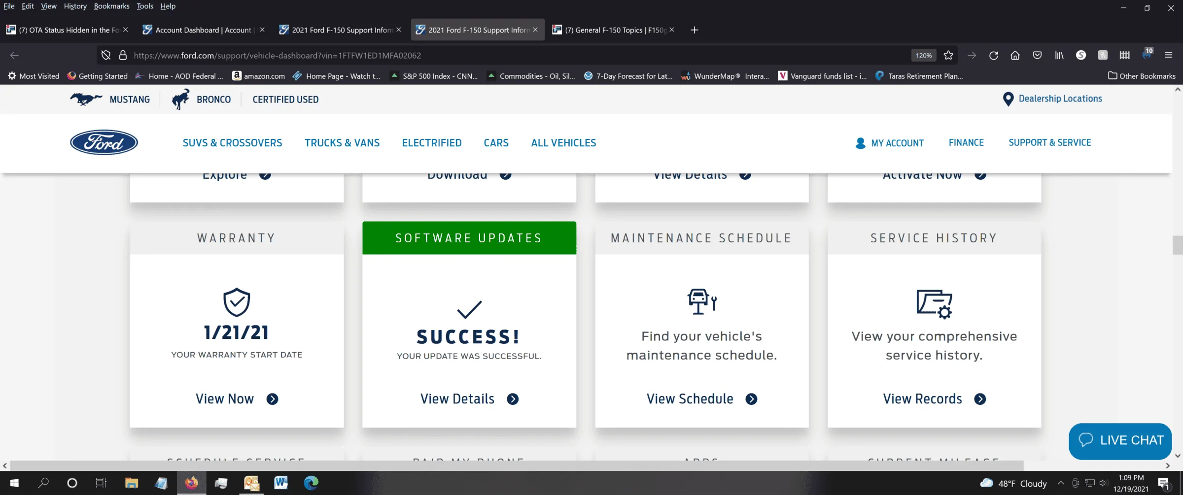

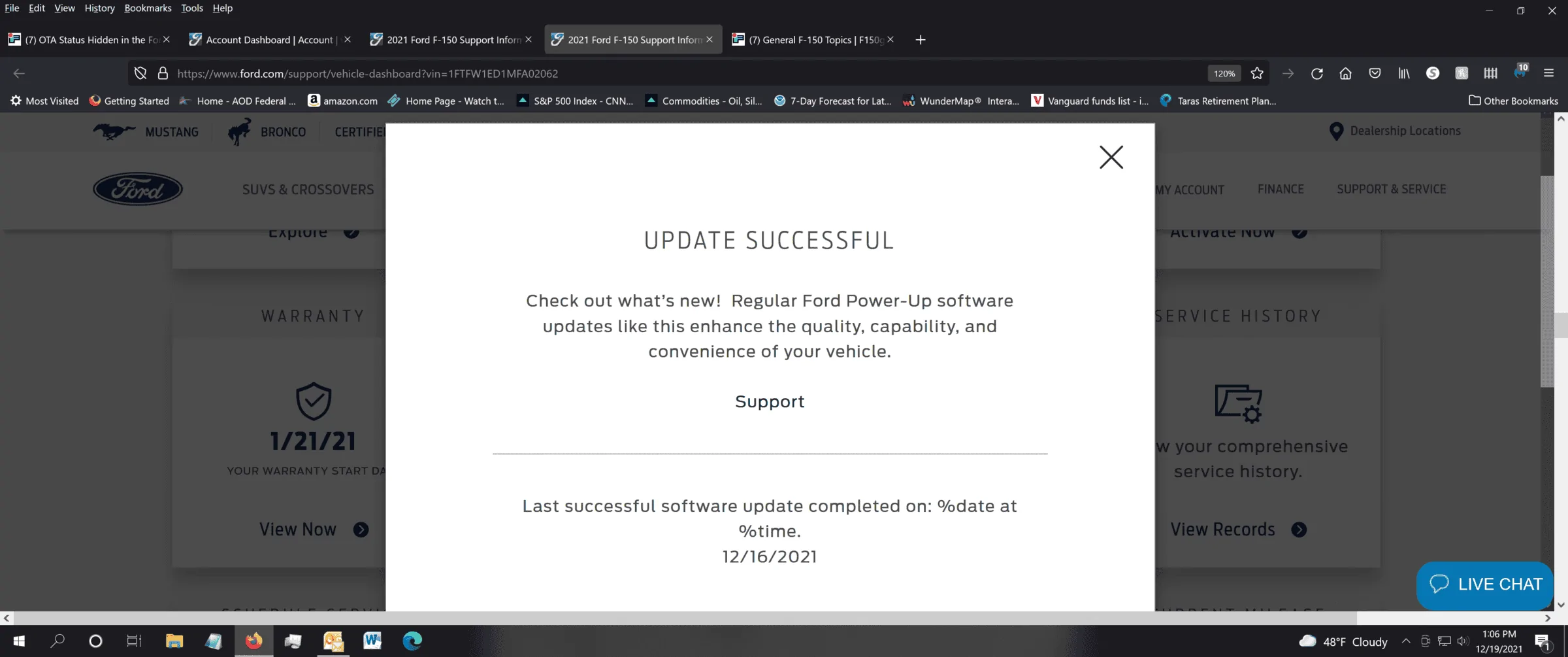

Shows an update occurred on the 16th of Dec for mine.
This is what shows up under my Ford account below, Ford Pass just says update successful, no description though.
Ford F-150 Lightning OTA Status Hidden in the Ford Website 1639943602523
Ford F-150 Lightning OTA Status Hidden in the Ford Website 1639943634239

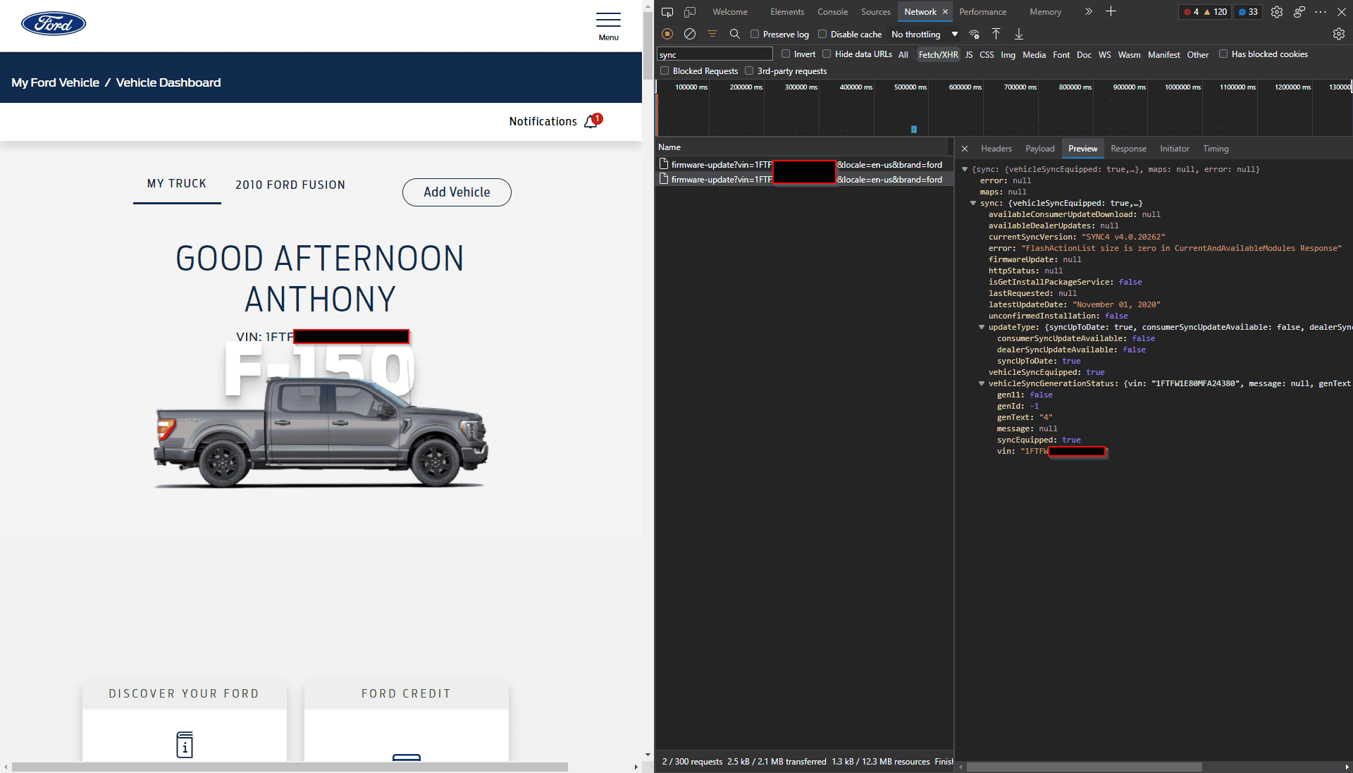

I found some interesting data in the ford site related to OTA updates.
If you browse to https://www.ford.com/support/vehicle-dashboard/?gnav=header-account and open up your browsers web inspector (right-click on the page select inspect)
You might need to refresh after the inspector is open.
Select the Network Tab and enter "ota" in the search box...
Select the name "/status?country=usa&vin=YOUR_VIN" and click on the preview tab.
It will be interesting to see how accurate this info is :)
Thanks to @Eric_C_Boston for his findings
https://www.macheforum.com/site/threads/ota-status-hidden-in-the-ford-website.12367/post-302199

If you look at release notes URL under inspect I found this.
FordPower-Up 1.7.1\n\nNavigation, other enhancements\n\nNavigation will automatically make helpful destination suggestions (but you can turn that off if you like), plus new cloud connectivity combines conversational voice command recognition with internet-based search, so you get the latest info with almost every request.\n\nApple CarPlay® compatibility will display on-screen turn-by-turn navigation in your instrument cluster.\n\nThe user-profile icons on your SiriusXM® with 360L radio are a bit bigger, and there were a couple of bug fixes.\n\nOngoing updates like these help ensure that you’re always driving the best possible version of your F-150. Keep in mind that update availability varies by model.
