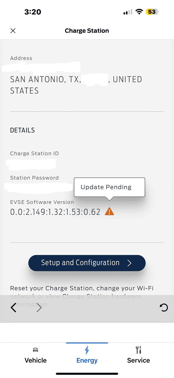

Have they EVER sent out an update to the FCSP software?
I've been distracted by other stuff. I'm a 78-year-old hearing aid (HA) wearer, and Phonak just issued a new, very powerful hearing aid, the Audeo Sphere, with active noise cancellation by a built-in neural network. Nothing like it before. Should make its way into earbuds. And it will be pricey in HAs!
In the fall of 2023, there were firmware updates to the FCSP and the Delta inverter in the Home Integration System (a.k.a. "Whole Home Backup): https://www.f150lightningforum.com/...backup-power-without-sunrun.12564/post-374937.
As of June 2, 2024, both the FCSP and the inverter still had the same firmware in my home system.
But I just checked this AM to reply to your post and found the following! :clap:
Ford F-150 Lightning Ford Motor Company has the MOST sophisticated OTA update system...??? IMG_1035_Edt
The FCSP firmware still has the number shown here in the Ford Charge Station Pro Setup app, too, with no indication of a firmware update (the last 1.3:0.62 number sequence is inverted in the CSP app). The inverter firmware in M Professional is unchanged, and there is no indication of an update pending.
IIRC, @TaxmanHog may have said in the past when it says "Update Pending" for FCSP firmware, the actual update to the firmware in the FCSP may have already occurred but just not registered yet in FordPass (I could have a faulty memory on this).
Strange things were happening tonight, though, with my FCSP before I noticed this pending update. As I charged my LVB to >80% SOC to install Priority Update: 23-PU0110-RAD-PS by running my truck plugged into my FCSP in full-accessory mode, I noticed there was no light at all on the truck port, and the FCSP light was just a solid blue. Normally, both LEDs would flash blue while the current runs from the FCSP to charge the LVB with the truck in full-accessory mode. The ECU voltage was about 14.45, the 12V voltage was about 14.35, and the LVB SOC rose from about 73% to 82% over several hours. The dash also showed an illuminated power cord on the lower right side of the screen. I'm not sure where the current to charge the battery was coming from. The car scanner showed 1A on the HVB battery widget but 0V A and 0V on the charger.
Charging of the HVB to 50% SOC was scheduled for 1 AM, 8/11. Nothing happened - no LED light action at the truck port or on the FCSP LED. I unplugged and replugged the charger head a time or two. The truck port LED turned white, and the blue FCSP LED went out. I unplugged and replugged the FCSP charger head another time or two, and finally, both the truck port and FCSP LEDs were flashing blue, but Car Scanner indicated the FCSP was charging at 80 amps, whereas, for several charging sessions over several weeks, it had been charging at about 24A. So, the first time I've ever managed to immediately change the charging rate on the fly, I changed the Max Current Requested to 48A. The power rate immediately dropped to about 10.7 kW, and the FCSP LED changed from solid blue to flashing blue with a short flashing orange right end. And the truck, as scheduled, did stop charging at 50% HVB SOC.
Until I went out just now to check again how the truck and FCSP would behave in full-accessory mode. I turned the truck on, and now both the truck port and the FCSP had flashing LEDs as current was drawn. But even though the truck was at 50% HVB SOC, FordPass announced the HVB was being charged to 100% (?:crackup:). The FP STOP button terminated that nonsense. And, unlike earlier in the night, the truck now charged the LVB in full-accessory mode with both truck and FCSP LEDs flashing as they should when AC current is being drawn from the wall.
So, I don't know what to make of this mess except an update is pending or may have occurred for my FCSP. Ford FCSP is as or more erratic than ever - but then a starry-eyed optimistic view would be the Priority Update: 23-PU0110-RAD-PS earlier in the evening just made things weird for a while.
As far as when there will be any truck update to improve the FCSP interaction/reliability, the last thing I heard was from Mike G i n the following post: https://www.f150lightningforum.com/...-fdrs-temporarily-suspended.19409/post-400475.
There may have been more recent update news that I've missed since I've been off learning about the new Phonak HA.

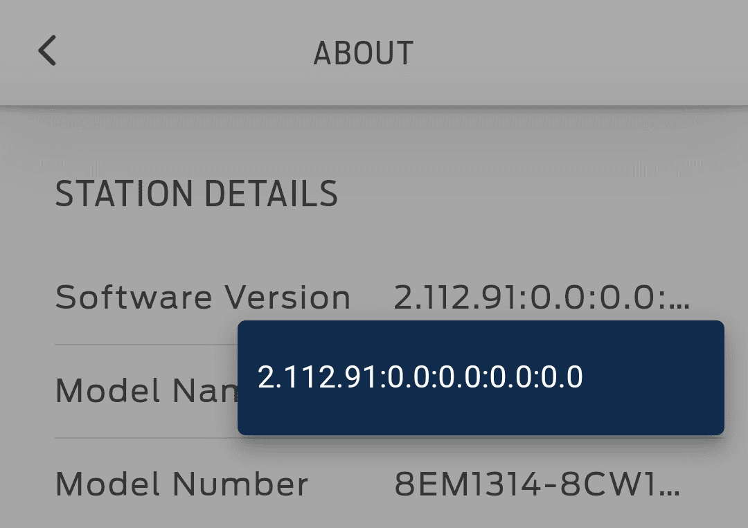

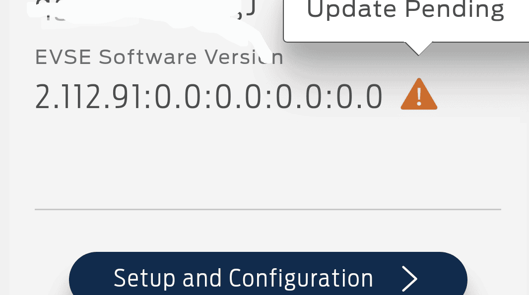

This seems to be the trend, I am showing a flag for an update as well, but mine has been stuck in no-mans land (trailing zeros ) for many months.

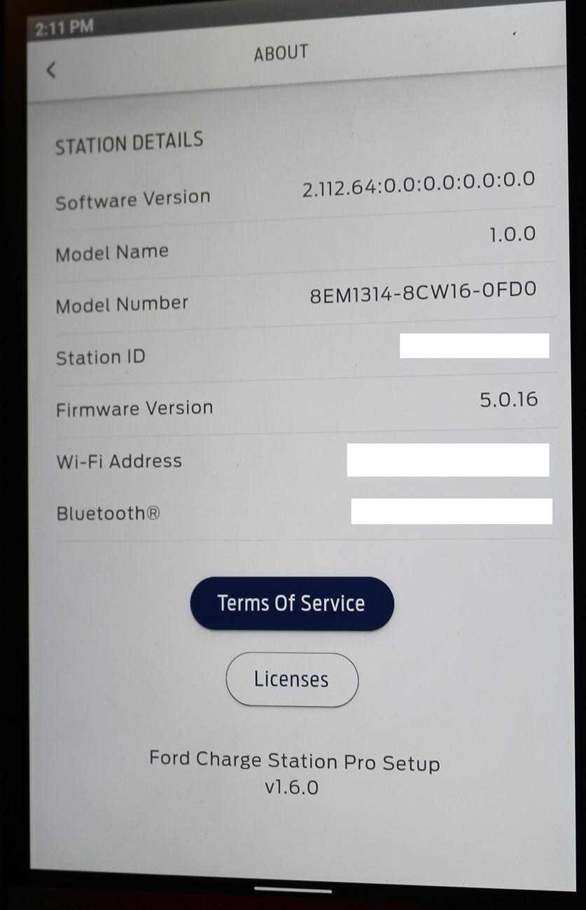

My Software version: 2.112.64:0.0:0.0:0.0:0.0
So it seems I am not the latest version either - but no updates pending for me.
Ford F-150 Lightning Ford Motor Company has the MOST sophisticated OTA update system...??? Software version-2-no update pending
Oh well...
How does it do the updates? Wifi?
I see no way to force an update to happen...
I have never been able to add the FCSP to FordPass although it is "Paired and Connected" it won't "CONNECT TO FORDPASS" with the "ADD YOUR STATION IN FORDPASS" and when I try I get "ChargePoint Not Found" error.
Oh well...
My FCSP set up app screen is similar, without a pending update flag as well.
Ford F-150 Lightning Ford Motor Company has the MOST sophisticated OTA update system...??? 1723407573374-o
My earlier report this morning was from the Fordpass app view point, which you're having trouble binding the systems together.
Update arrive at the FCSP via it's wifi connection to your home router, as it talks to either Siemens or Ford hosts.
When a pending update is showing, the following morning power off the unit for a few minutes, then power it back on {via the 100 amp breaker}, the update will automatically post and implement during the start up process. It may take several minutes to finish and reflect on the next view of the setup status screen(s).
