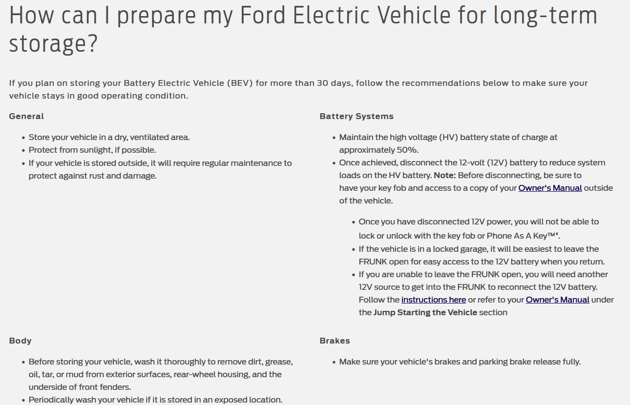

This is what Ford says:
Ford F-150 Lightning Parking truck for 2 months 1701903115439
Ford F-150 Lightning Parking truck for 2 months 1701903164702

You can't go wrong with Maxx's recommendations from Ford - especially if it is deep cold. If you leave it alone as is, the 12V battery will be charged from the HVB and the truck will go into deep sleep (no access from FordPass). It will last months this way with the truck topping up the 12v battery when needed with only a small impact to HVB (deep cold may be different - See Maxx's excerpt from Ford.)
I'd likely put the 12V battery maintainer on it and not worry about disconnecting the 12V battery. This means the truck will work with the key fob, and you won't have to figure out how to jumpstart your frunk to reconnect the battery when you return. Your HVB SOC should stay right where you left it if you do this.
