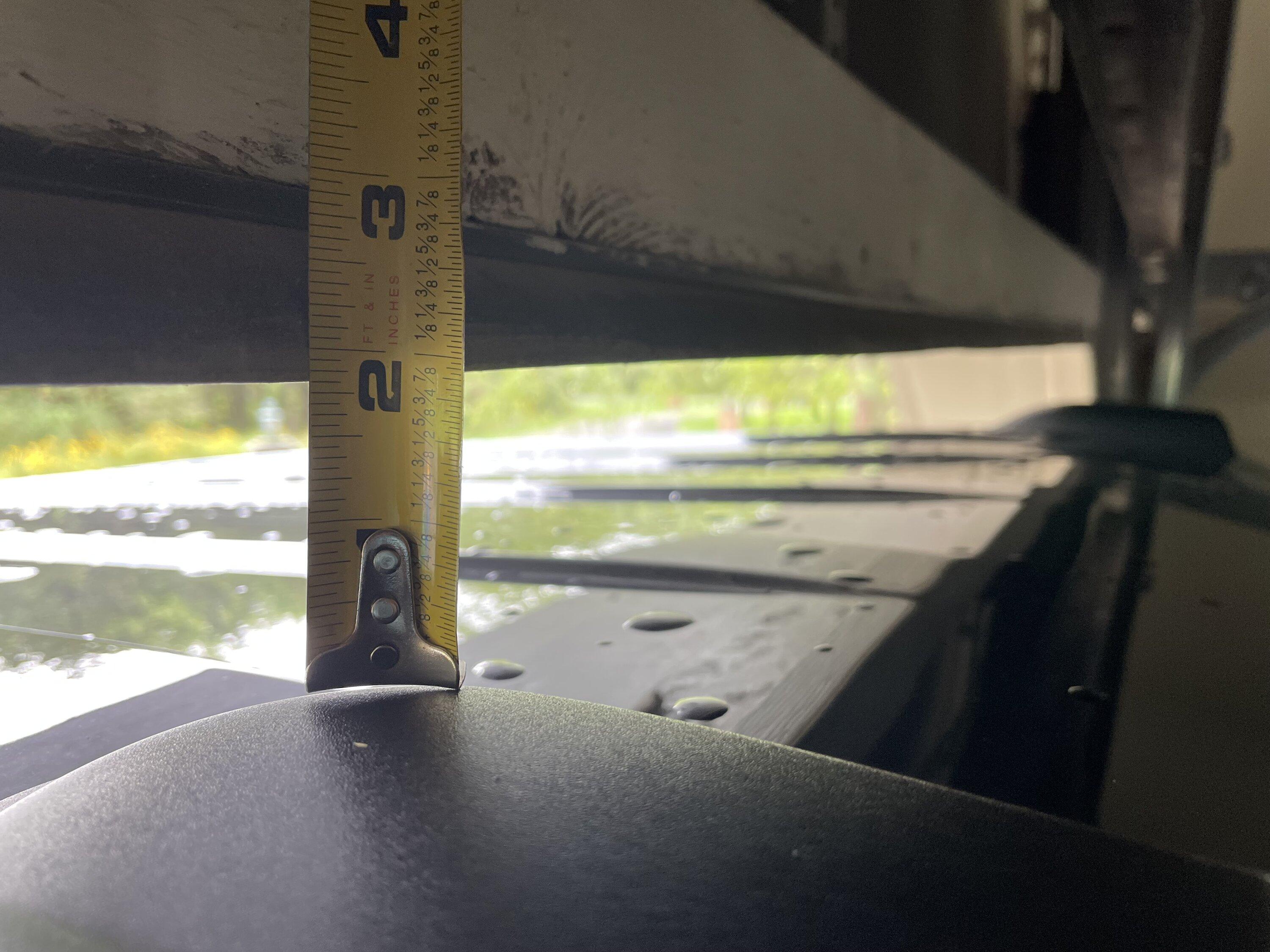

Super helpful.. I don't know why I didn't think to do this in my garage.. as the truck clears there, although I'm at 82" at home. The diff is around 5"... I spoke to the office garage and they are giving me access to another level that has a 6'8" clearance so I'll give that a go.
Yup that’s the easiest way to measure. The black humps are the highest point outside of the antenna.
I don’t hesitate to pull in if I have 6’7” of clearance according to the garage. I don’t usually go under that even though the truck technically fits.
