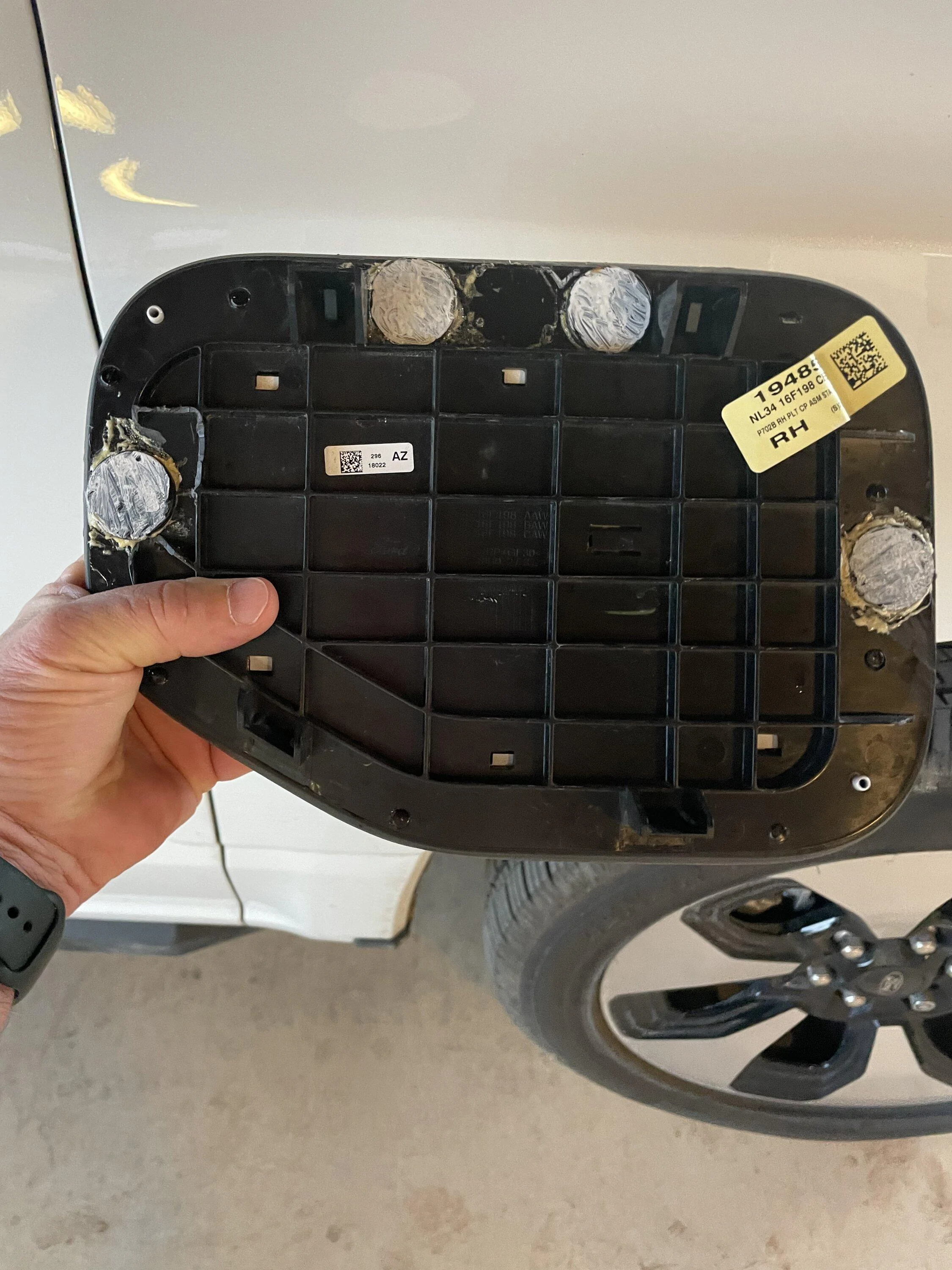

V1.0 is operational. I will take some pictures this weekend. Bought super strong magnets and gorilla glue from Amazon. Glued magnets in 4 places on the cover after grinding down the “catches” on the top two latch guides. I left the bottoms alone to help secure the cover and use gravity as an assist. Glued magnets to backside of 3 fender flanges, top, left and right. The top is extra wide so I spaced 2 magnets as far apart as possible. The top flange is also where the two latches are I ground off the catch parts. Not perfect, I need to recess the cover magnets their thickness and it should be as good as OEM on the fitment and seal. I can attest right now there’s no water leakage, and at max warp speed there’s no problems. (By the way the cover is a $325 part thru the dealer and has to come from Detroit.).
V2.0 will be to use magnets with countersunk holes instead of glue for the fender and countersink the cover magnets.

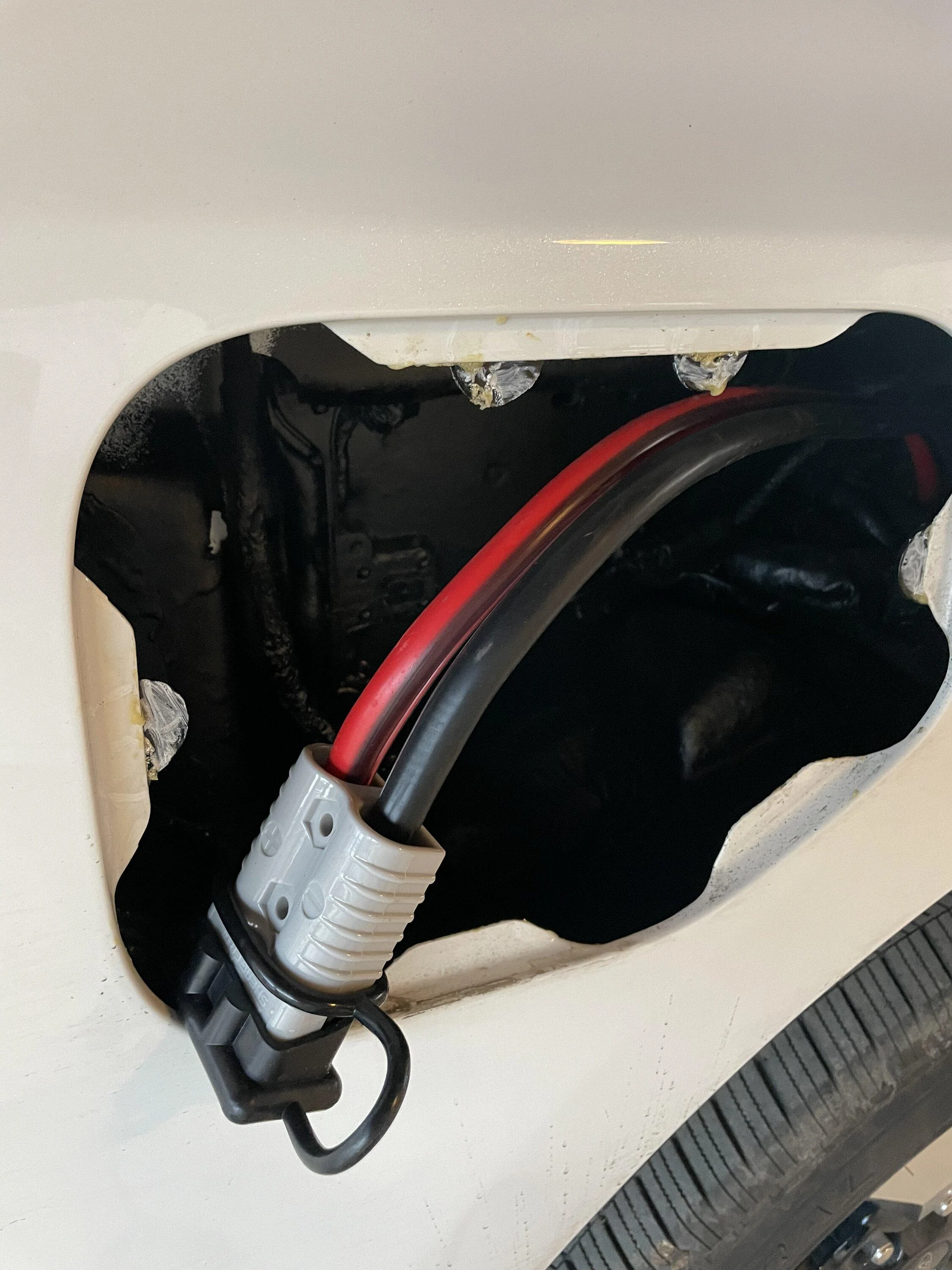

What did I do with the space? Also from Amazon, purchased Energizer 25 foot quick connect jumper cables, 5 foot quick connect with eyes (the 2 are a kit for $99), 1 can of flex seal. I strengthened the wheel well material (I did not think the fiber material could handle any direct weight) with 3 thick coats from inside, 1 can of flex seal, each coat applied 48 hours apart. I’m impressed how good the Flex Seal performed in this use case. I then ran the 5 foot quick connect cable, eyes first, thru the passenger side removed cover opening. Thru a fender gap, in front of the fuse box and over to the 12v battery. 5 feet is perfect, gives about a foot of cable outside of the fender area when connecting to the quick connect on the jumper cables. The 12v terminals have bolt studs already so I backed off the 10mm negative and 11mm positive nuts (I don’t know why they are different, but the nuts are not the same size) and put the factory eye loops from the 5 foot quick connect on the studs, replaced the nuts tucked the 25 foot quick connect with clamps into the fender cavity, put the cover on and now when I kill the 12v, I can still open the frunk to replace the 12v or just jump or charge using the cables I added.

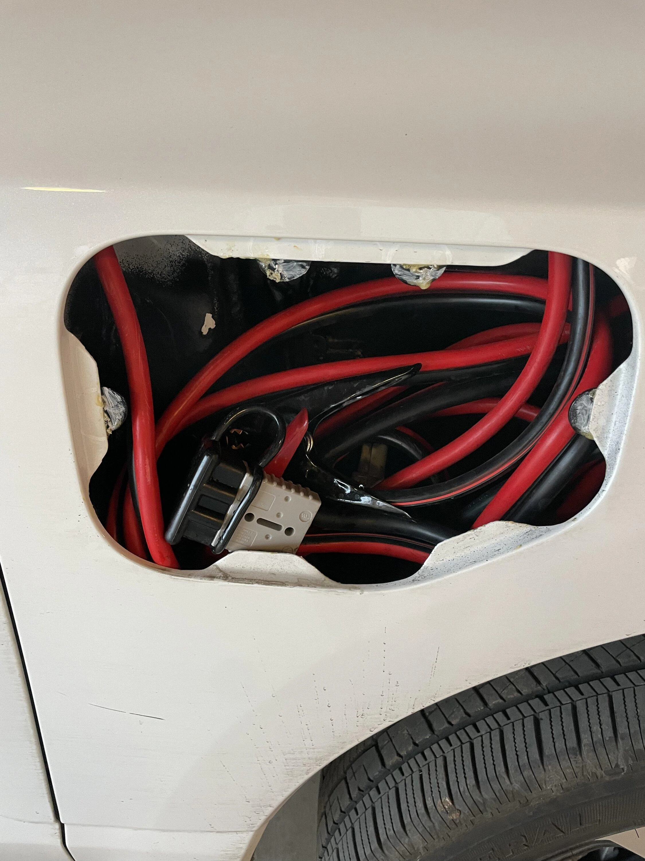

Here are some pictures. I put some white paint on the magnets to help visibility. 7000 miles on the truck, 6k with this setup. Been thru rain and car washes of multiple styles with no issues. See previous posts for specs. I added Amp Powerstep XL’s this weekend and the electric connections at the 12v went right on top of the jumper cable.
