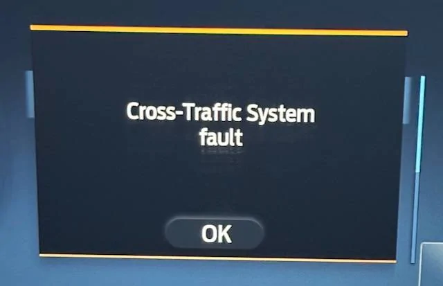

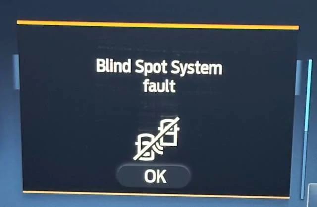

As the thread title says, my passenger side mirror got wacked which resulted in minimal actual damage to all the plastic...but the mirror plate itself was knocked loose and was hanging by various wires after the impact. I checked all the connections (a total of 3 I believe) and snapped the mirror back into place. Unfortunately I am now getting Cross-Traffic System Fault and Blind Spot System Fault each time I drive (screenshots below)

It may well be that there is some component that is broken/damaged and needs replacement. However, it appears my cameras and LED Zone Lights are functioning properly so I assume these systems would work since the camera works.

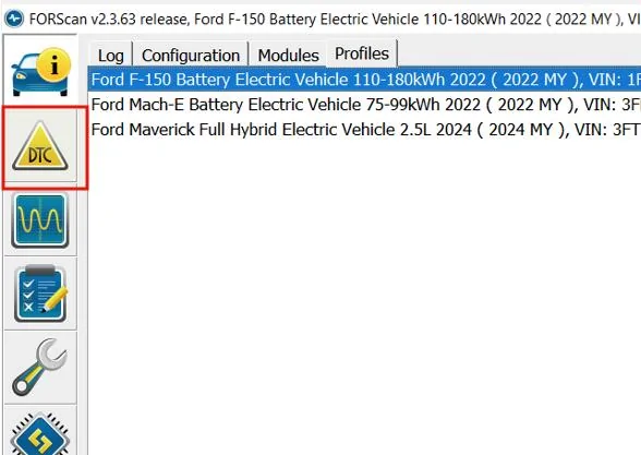

You can read the Diagnostic Trouble Codes (DTC) with FORScan. It will let you know if the DTC is previously set/ not present now or if it is present now. You can also clear them to see if they come back. I would Google the DTC codes it gives you first to see if others have a solution.
You do not need an extended license to read and clear DTC's. Since you said you have a cable I assume you are using the Windows version.

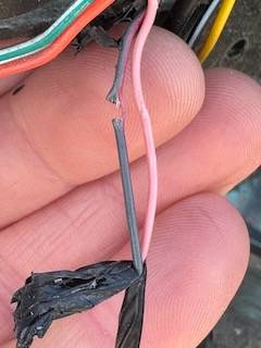

After nearly breaking various plastic parts (I assumed lots of these things were press-fit) I was pleasantly surprised to see 4 screws that hold the entire contraption together; I removed these and found my problem. When the mirror was whacked one of the wires to the LED was severed. Here's a picture:
Ford F-150 Lightning Passenger Side Mirror Impact, now getting Cross-Traffic and Blind Spot System Faults IMG_1935
My fix was to crimp on a connector joining the severed wires. I got everything back together and fired up the Lightning and was greeted by the LED glowing again on the passenger side. I then cleared the old codes and ticked this chore off my list. Yay!
