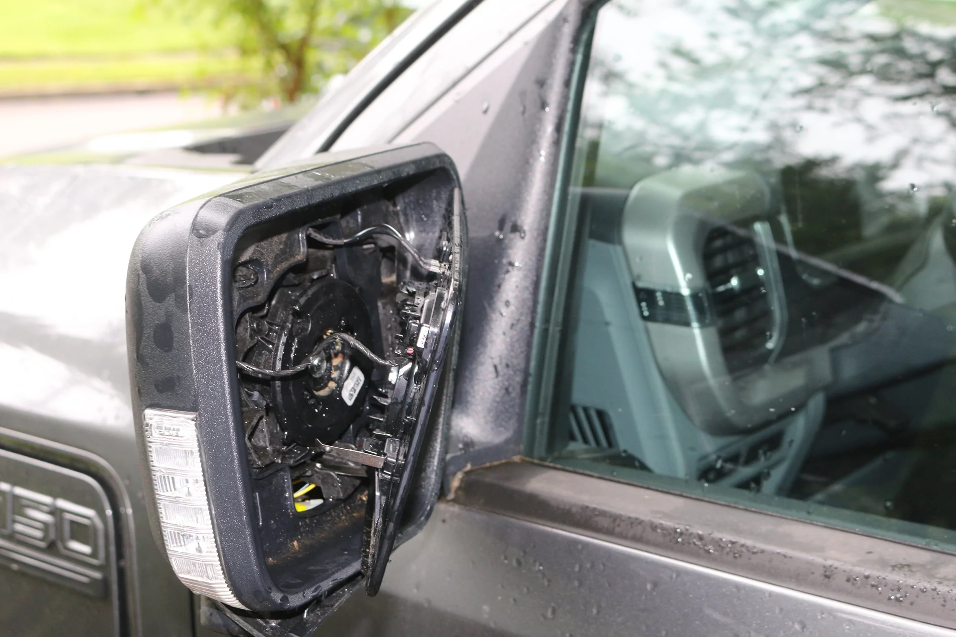

Has anyone replaced the passenger side view mirror with 360° camera and side warning system? I broke mine today backing into my garage. Yes I was stupid, my garage is on a slope and I have to park right next to the wall so the wife's car fits in the garage as well. I was wondering if there was any programming that needed to be done. I read about camera calibration but didn't see anything else about radar.

Yeah it's going to be. I only cracked the outside trim. I could live with it, but I dont think I can without it driving me crazy. I looked online, but Ford doesn't sell that trim piece on the mirror.

There are plenty of manual-folding Lightning mirrors and F150 14th gen manual folding mirrors on EBay. Way cheaper than at the dealership.
The mirror disassembles like a big Lego set. All the mirror trim is disassemblable (is this a word? haha) with care and basic tools, and interchangeable... as are the guts. If Your mirror cap is painted and not cracked, You can reuse it on the new mirror. If You buy a cheap low end version, You can transplant the advanced guts of Your mirror (including any needed wiring) into the cheap mirror's shell. I suggest You buy a cheap appropriate mirror, put on some calming music and just go carefully.
See the Auto Folding Mirror thread on this forum for some ideas.
Good luck!

Thanks. I found a YouTube video on how to replace the trim and ordered my cheap replacement on ebay this morning for $100. Better than 1100.00.
47
3,096
4,428
FYI, to answer your first post, the blind spot radar sensor is in the tail light. Your mirror just has the indicator light. So no BLIS calibration.

If you would just be a little patient you can find a replacement on eBay, it just takes time. I just got a fully loaded mirror with the correct paint trim pretty much mint condition for $450 shipped. It took about 3-4 months of looking a couple times a week to find it.
It took 10 minutes to replace and I didnt have to play legos.
it was pretty annoying looking at a cracked mirror everyday but my patience paid off in the end.
