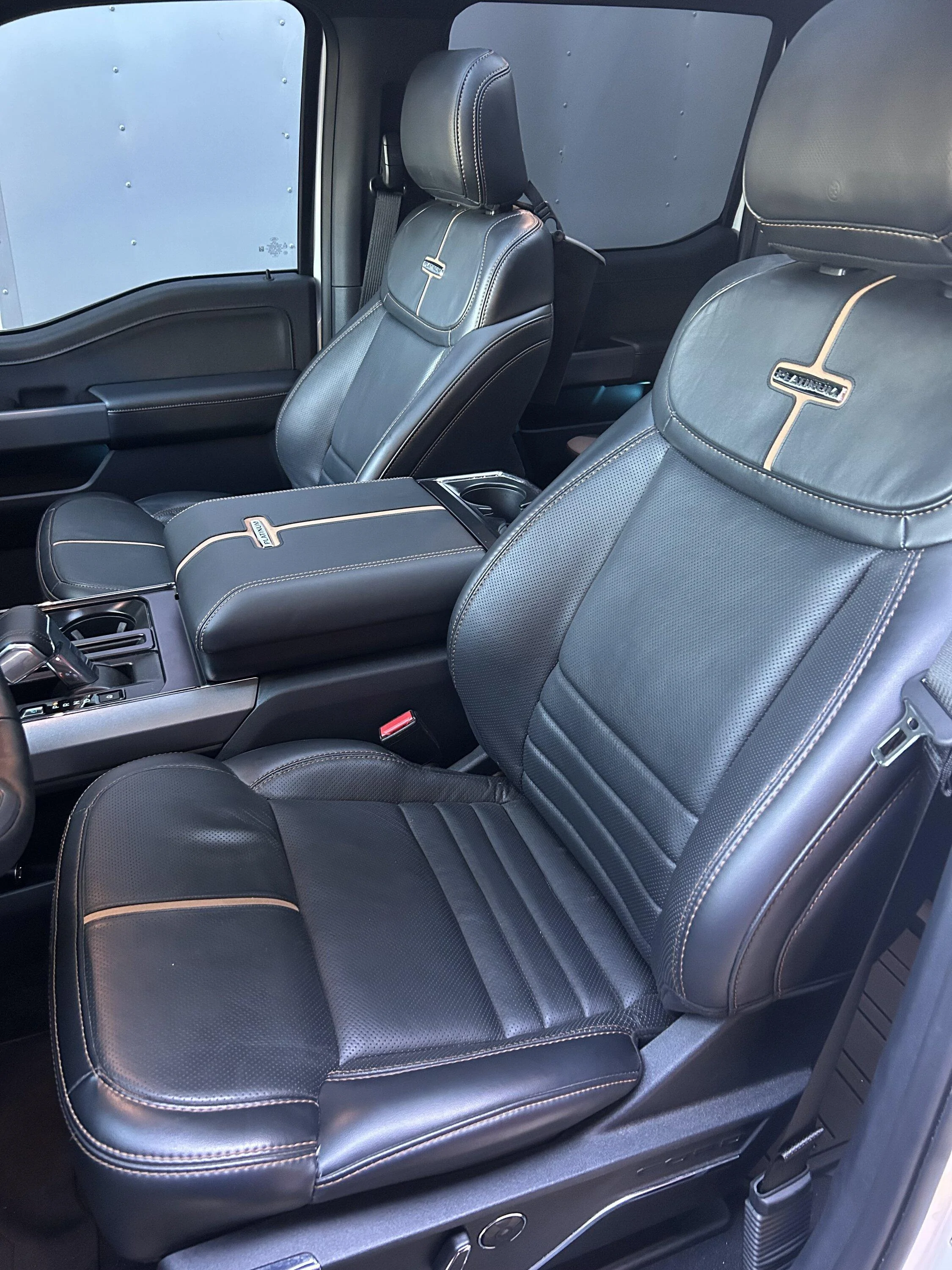

I found a full set of like new 2023 Platinum seats. I installed the fronts today. Super easy. Four bolts per seat and a few wire harnesses. I love them!
The good- Super easy install, adjustments, memory, heat, and cool all function correctly. Super comfortable and look awesome.
The bad- Lumbar and massage not working, SRS light on, obviously headrest speakers not functioning
I’m hoping I can work in all of the lumbar and massage to work through Forscan. If not and it takes some wiring and pinning I’m up for that too. I haven’t don’t the backs yet. My full set of like new Lariat black/ gray leather seats will be posted for sale soon.
I’m open to any recommendations on the issues I need to work on.

To clarify they are from an ICE platinum?

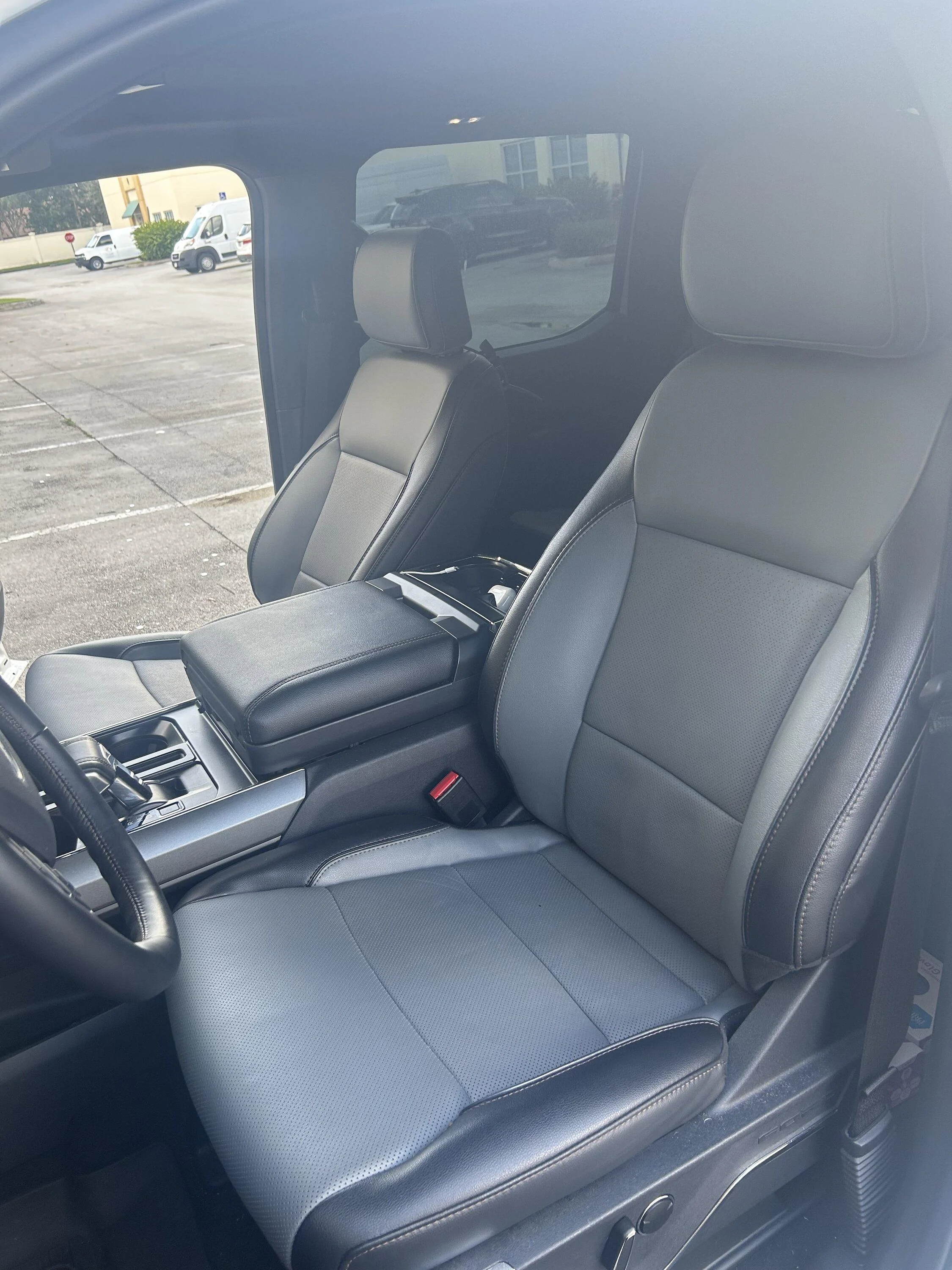

Did you sell your Lariat seats?
Not yet. Just haven’t had the time to list them. I’m asking $2000 picked up. Shipping at buyers cost. I’m located about 20 mins west of Fort Lauderdale. Let me know if you’re interested. They are in like new condition. Removed at 7k miles. Includes all seats and center console work station cover.
