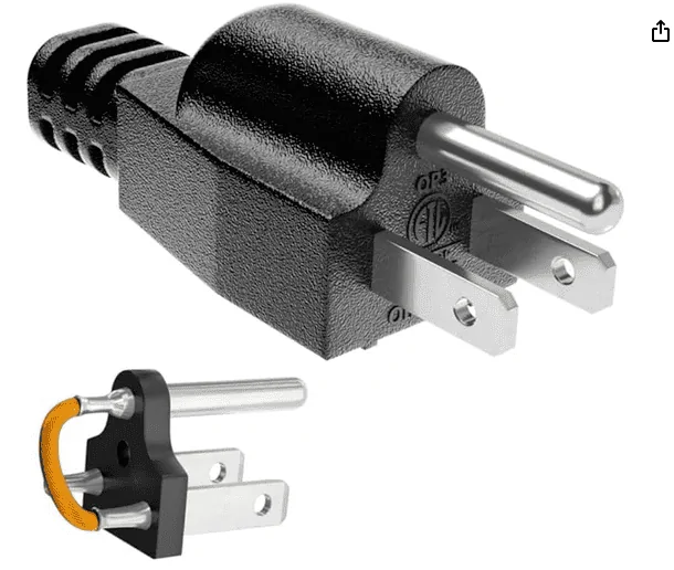

^^^ Just plug this doodad in the other outlet.

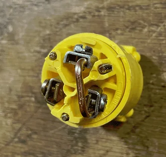

Or make your own with a plug from Lowes/Home Depot.

I just wanted to circle back around and say that I tried this and it worked like a charm. I had the parts and successfully made a neutral to ground plug the same day. Thank you all!
In the end, I could charge at 12amps from a 20 amp generator with my J+ Booster 2. It would have taken forever to charge, but it did give me a little peace of mind, though I never needed to use it.
