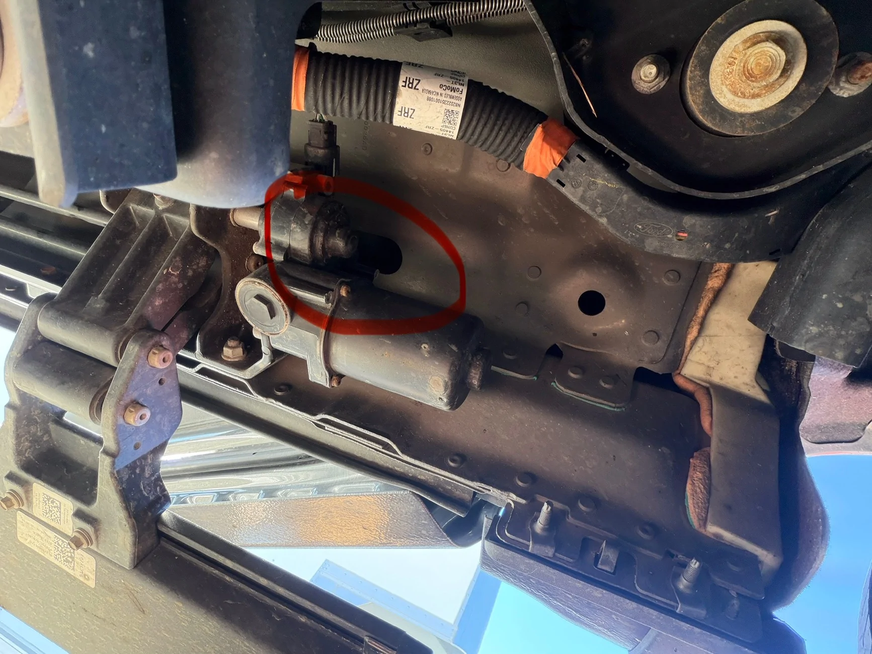

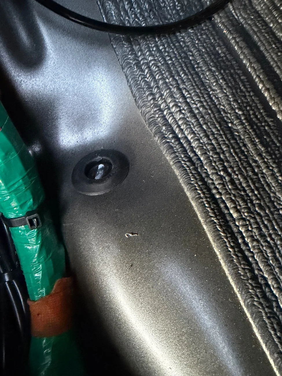

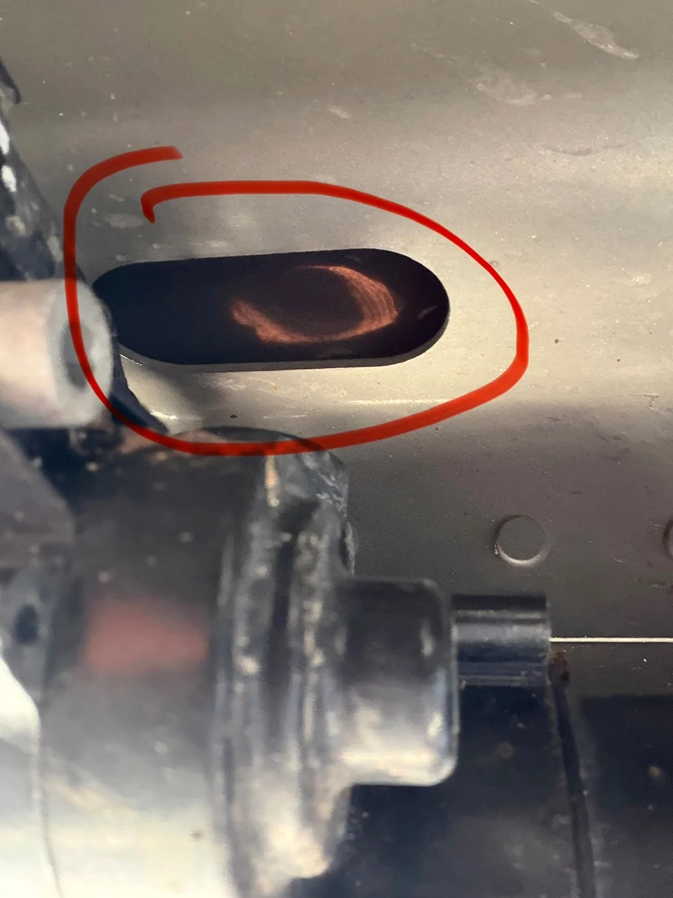

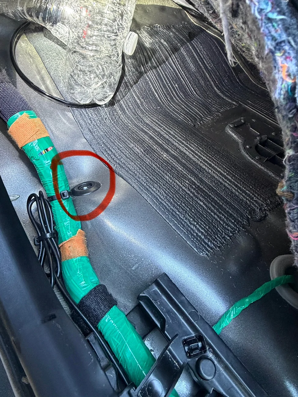

Ok guys looking for a favor. I have a leak that has developed in the last couple months. It’s in the driver footwell area. Seems to be coming from the floor up. I’ve checked some of the under carpet insulation and it’s wet on bottom but just a few inches going up the firewall it’s dry as a bone. I checked my sunroof drains and they are wide open with no leaks. Also checked the windshield with lots of water also dry. As I kept trying to investigate the source I noticed a small black grommet (pictured below) that had some witness marks of a little bit of water and small amour of road dirt that matches what’s on the body directly below this grommet. I got under truck and I’ve circled the larger rectangle hole that’s just above the step motor. What my favor I’m asking is could a couple guys maybe with a newer truck (mine is 23 lariat) and or same year if possible look under there and take a pic of the hole I have circled to see if there is supposed to be a grommet or seal on that large rectangle hole or not. After thinking back the truck sat here in LA over Xmas and there was torrential rain for days and this area was by all accounts pretty dry. But I drove the truck on the last day of rain on Sunday and I really think this hole that is right behind the driver front tire is allowing water to spray in while on highway and it’s coming up thru the black round grommet. I’m going to seal it with some silicone but I’d like to cover that other hole if it is supposed to have one. Had my truck for over a year and had always been dry so something changed. Thanks.

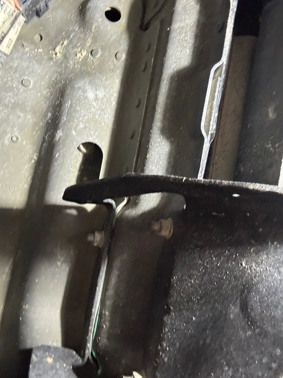

That hole is open on my 23. I don’t have power running boards.
Thank you for the quick response. Easier to take pic without the power boards. lol. I’m kinda thinking it’s supposed to be open but the round grommet was kinda loose in the hole. So I think that might be the offender.

I did check the windshield. Used lots of water. The reason I suspect that hole is because the only areas wet are the bottom and the wettest area almost directly above that hole. Anything going up firewall and the piller are completely dry. Plus the witness marks in, under and around that grommet. It’s just very suspect. So right now I’m drying out the carpet and Lysol-ing it to try and knock down the smell somewhat. Then going to silicone the grommet and just have to wait until the next big rain and see. I’m leaving the trim at base of a piller off as well as the little kick plate area so that I can easily pull up the carpet and keep an eye on it. Again it’s a hunch but seems like clues are pointing to it.
