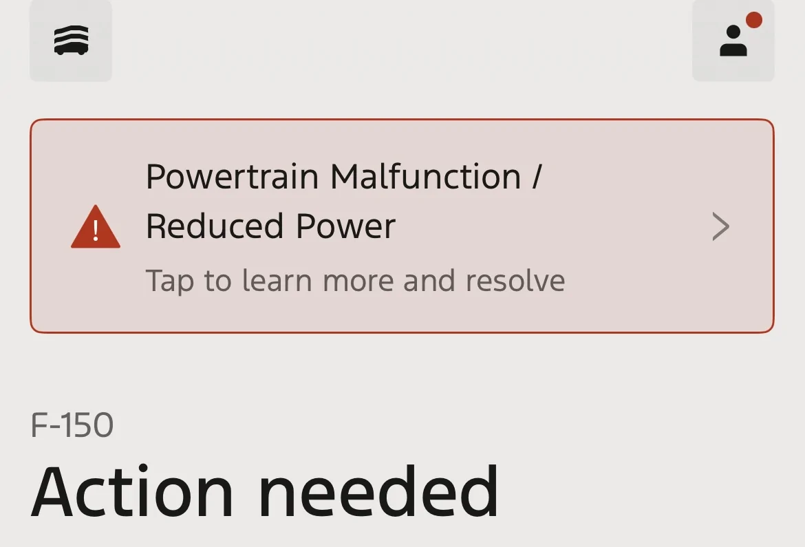

Anyone else receive this? Driving this morning - everything fine - and alert on drivers screen Pull Over Safely and Stop.

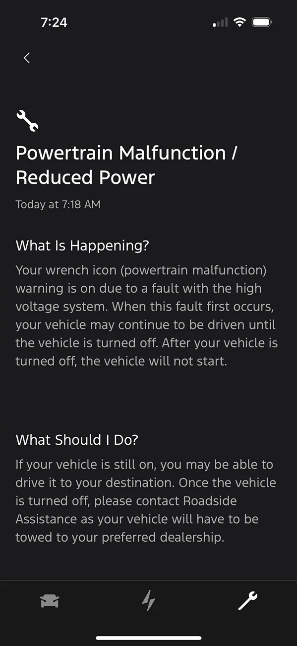

My app says ā€œpower train malfunction. You can drive until you stop vehicle but then won’t start. Contact Ford and have your vehicle towed to facility of your choiceā€
I called a local Ford service and told him. He looked up my VIn and said it’s just a recall / APM software update. He also said I can keep driving and just schedule an appt.
Given the dramatic alert in the truck that seems odd. Anyone else getting this?

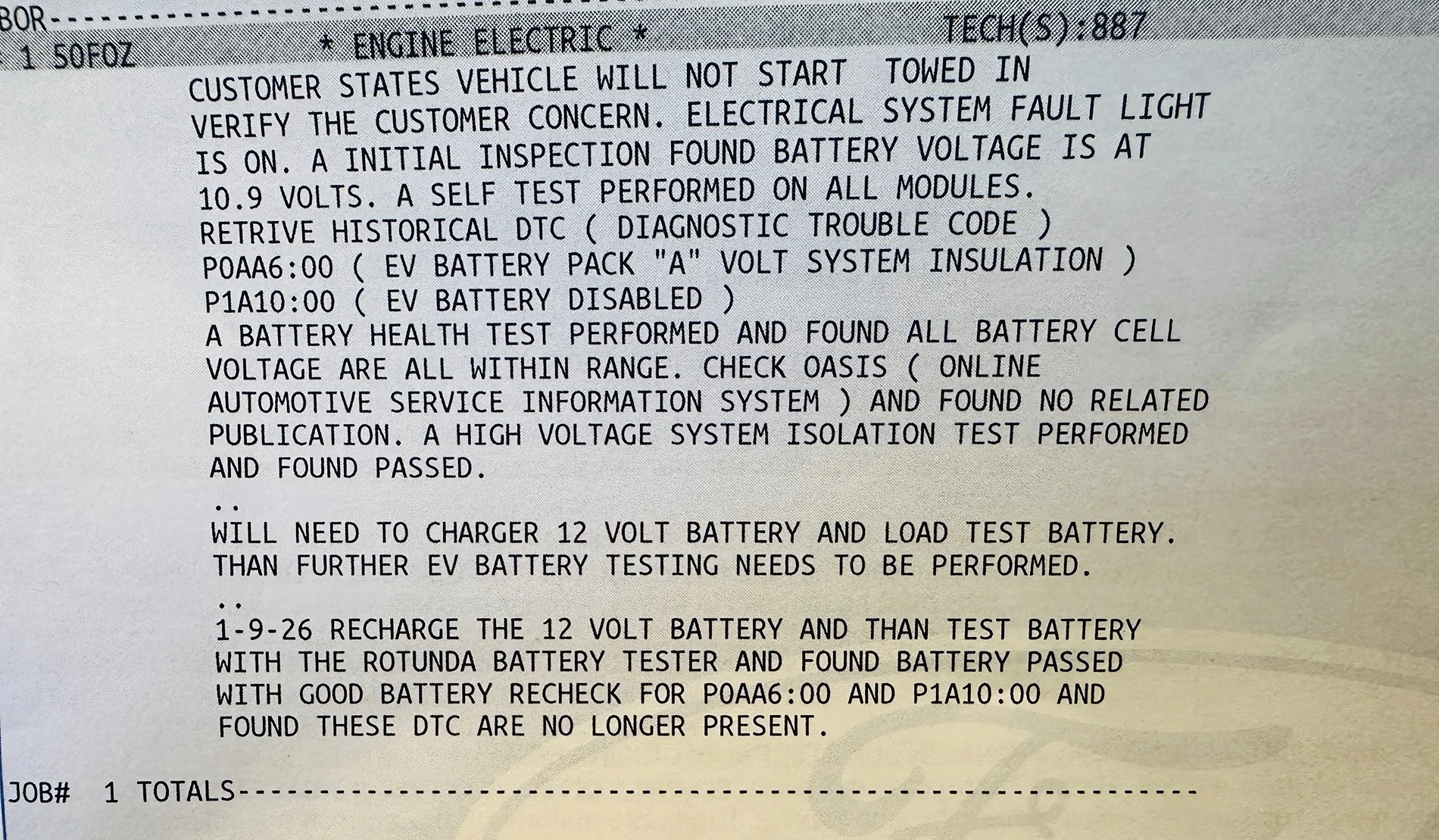

Net result of all this is my truck locked up twice, was towed to two different Ford Dealers (which they paid for - no hassles there). Both service techs said it was a bitch to get truck 12v battery charged up...but finally they got there and all error codes cleared. Both dealerships refused to swap out the battery because they said it held a charge and Ford policy is they will not pay the dealer back.
So - in the end I paid Ford to put in a fresh battery and I kept the other one. I'm also out about $200 for a Lyft the night the truck broke down and a one-way car rental with my family to get them back home.
I drove yesterday 200 miles without incident and this am my display shows 100/100. Ironic that a sophisticated energy system as the Lightning is grounded by the oldest of battery technology.

Just had this happen to me yesterday. I had 3 tows cancel on me and had to leave the truck in a parking lot overnight. A wrecker finally got to it this morning and found the 12V battery completely dead. I had to coach him over the phone on opening the frunk, jumping the battery, and attempting to get the truck in neutral… but no luck. It seems the battery was completely dead and ā€œunjumpableā€. i had the dealership tow it and it was at their site in 30 minutes. The service manager said he would get with me tomorrow. Iā€˜m keeping my fingers crossed for an insignificant 12v issue because this truck has been near perfect since delivery.

Sorry to hear that. What i've found is that it takes a couple of days. They just put it on Battery minder until it comes alive. This happened twice in a 2 week period at the beginning of the year. I ended up buying a new battery (Ford would not replace) and drive around with the old one and a battery minder in a milk crate in the back.

The service manager called yesterday with good news/bad news…. My truck was restored to service with the installation of a new 12v battery. Bad news was when they were looking for the coolant leak I had also reported, they found rodent damage to a wiring harness and coolant lines. It could be around $1500. Damned raccoons! Any advice other than getting a dog?
