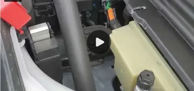

Hope when you are charging it you have the negative connected downstream of the BMS, either to the jump post or truck frame ground or to the post on the BMS sensor away from the battery blue circles not red X's:
I'm charging the way Ford Recommends. I took the 8 or so plastic screws. Like this image:
Ford F-150 Lightning Powertrain Malfunction / Reduced Power: Fix post #39 & 44 1768531057816-6x
I already have 4 missing plastic screws, so it was pretty easy for me to do this, otherwise I would have done it like you showed.
