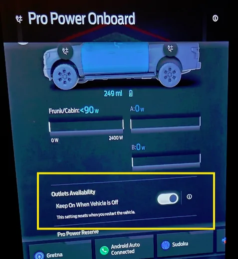

My 2023 XLT Option 312A seems to have taken this successfully, as described above. I had a "0" and a "0" and changed to "2" and "C".

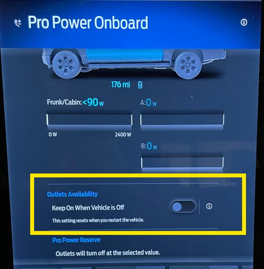

Here is a quick summary of Pro Power Onboard with the truck off with some useful links.
Starting with the 2024 model year, Ford added an option in the Pro Power Onboard settings to "Keep On When Vehicle is Off".
Ford F-150 Lightning Ppo enable with ignition off? 1772032688301-nc
It was soon discovered that when operating PPOB with truck off, that the outlets would turn off if the load was less than ~90 Watts for ~6 minutes. This does not occur if you leave the truck on.
