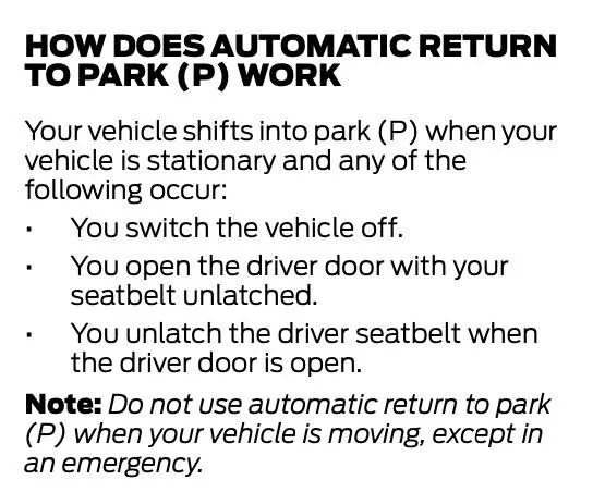

This is not a Lightning specific thing. Apparently Ford implemented this years ago on all models that have an electronic shifter. It is a safety feature. If you open the door, the vehicle will go into Park.
Keep your foot on the brake and you can shift in Drive or Reverse.
You may have to have seat belt on or release parking brake (I do not on my 2022), but you can shift out of Park with door still open (foot on brake).

This is not the situation the OP is experiencing. It is not about auto-park shifting, he is in gear, but the parking brake auto-sets if the door is opened while in gear. It can be overridden temporarily by putting your foot on the brake pedal and pushing the parking brake lever.

I have a 2024 flash, I can drive just fine with the door open and reverse. If I had my seatbelt off it switches to park but I can then have the door open and still put it in reverse or drive… it just throws a warning on the dash that the truck is not in park.
Interesting. In my '24 Lariat the parking brake will engage the instant I open the door if I have my seat belt buckled. I didn't actually try taking the seat belt off, opening the door, having the shifter automatically move to park and then moving it back to reverse or drive. I'll try that specific sequence and report back.
Agree, but I wasn't replying to OP's weirdness.
Was trying to provide context to other posters bemoaning the electronic shifter going into Park.
