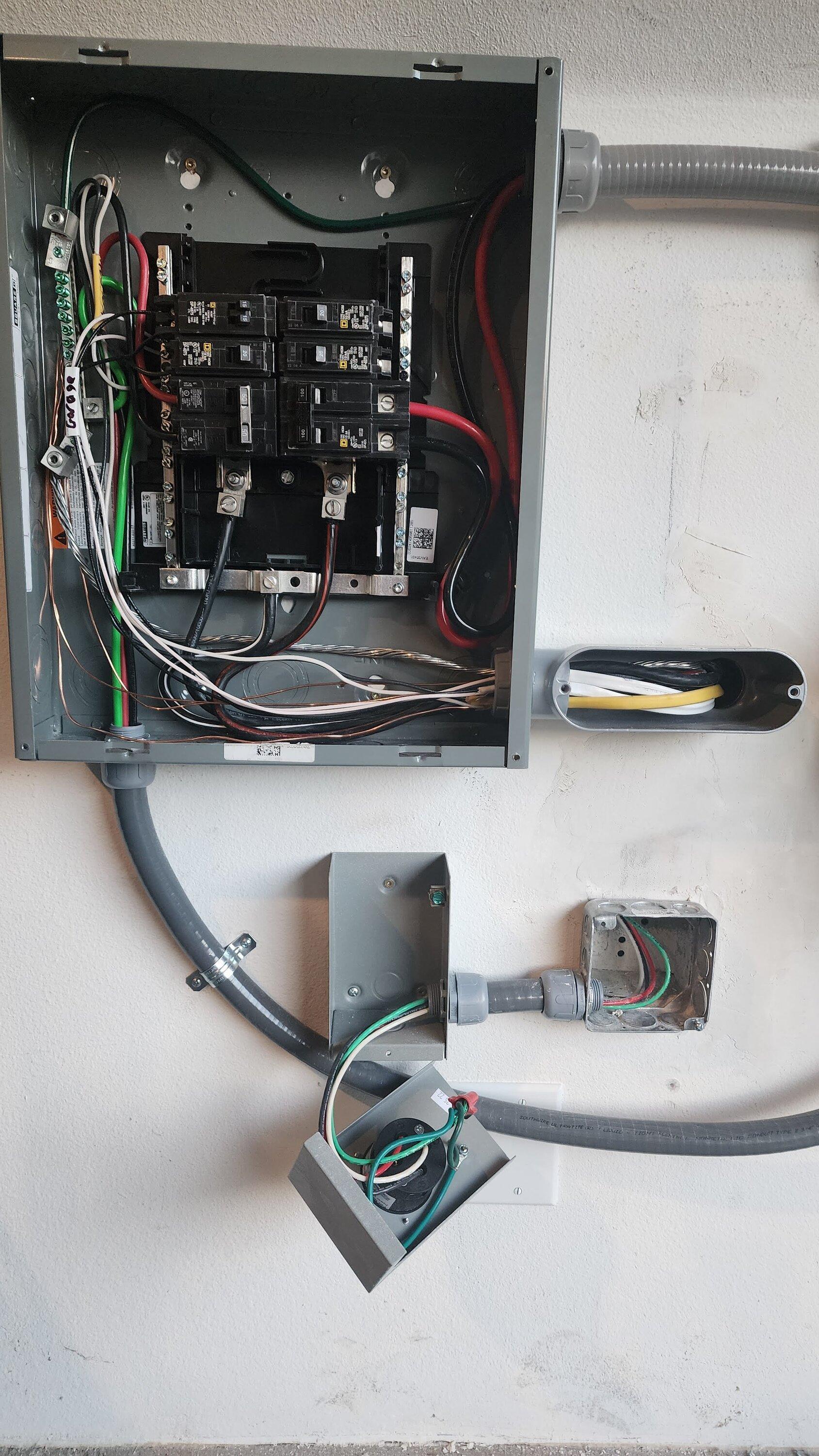

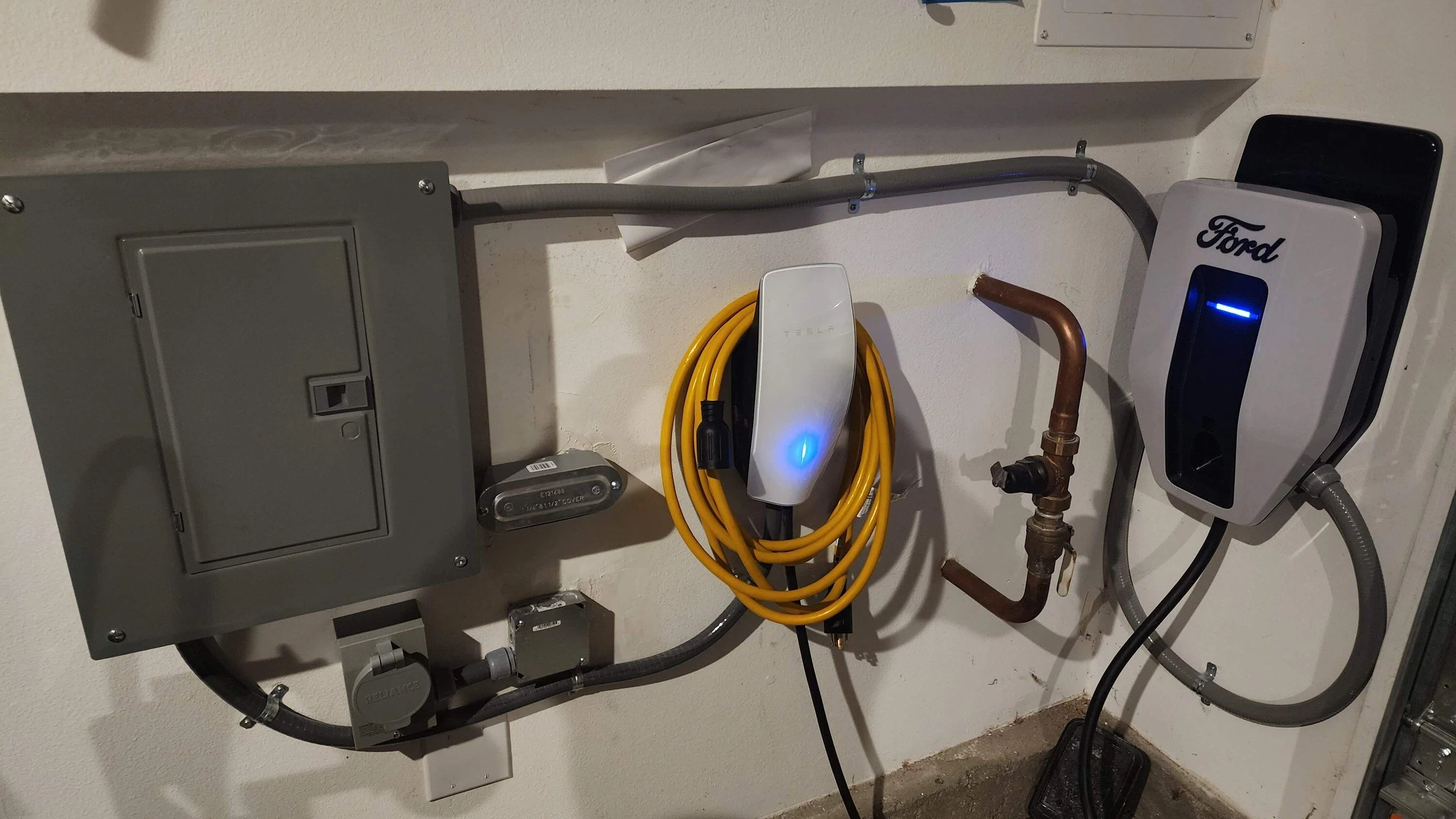

Finally took the plunge and self installed the Ford Pro Charger after having it sit in the garage for 8 months, as well as adding a generator inlet to use for backup home power. Thanks to others here, a few youtubers and existing knowledge of electrical work was able to make it happen. See below for pics, open to feedback and or questions. Was sharing the Tesla charger all this time which ran into some issues sometimes when both our vehicles were low. As well the Lightning was causing the Tesla to overheat and it would throttle down to 4kwh which was painful. Getting pretty steady 16kwr charge rate on the Pro and back to 8kwh on the Tesla. Anybody seeing anything different?

1 1/2" conduit body to make the turn into the wall, and then up to the bottom side of the main panel. Could not line up the back of the sub with the main due to the expanded wall area, so had to go out the bottom, the a small service loop in the wall to make the 90 into the body then panel.
30 amp Reliance generator inlet. Grounded body to house ground, but not to plug so as to not double up on the Lightning's ground. 10 gauge wiring.
Didn't go the route of a neutral switch panel because I didn't want to limit to only 8 circuits. Home has a ton of circuits and really didn't want to just pull 8 out.
125 amp Square D Homeline Sub 8 slots. 2 awg aluminum service wire used to power sub, used aluminum for flexibility in making those turns.

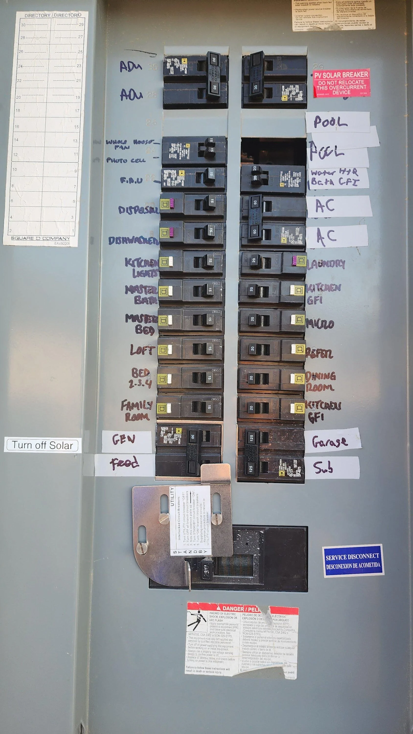

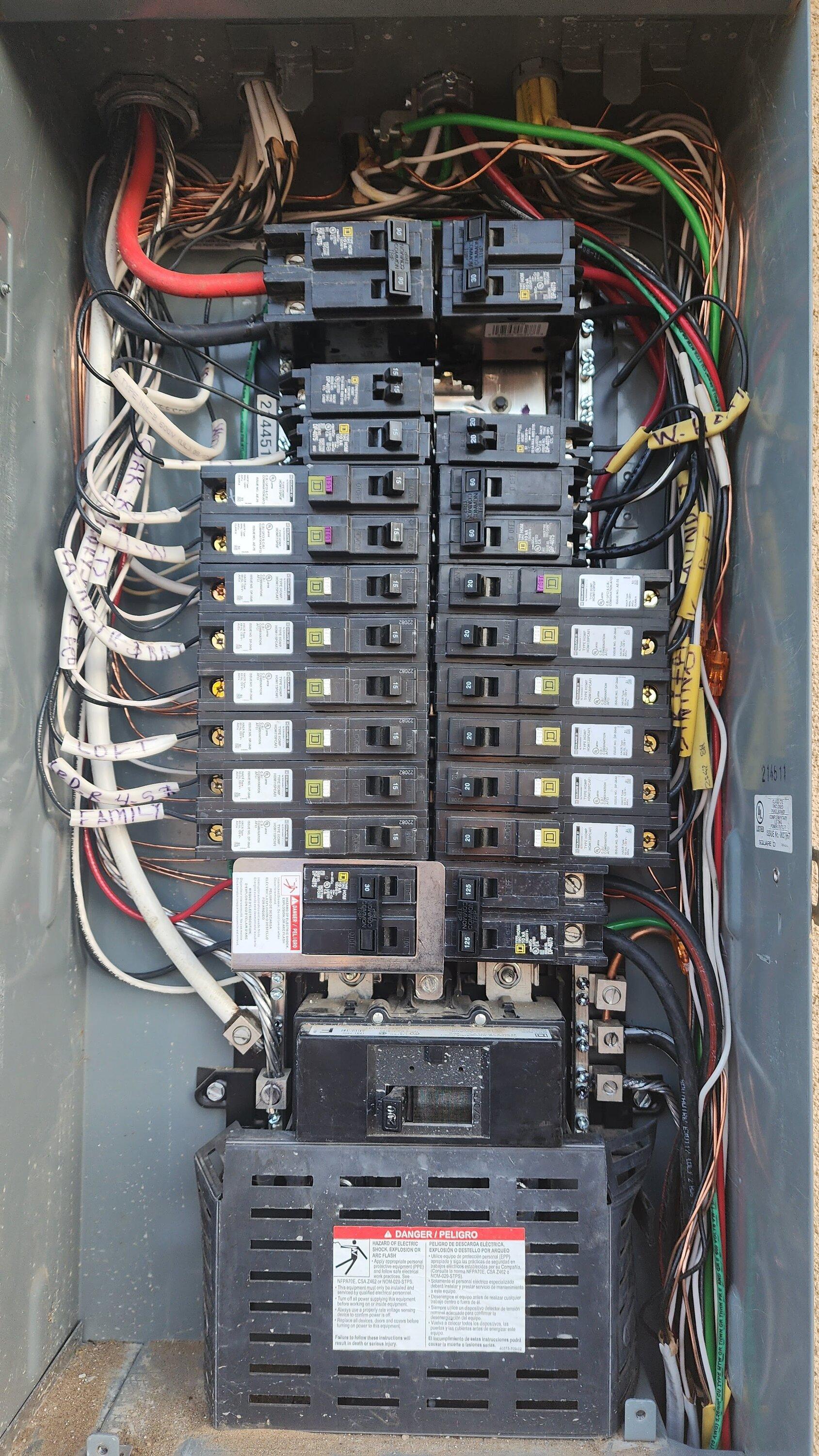

Had to rearrange multiple breakers in main panel to make room for a 30amp dual pole for the gen inlet so that I could use the interlock kit. As well as add a 125amp subpanel to power the pro charger and existing Tesla charger. Plus to make room for an under construction pool.
Subpanel now holds the two car charger breakers and a couple garage ones, with some room for expansion. Surface mounted everything to avoid annoying drywall work later, plus house ground and fire suppression system also already routed in this wall.
Ran the truck on Pro Power for 2 hours, noticed no issues at all! HAVE to remember to turn off Solar, as if you are drawing less than you're generating, then the truck will get upset as it's not designed to get backfeed on power in that outlet. Wish there was some sort of double interlock for this situation.

A couple comments:
Feeding the subpanel with #2AL on a 125A breaker is definitely a violation. #2AL is only good for 95A.
To compliantly install those 2 EVSEs on a 125A subpanel, the sum of their ratings can’t exceed 125A. Derating the FCSP to 48A with the dial would work. That would result in 50A for the Tesla and 60A for the FCSP for a total of 110A. But that doesn’t fix the undersized feeder.

From the picture I couldn't tell if you have separated the ground and neutral in the sub-panel
Hello, sure did! Neutral and ground definitely separated in the sub panel. Thanks.
There are separate ground and neutral busses. Nothing is landed on the neutral because his 120V circuits are GFCI - the neutrals land on the breaker.

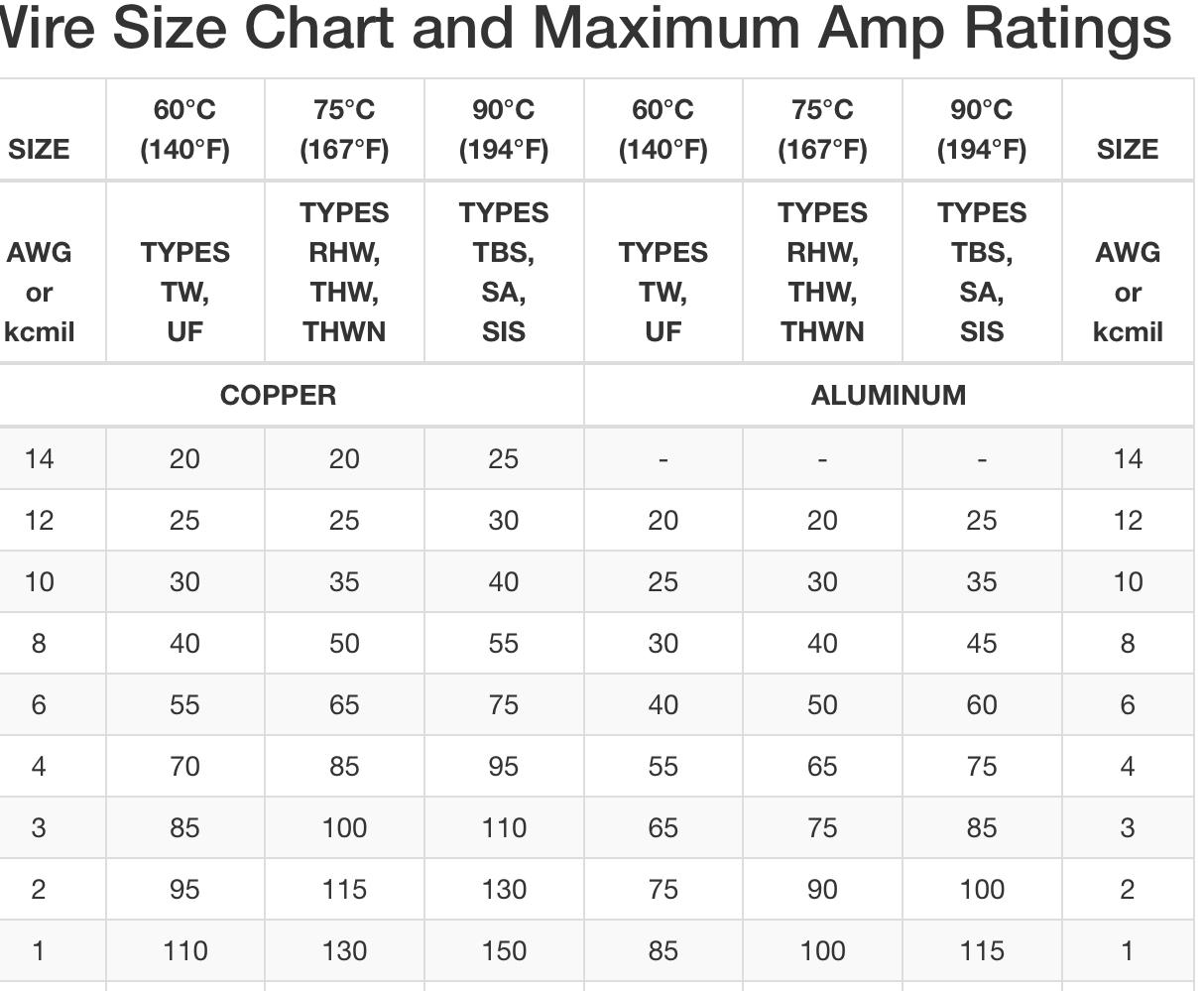

A couple comments:
Hello, thanks for the feedback.
The size of the AL was a contention point. Read several sites saying #2 was ok since Ford FCSP only pulls at max 80amp. 80% of 125 is 100 AMP which is what the wire is rated for. AL 1/0 would have been a sure bet, but was concerned about space and being able to make the turns into the boxes so went with #2.
The cars are set to charge at completely different times. Mine right at 9pm to stop at 4am, and the Tesla is set to charge later in the morning, so they're not running at the same time.
Thoughts? Appreciate the insight.
#2 AL is definitely only rated for 90A (I mistakenly said 95 above). There are provisions in the code where it can be used for a 100A service, but only if it’s feeding the entire home. You definitely don’t meet that provision.
The safest minimum thing you can do is replace it with #1 (or #3 copper) on a 100A breaker.
Not using the two chargers at the same time is safe, but the NEC doesn’t recognize that as way to undersize the feeder.
Here‘s the ampacity chart. You have to use the 75C column.

It's also a code violation to have an empty breaker space in the main panel. You need to install a blank or another breaker to plug it.
Thanks figured so, pool breaker going in there any day now. Will see if I have a spare laying around I can through in there in the meantime.
