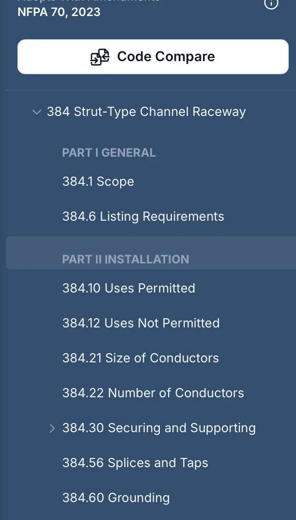

A quick Google search said 384-15
And I was in error, it's 42 branch circuits (not 40).

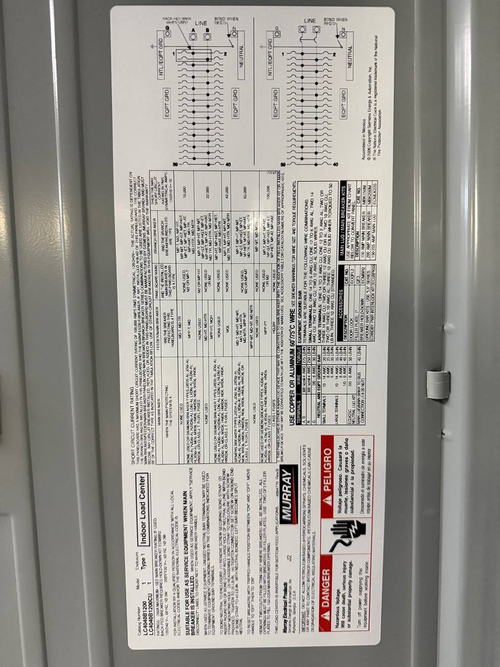

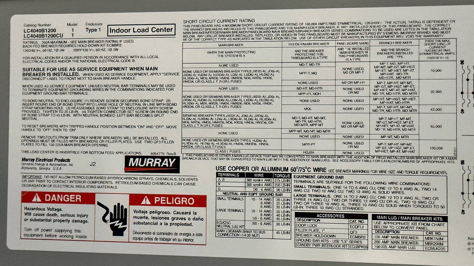

I know that on my main breaker panel (42 positions), there is a part of the bussbar that needs to have a notch in order for tandem breakers to be inserted. That notch is present in smaller panels, but not in the large panels.
Section 384 covers strut-type channel raceways and there is no part 15.

ETA….I think that was in the code at one time, but was removed. Perhaps in the 2017 version. You can buy 80 space panels today.

This was found in the 2005 nfpa 70, removed for the 2008 version.
408.35 Number of Overcurrent Devices on One Panelboard
Not more than 42 overcurrent devices (other than those provided for in the mains) of a
lighting and appliance branch-circuit panelboard shall be installed in any one cabinet or
cutout box.
A lighting and appliance branch-circuit panelboard shall be provided with physical means
to prevent the installation of more overcurrent devices than that number for which the
panelboard was designed, rated, and approved.
For the purposes of this article, a 2-pole circuit breaker shall be considered two
overcurrent devices; a 3-pole circuit breaker shall be considered three overcurrent
devices.

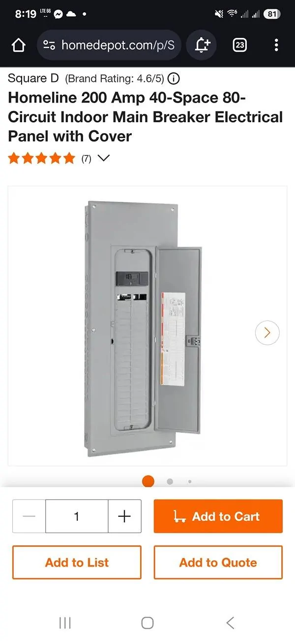

Here is homeline 40 space 80 circuit. You can technically use all tandems in this panel.

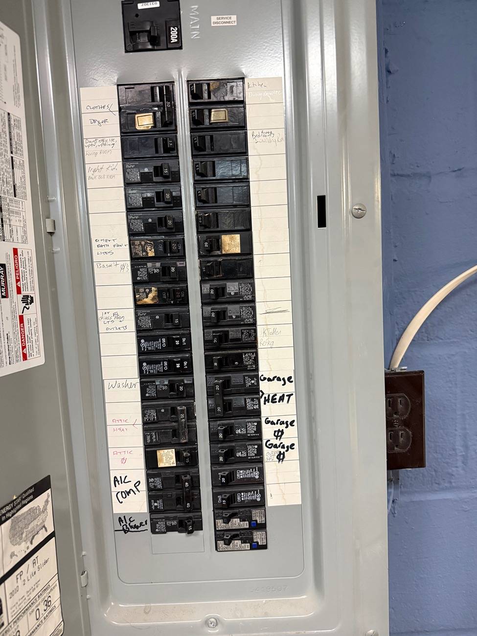

I will be using a licensed electrician but have read / seen on internet many licensed electricians unfamiliar with ev chargers, so hoping for some info here.
I purchased the ChargePoint home flex. Ideally would like to charge as fast as possible hardwired with the charger in my garage, but there is a great distance between my panel and garage, probably about 75 feet….also I might not have the room in my panel for higher amps….
so I’m open to suggestions. Luckily for me I have numerous low cost / free chargers available so rarely charge at home anyway (currently on level 1 outlet), but with tax write off and discount purchase through utility I figured I’d get the home charger, plus maybe I will be able to precondition the vehicle now.
Pics attached.
thanks in advance
