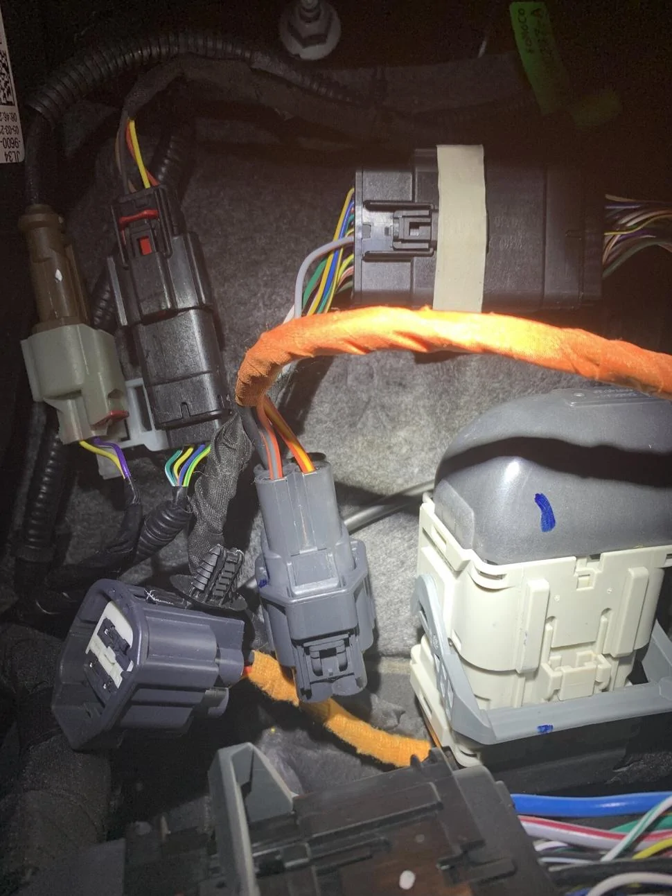

I had a similar problem with the “Breaker A Tripped In Bed” warning on every ignition start up. No breakers were tripped. All the bed plugs had power. Neither cabin 120 volt plugs had power. The TSB at the beginning of this thread said to check the harness connection at the dash outlet. The connection was ok. But the other end of the harness located in the engine compartment by the master cylinder, Connector C3412 on Harness #14405 had never been plugged into the main harness. The harness plug protective end cap wasn’t even removed from the harness. Purely an assembly line error. I think assembly line quality control should have seen the error message and corrected the problem. Barring that, I think dealer PDI should have caught this before I picked up the truck. The dealer service manager wanted to kick the truck back to Ford. The dealer tech wanted to fix the truck. Thank goodness for this forum because the dealer technician was lost until I showed him the TSB listed at the beginning of this thread. Even though it didn’t precisely describe my truck’s problem, it was close enough that the dealer tech knew where to pin out the harness and locate the actual problem. Kudos to this forum, and the dealer tech. Not so much for the dealer PDI team, the dealer service manager and the factory QC team. But I love the truck.

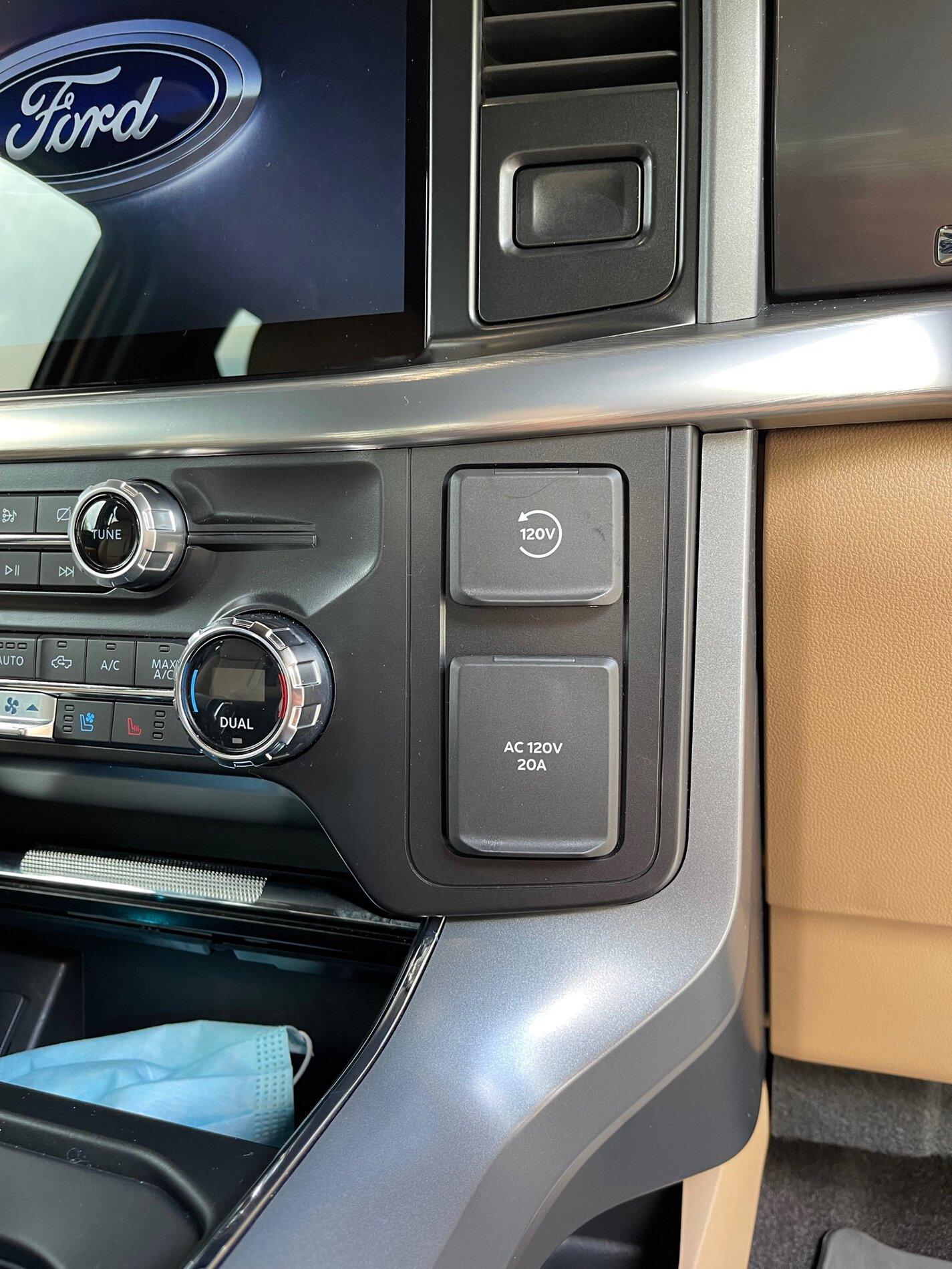

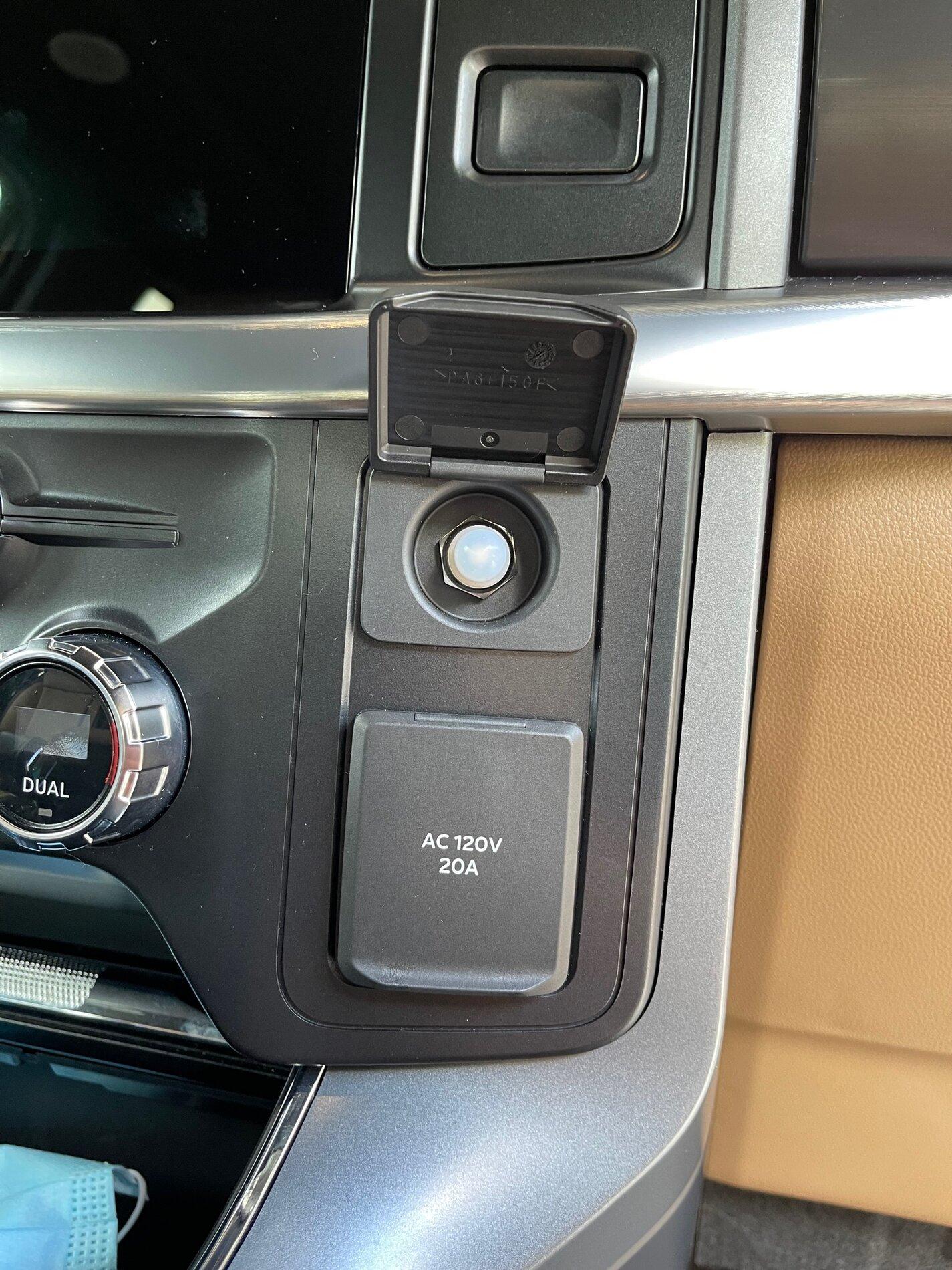

Sure I will. Its the 120 outlet on your dash. Right above the outlet is the reset button for the breaker. I will take a pic at lunch and send.

Harness plug between the master cylinder and the fender. I’ve been having an online conversation with another member and his problem was the same as mine. I wonder how many trucks have this same assembly line error. I’ll bet it’s lots.

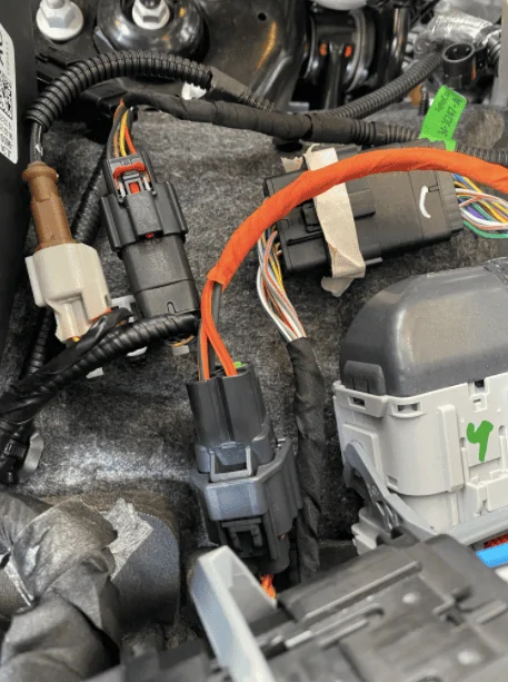

A better photo from member EAC showing the unplugged harness. It’s the one with the orange colored wrapping.

I had the EXACT same problem as mentioned above. The paperwork when I got it back mentioned something along the lines of removing heat shield and plugging in plug into correct socket. Fixed everything. Looks like someone on the assembly line just said “F it” to that part of the job!

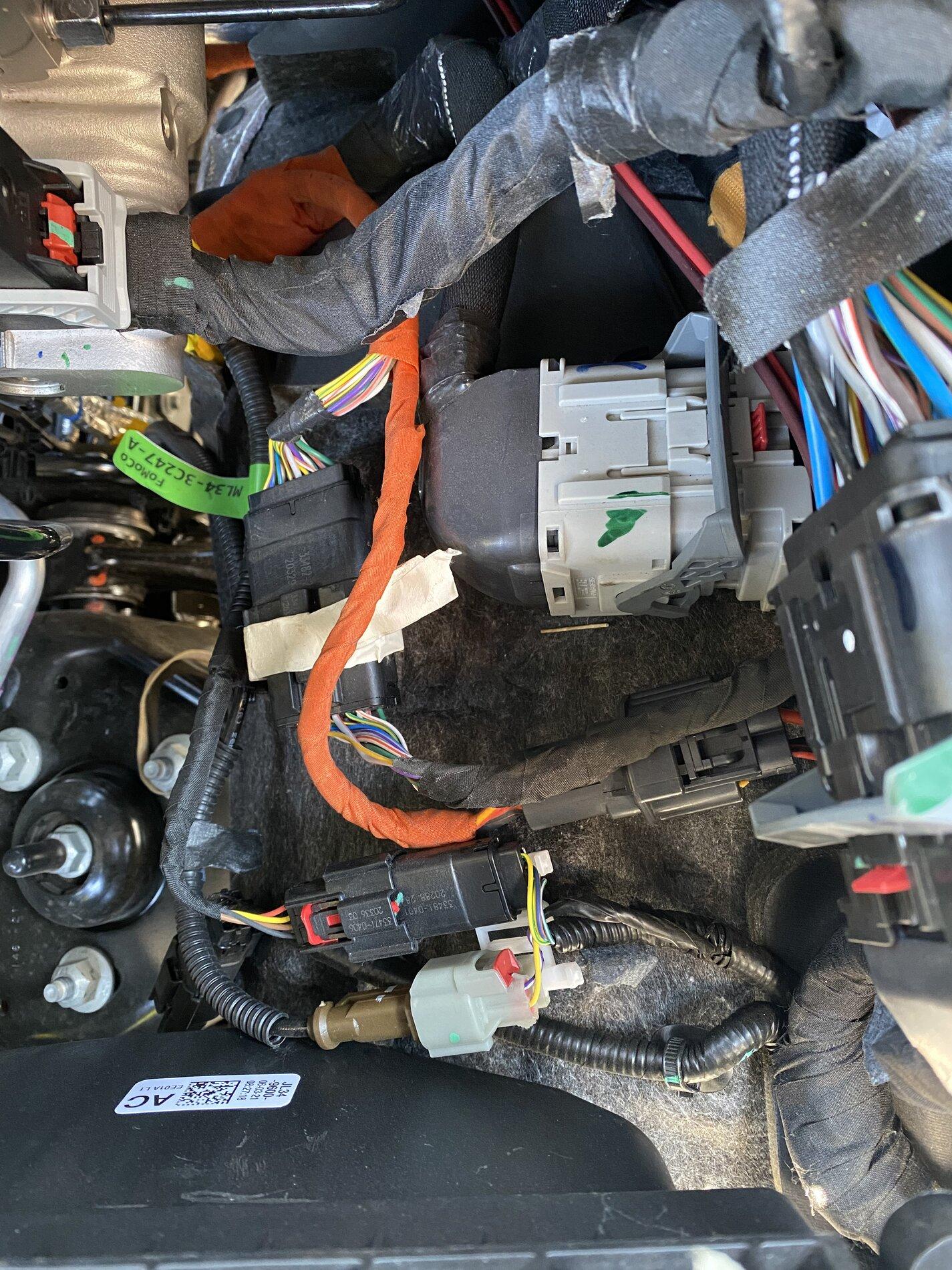

"When a hero comes along..." Months of dealing with the error - dealership at a loss despite all the information provided on the forum. I open the hood and find the same... Thanks for posting!

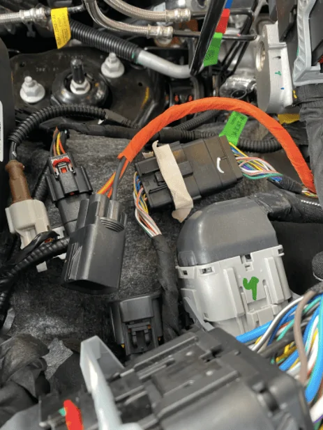

WOW, thank you folks!! I went to the dealer to pickup my plates tonight, and had a 9/7/2021 appt to fix this issue. I popped the hood while waiting and look what I found, just like ya said!!

That is the same message I used to get. I kept going to the back and pushing the reset breakers in the bed but it would never go away. After I pushed the breaker reset in the cabin I never saw it again.
Start the truck, then hit the breaker button in the cabin. I will go take a pic now for you. When you push it hold it a second. That should fix the problem. Be back with a pic in a sec.

The 120v top white button is the breaker reset. Let me know how it goes.

Hi Marine, I pushed the breaker in and held it for a bit, but nothing changed. Also, I still do not have power in that plug....but thanks for the suggestion, I will keep trying anything you recommend.
