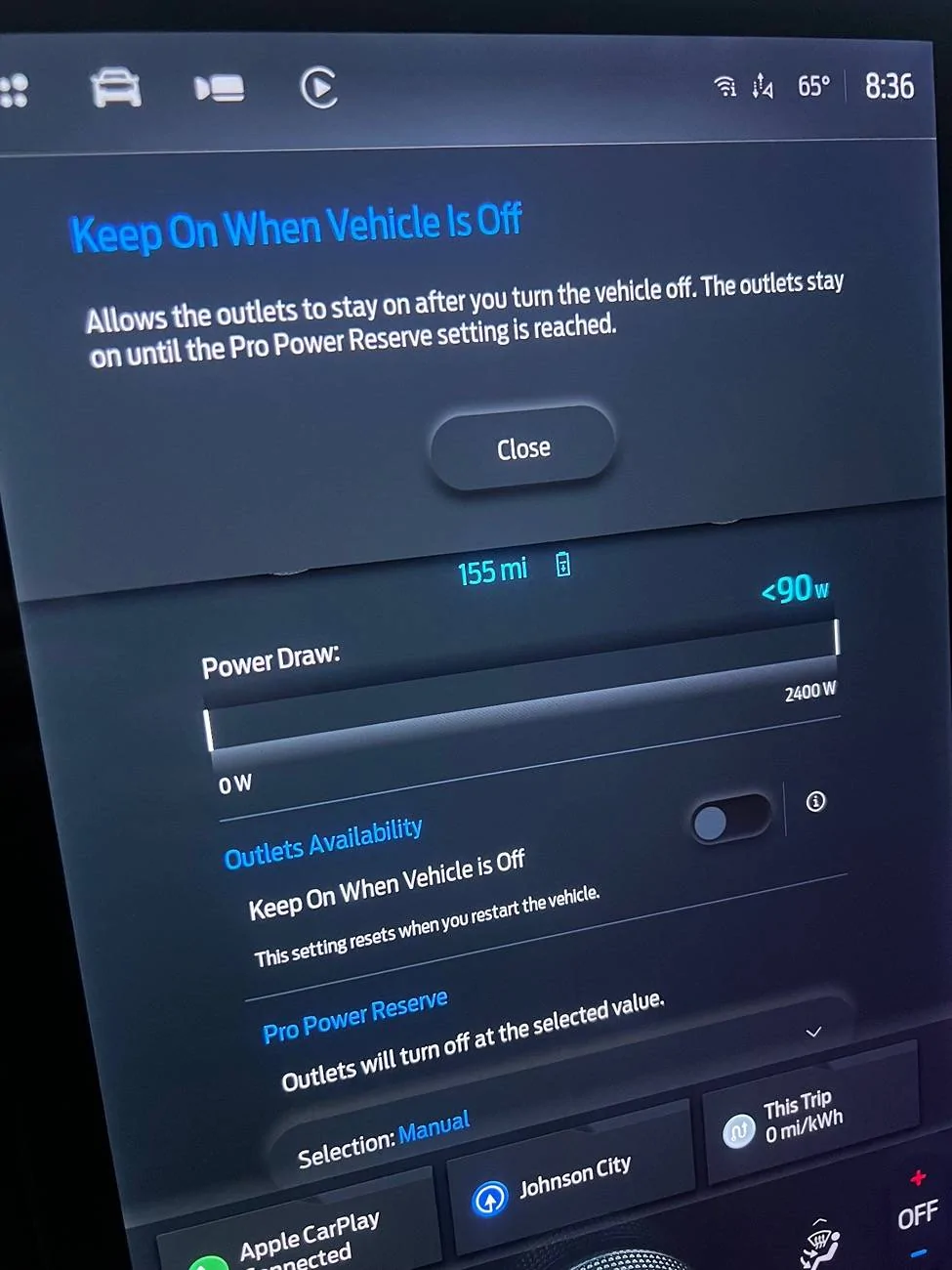

So theoretically they should stay on once I flip the toggle.
Your screen shows that your 2024 has the newer software/firmware and can stay on with the truck off.
The switches you have on already will keep ProPower Onboard going all night -- in fact until your ProPower Reserve is reached.
If you switch on the "Keep on while vehicle is off" that was added with the 2024 software/firmware stack, it should stay on all night with the truck off.
I believe folks with 24's have reported that even with that turned on, if there is not a load (like 90 watts), it will still turn off after a period of time (IIRC like 6-15 minutes).
Should probably test it before you go with the loads you will have.
Can someone document this 90W load requirement? I don't see it anywhere in the 2024 manual.
A 90W load is certainly not required when the truck is turned on in older model Lightnings.

I read that post as if @Gerstein1989 had experienced it. My memory isn't great but iirc another member did tests and came up with the 90ish number.
EDIT: see this post. Also others reporting the issue in that thread.
And yes only for 24+ with the truck-off option they have.

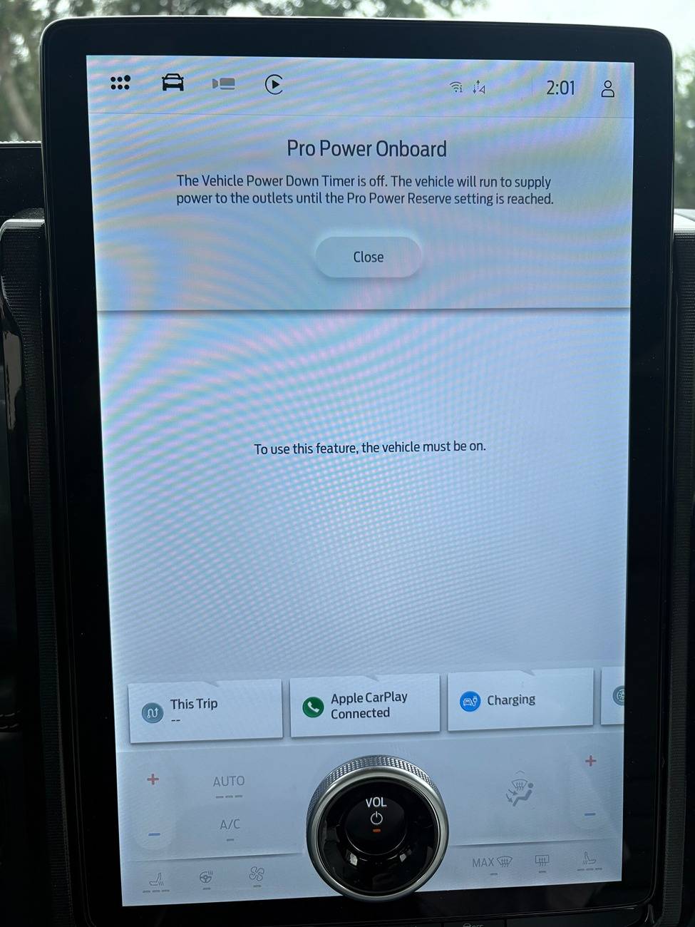

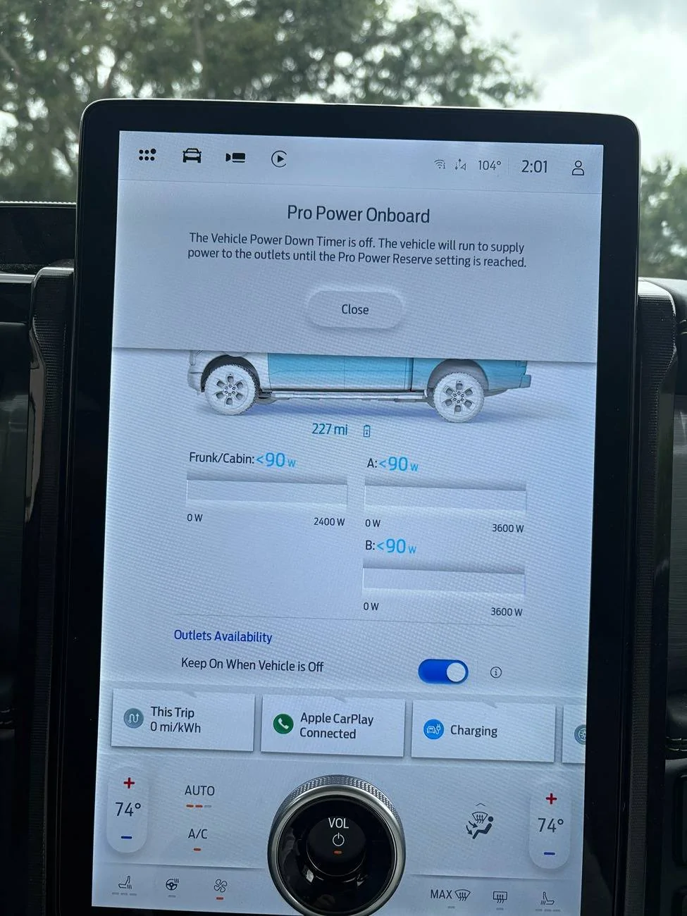

I posted this a few months ago: Try it yourself and see if it works for you. I’ll do it again in a few minutes myself.
EDITED!
TEST FAILED WITH NO LOAD! PROPOWER OUTLETS TURNED OFF AFTER A PEROD OF TIME.
I BELIEVE I FOUND THE PROBLEM AND SOLUTION!
I just got in the truck
left the driver door open
started the truck
Selected Pro Power
Turned on bed outlets
Selected “Keep Power On while vehicle os OFF”
Then turned the truck OFF
exited the truck
and a few minutes after turning off the truck the bed outlets turned OFF. ?
Then 2nd time
I got in the truck
SHUT THE DRIVER DOOR
Started the truck,
Selected Pro Power
turned on the Bed Outlets
selected toggle “Keep Power ON when Vehicle is OFF”.
Turned OFF the truck
exited the truck
AND HERE It Is 25 Minutes later outlet power is still ON!!!
So it seems the solution is to close driver door BEFORE starting the truck and making setting selections.
3,253
4,732
What kind of load do you have attached to the bed outlets to verify on or off? As noted, loads less than 90 Watts seem to cause the unwanted behavior.
flyct
Jerry
Sep 28, 2023
1,096
1,298
South Florida
Blissfully Retired
EDITED!
TEST FAILED WITH NO LOAD! PRO POWER OUTLETS TURNED OFF AFTER A PEROD OF TIME.
Now testing it with nothing plugged in , ZERO Load. I'll report back in 30 minutes when I plug in my cooler in the bed and see it the outlet is still live or not.
What is interesting is that the screen said the vehicle must be on to use this feature even when I selected Keep (Pro Power) On When Vehicle is Off

No, this has been the real world experiance by more than one. The fact that it needs a minimum draw is undocumented, that's not much of a surprise.
Again, this is wrong. The Pro Power does NOT stay on if draw on the system is less than the minimum. A few tests showed the draw needed is just under 100w. Others tested it and showed the system shut down in about 6 minutes (iirc) when draw was below the 90-100w
In practice is expect there is very very little difference between Pro Power with truck off and Pro Power with truck on. I expect the only practical difference is the screens. Aside from that you can manually turn off the HVAC and radio. Pro Power itself will still mandate that most of the rest of the systems remain active, specifically the cooling loop and fans. The Pro Power inverter is liquid cooled so the same coolant loop will be active truck on or off. The same is true of the security of the truck. It cant drive without the key so on or off its the same effort to steal the truck.
All true except the truck's alarm is not active when it's on. I imagine that on the '24 and '25s the alarm is active if pro power is being used with the truck off.
I have no experience with the '24 and later trucks but the 90 watts minimum requirement seems silly. Good chance a modern inverter based fridge draws less than 90 watts.
