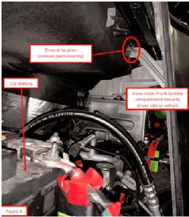

Planning on using the PPOB on our new Lightning Flash during power outages. Do you take any precautions before you connect your battery maintainer? I've used a maintainer on all of our cars including our previous EV and everything worked fine just connecting it to the +/- terminals. But before I connect it to our new Lightning I just wanted to confirm that there isn't anything else I'd need to do. TIA!
Yes, the negative should be connected to a ground point or down stream of the BMS sensor which is mounted to the negative battery terminal:
Ford F-150 Lightning Pro Power reserve limit fails IMG_6024-battery BMS sensor
Ford F-150 Lightning Pro Power reserve limit fails where to connect neg for battery charger
And of course take the usual precautions to avoid shorts or sparks, etc.
Got it. I actually used a chassis ground to avoid the shunt/smart sensor completely in our other EV, so this will be easier.
Thanks very much!
