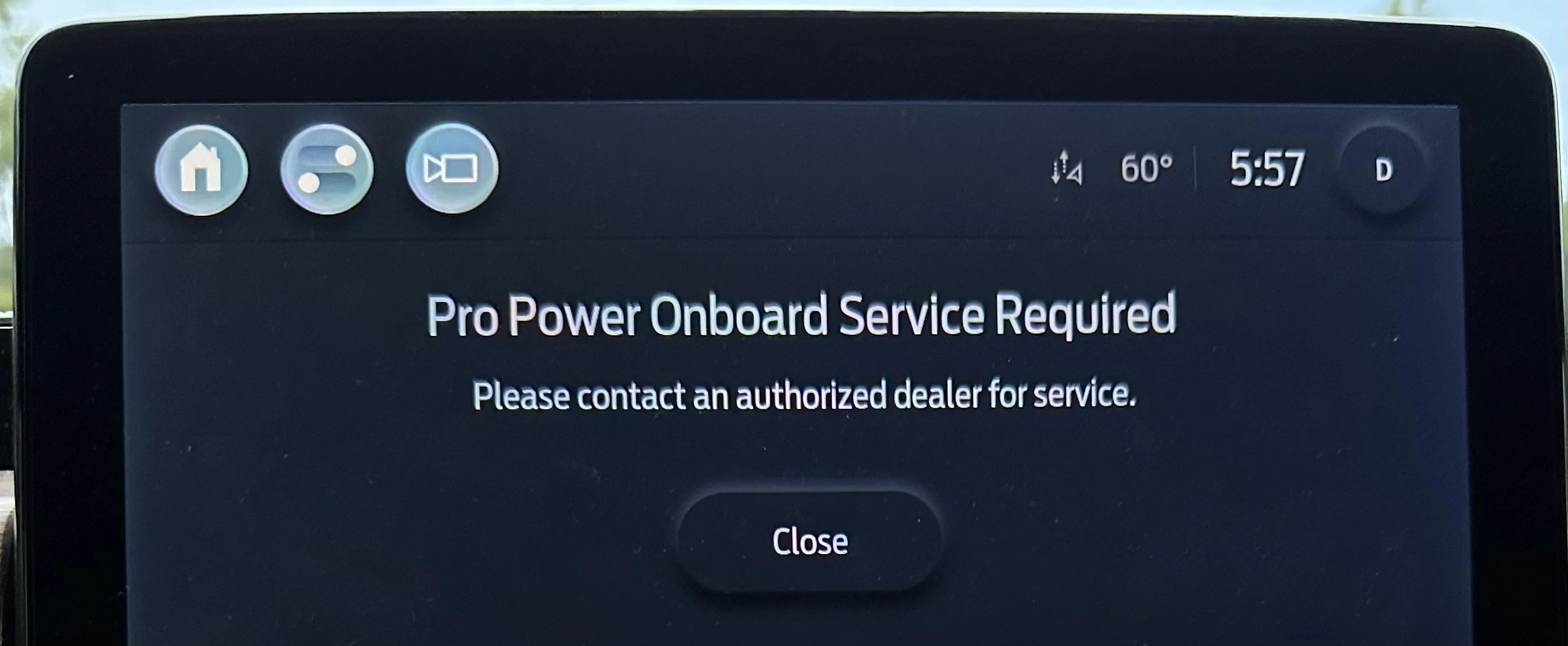

Data point here, got this today:
Ford F-150 Lightning Pro Power problem IMG_4429
Nothing was plugged into the bed or frunk outlets when the message showed, haven’t had something plugged in for about a month now…I did however update recently - within the last week.

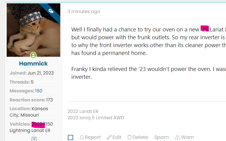

Well I finally had a chance to try our oven on a new '23 Lariat ER at my dealer. Oven wouldn't power on using the bed outlets but would power with the frunk outlets. So my rear inverter is working properly I guess. I have no explanation as to why the front inverter works other than its cleaner power than the rear. Looks like my big power conditioner has found a permanent home.
Franky I'm kinda relieved the '23 wouldn't power the oven. I wasn't looking forward to battling Ford for a new inverter.

Well I finally had a chance to try our oven on a new '23 Lariat ER. Oven wouldn't power on using the bed outlets but would power with the frunk outlets. So my rear inverter is working properly I guess. I have no explanation as to why the front inverter works other than its cleaner power than the rear. Looks like my big power conditioner has found a permanent home.
Franky I kinda relieved the '23 wouldn't power the oven. I wasn't looking forward to battling Ford for a new inverter.
Is the '23 an additional Lightning or replacement of the '22
Sorry I should have stated the '23 is on my dealer's lot. They have about 5 lightnings in inventory and a ton of Mach-Es lined up.
