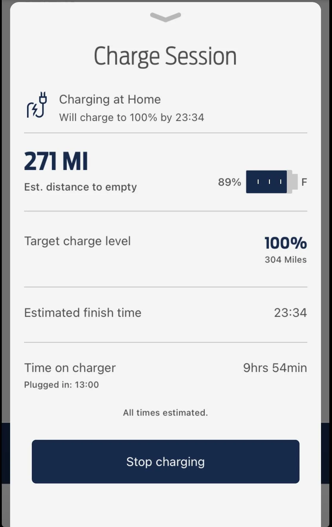

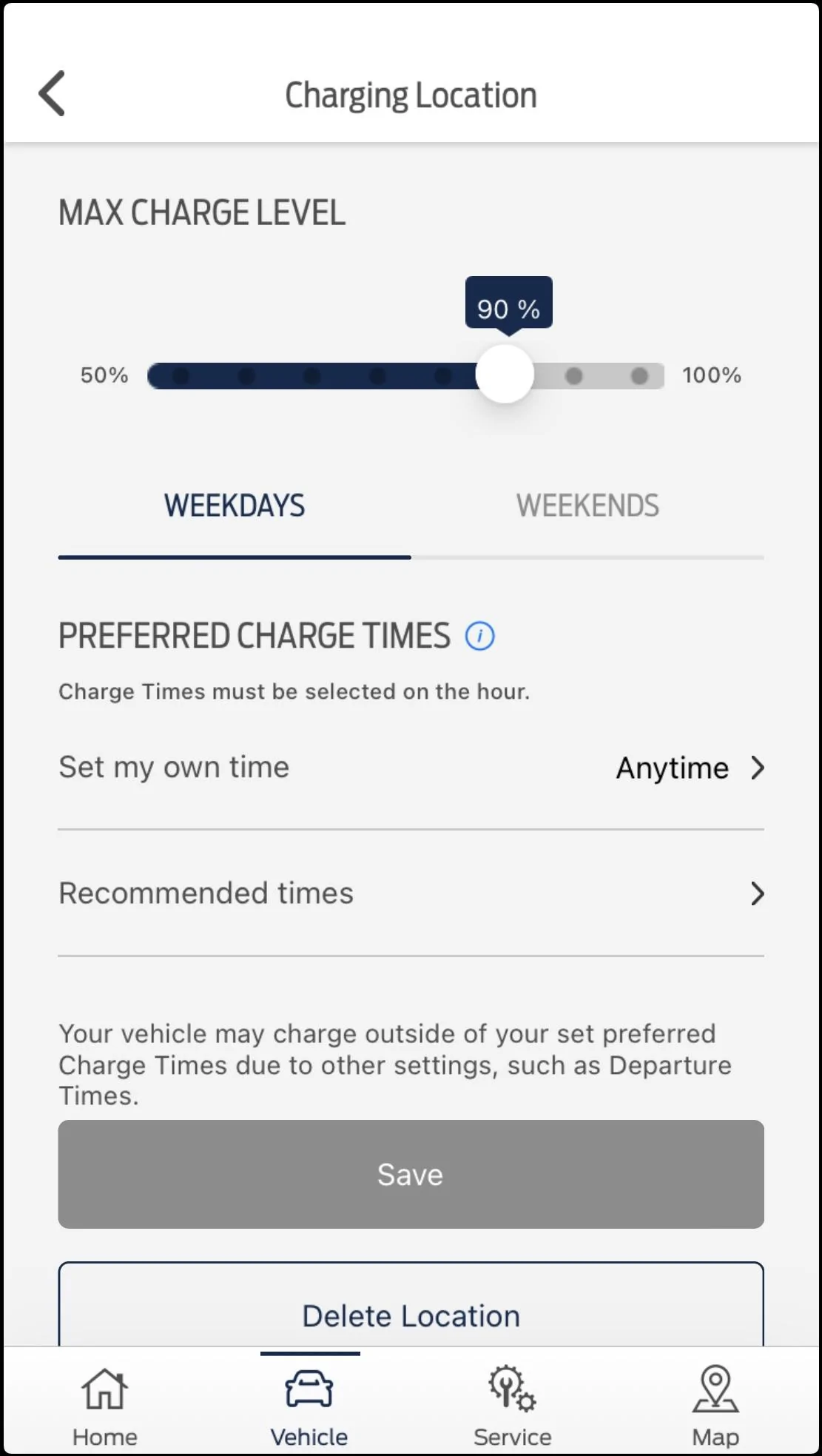

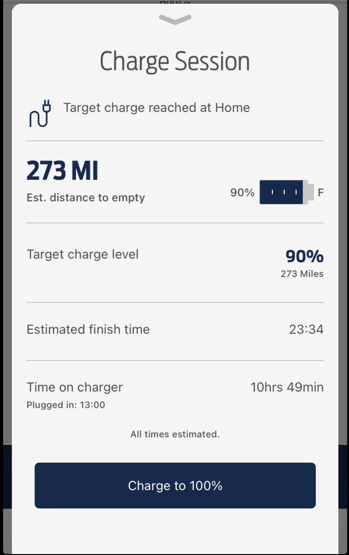

Well more confusion here. The car seems.to require “use preferred charge settings” selected in the truck for each charge location in order or not charge past the limit (it just went past my limit tonight). No mention of this setting in the truck’s Charge menu.
Entering the Charging Locations menu in the truck reverts the location in the app to “charge when plugged in”

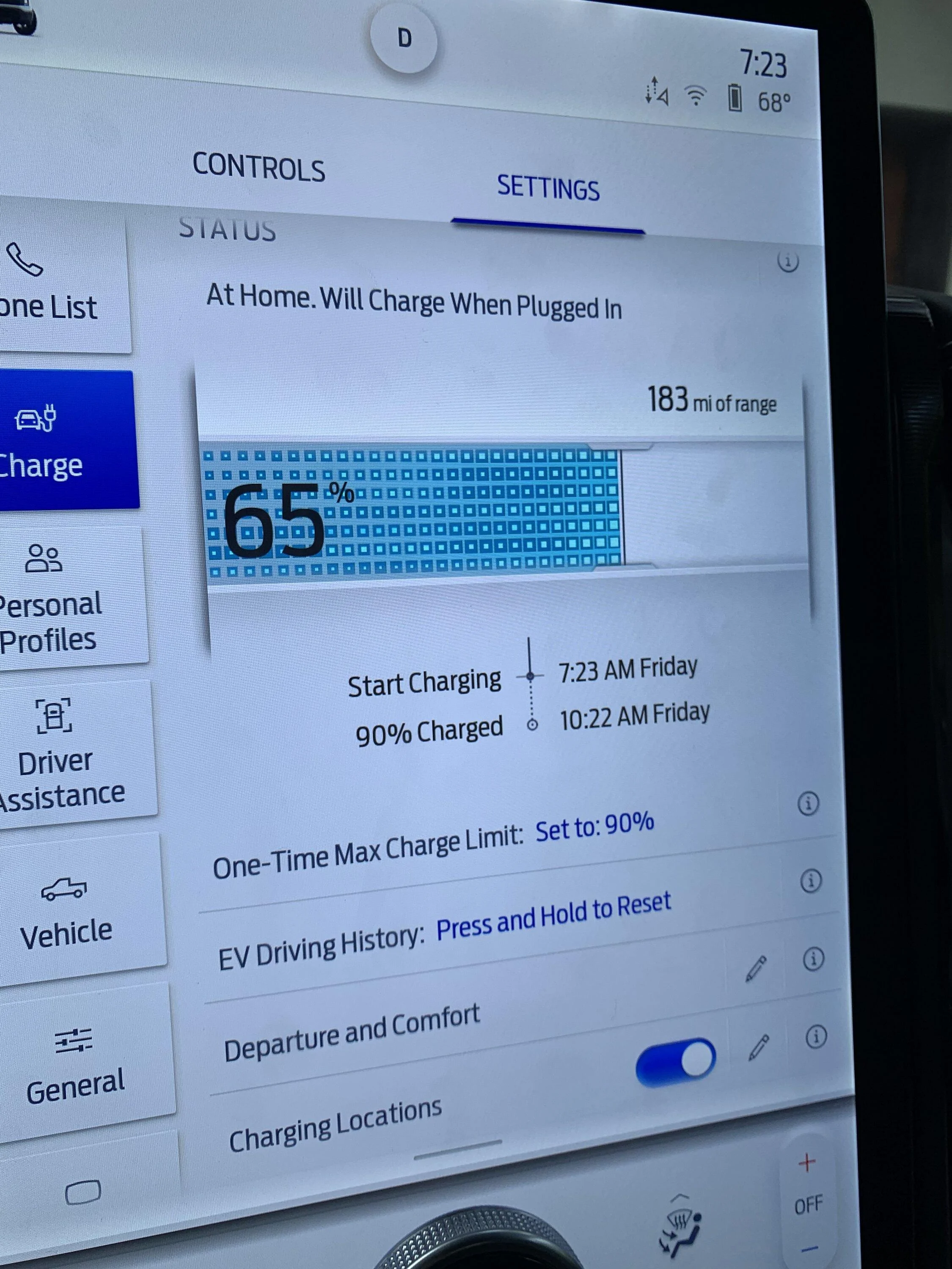

Sorry if this is common knowledge, but I was really frustrated thinking that I couldn’t set a charge limit except for the 1 time limit adjustment.
Turns out if you go into/edit the “Charging Locations” screen (toward bottom of picture - on the “Charge” settings section) you can set permanent limits for specific locations. This will work perfectly for me since the only places I regularly care about the limit are at home and work, so I set both for 90% to help with battery life. Anywhere else I’m fine either setting a 1 time limit of needed, but I doubt I’ll be chargi³ng many places on the road where I accidentally go over 90%.
Only had my 2023 Lightning 2 weeks. Was thinking same thing. You just made my day if this works. Trying this tomorrow.
4,420
5,934
It works…..as described in the owners manual.

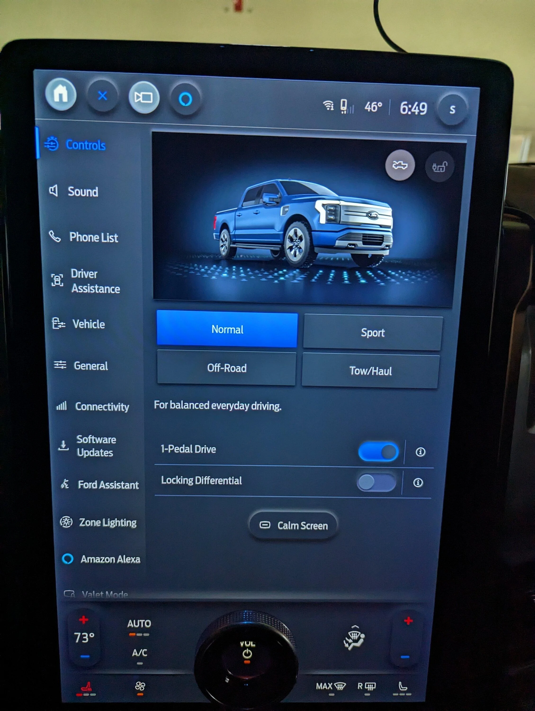

Thought I was going crazy… perhaps I still am, but after the update last week, my Charge option appears to be gone! Where did it go?
Ford F-150 Lightning PSA - Setting Charge Limit (not one-time) PXL_20230424_224934427.MP_Original
4,420
5,934
It’s now an app on the Home Screen, not in the settings.
