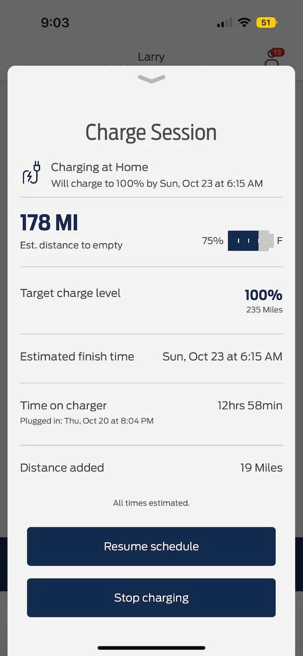

Thanks for the calculations. I'm wondering if I should be "going on record" with Ford about it (in case it gets worse.) I'm thinking I should just "lay low" for now to see how things shake out over the next, say, 6 months.
You would be wasting your time. There is no issue, but your lack of understand that EPA estimates aren't achieved in real world driving on any vehicle made.
If you live in an area that has cold winter weather, you will soon see a 30% drop. And if you run the heat at say 75 degrees...
I guess my problem is this: My last car -- a gas 2013 Fusion -- had an EPA of 25 city, 37 highway. From day one I got 29.8 MPG. When filled, the range was 505 miles. These numbers stayed consisten for 9.5 years, 88,000 miles. Never changed, no matter the temperature or any other condition: 29.8 MPG. Whereas my Lightning started out with a range of 319, dropped after 1000 miles to 310 and then stayed consistant until 3,500 miles But in the last 750 miles, the range has dropped each time I charge it. It's now down to 255 miles. Sucks.

You didn't actually ask a question to be clear. But if I can infer what you intend, "going on the record" won't do much. Your battery has a certain initial useable capacity. The BMS will track how much actual capacity you have in kWh. As long as you have above 70% through the end of your battery warranty, Ford isn't required to do anything.
I can answer your charging issue though. By default, the Lightning will charge to 100% on L2 and 90% on DC. There are two ways to change this:
1) Before each charge session, you can set the one time charge limit to your desired charge level. This only applies to your next charging session (and it might reset if you drive, not sure on that...). You can also do this through the FordPass app, though generally I think you only get the option to "Charge to 100%" and only after you have plugged in.
2) For L2 charging, you can set up a "Preferred Charging Location". You do this in the infotainment or in the FordPass app. One of the preferences for the charge location is the charge limit at that location. Looks like this in the app.
Very helpful information. Much appreciate your taking the time.
