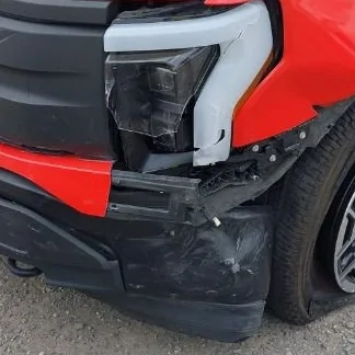

Hi. Could you offer a bit of advice? I'm thinking about purchasing an F-150 Lightning that has been in a minor fender bender[.]
Personally, I wouldn't, unless the price is so low that this is practically free.
Because of the electronics in this area of the truck, repairs are likley to add up fast. A teenager hit the rear taillight assembly in my truck, and did not break any of the sensors. The repair involved removing the damaged housing, moving the sensors to the new housing, installing the assembly, and verifying that the sensors were calibrated -- overall, some $1500 in parts and $2000 in labor. So I'd expect repairs to be around $10,000 on the low end, and quite possibly more than that depending on how deep the damage goes.
If you've got a fully-equipped shop and are used to working on F-150's, then this sort of rebuild may be a good project for you. If not, it probably isn't worth it in terms of time, money, and aggrivation.
Thank you. I do like a project and have worked on Fords for decades.

How much money are you saving? That could be a $3000 repair or it could be a $15000 repair. I wouldn't take the chance for less than a $15000 discount.
Also, without someone looking at it you don't know if suspension or frame parts are broken. A bent frame would be a hard no at any price for me.
Just my opinion. It's possible it's a straight forward repair and a good deal. I'm focusing on the unknown.
Thank you for the good advice.
