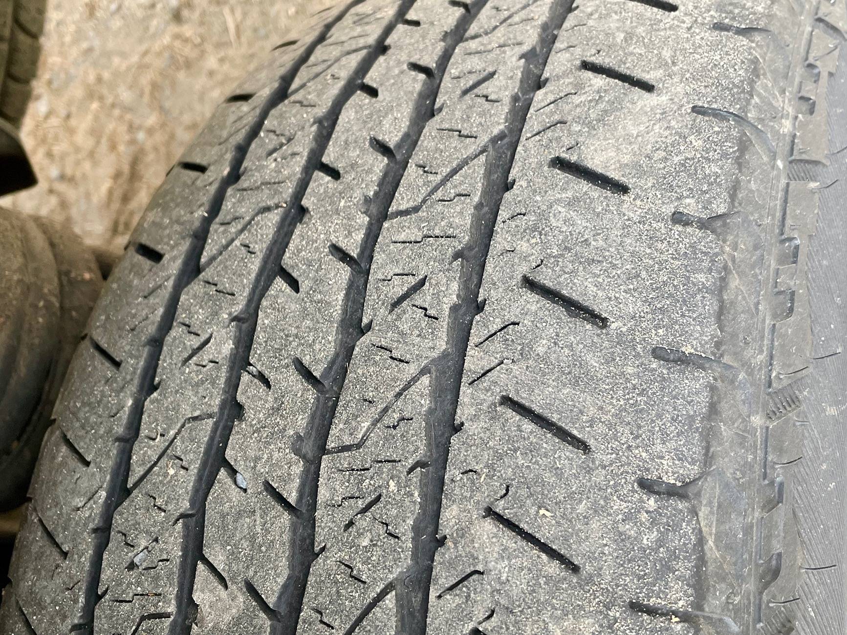

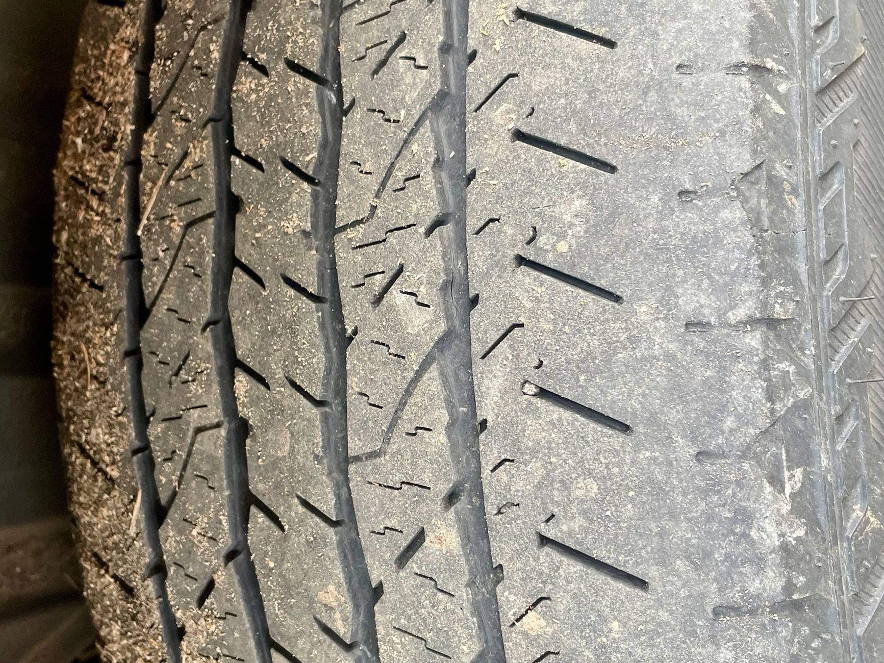

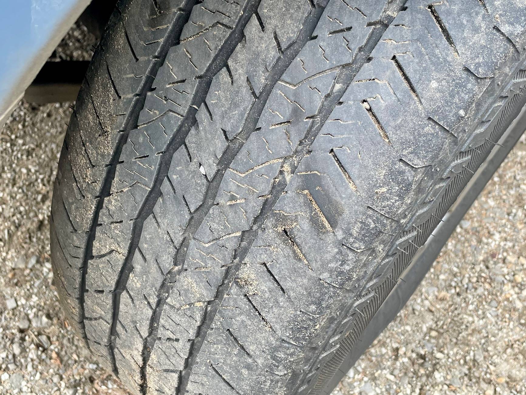

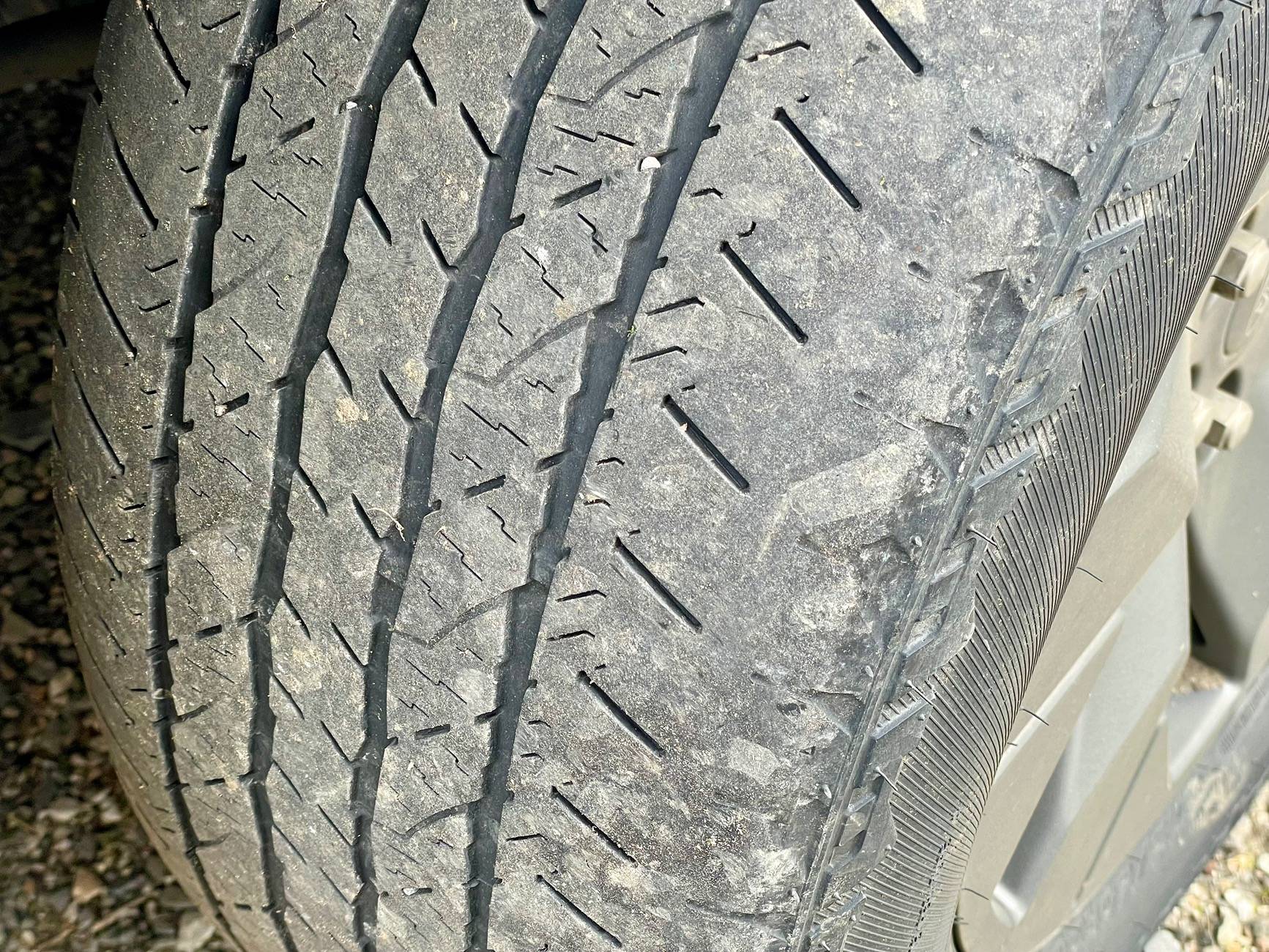

Great question. The shoulders were pretty gone. Center tread barely decent at 5/32s but the 3 dozen curves X twice a day really worked the tires over the first 10K as I was taking those turns a bit hot. Think I could’ve got 50K out of them if I rolled slightly less fast. Like slower lol?! 40 psi cold.
We had a snow spell and I nearly totaled the truck crossing an iced up bridge deck. Tires are too worn for slush, mud, wet grass :LOL:, heavy rain driving and I was damned lucky.

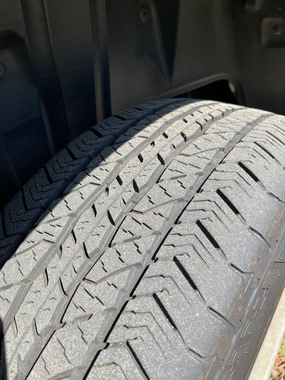

My Hankooks werent rockstars in the snow but they did alright. I would have swapped tires too if I almost had wiped out. My commute is 95% highway for about 60 miles, I think they look pretty good for 30K. All four of my tires look the same. Alot of people describe shoulder wear but it just seems to be a characteristic of taking turns too fast.

That’s a good looking tire for 30K!
Yep, heavy truck cornering at speed will do that… wear badly on shoulders. It is not a Sport Truck. FYI, worn tires pumped to 45 psi get great efficiency ? but eh.. no traction when you need it.

So my Hankook tires look exactly the same as yours, mine are at 42k. When you got the Defenders put on, did you need an alignment? I'm curious if that's just how those tires wear (as lots of people on the forum have the same wear), or if these trucks come from the factory with camber or general alignment out slightly.

I had the alignment checked and it was in spec. I did take those corners hard. Not quite tire squealing but close ?!
Cambers a good question .. our Sport Trac Adrenalin had ever so slight negative camber but my wife still wiped out a set of Pirelli Scorpions in 25K miles.
I had these rotated front to back at 10K, 20K, 30K and it was at about 25K I really backed of on cornering and babied for 15K miles. I suppose it’s possible that the truck empty is fractional degree positive and only goes negative with a load on?
I’d be curious what those with more alignment experience say. I
