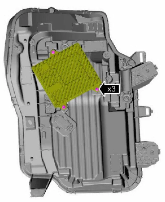

I just checked the shop manual and it looks like programming is only needed if you are also replacing the LDCM (Lighting Driver Control Module A/B). It seems to be attached to the headlamp (part shaded in yellow).
So if you can transfer that module over you should be fine. Kind of like the tail light - I was able to transfer the old BLIS module over.
Says you have to remove front bumper and frunk to replace headlight!
Interesting! So the module on my old light must have been damaged then.
2,908
4,150
More likely they can't buy just the light. On the tail light, Ford doesn't sell the light without the BLIS module.
So once they have the assembly, probably easier and less risk if they just have a tech program it rather attempt a swap. But DIY'ers can save a few bucks.
