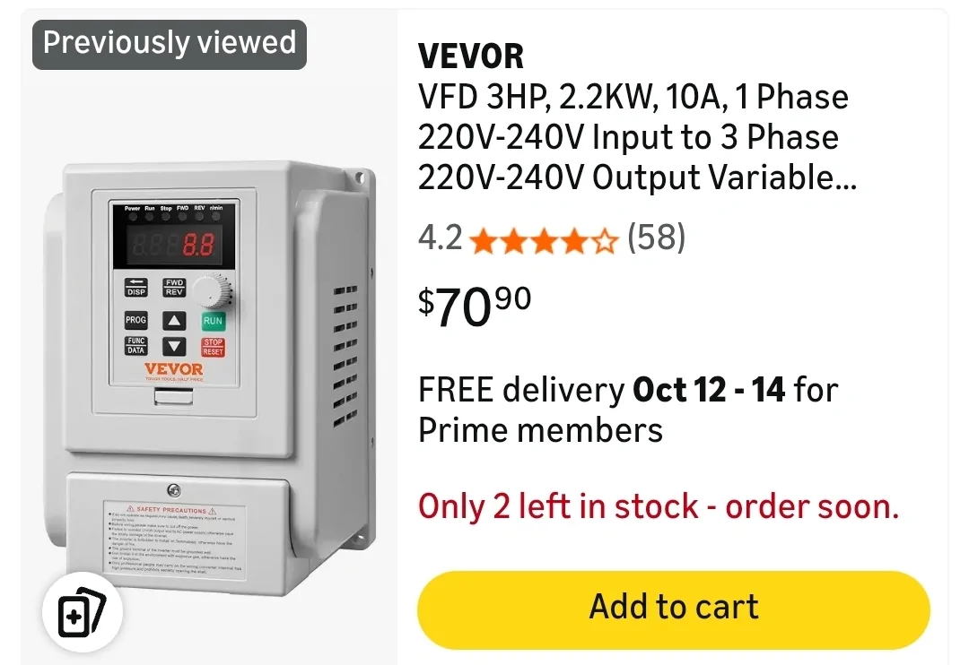

You can definitely use a VFD that's capable of single phase 240V input, and output 3-phase 220v. The VFD has to be bumped up in size to handle the conversion. Usually 1.5 to 2X the power rating to prevent overheating.

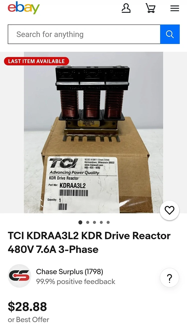

Also, you definitely need a line reactor between your truck's 240V and the VFD input because all the VFDs generate harmonics as it's generating its three phase output. The harmonics are electrical noise with high voltage spikes. If you try to run the VFD without a line reactor you risk damaging the Inverter built into your truck that supplies 240V.
The VFD can be set up to output 220V through the configuration settings. Be sure to set the VFD settings according to your motor nameplate data. Input voltage, Hz, FLA, HP. output voltage.

I have also included a picture/source for a line reactor. The line reactor needs to be rated for about 8A for a 1.5 to 2.0HP VFD with your application for a 1HP motor. A rating of 480V is good. Only connect L1 and L2. Leave L3 disconnected on the reactor. Remember, the line reactor connects to the single phase 240V, in between your receptacle and the VFD input.
The picture of the drive I attached is a 2.3KW (3HP). It will work if you lower the settings to fit your motor nameplate numbers in the configuration. It is a 240V input type. If you can find one like it that's 1.5KW (2HP), that would fit better.

lol, I agree that’s definitely part of the fun. Using your truck in a novel way. And actually the grinder was so cheap even with a drive reactor and VFD it would still be way cheaper than a new grinder from harbor freight. Hopefully one that lasts longer too! Thanks for all the details. 😊
