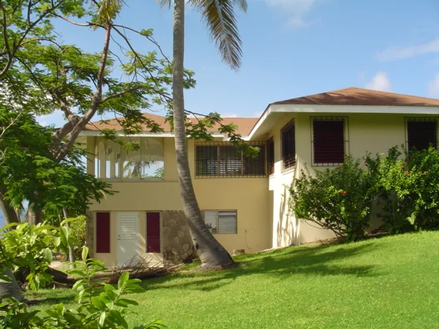

I inherited a house in the Caribbean on the island of Montserrat, now that is where I could really use solar! I have a large south-facing yard and plenty of south facing roof area too.
The barriers there are the 100% import duties and shipping costs - everything is boated in. Also, the utility is run by the government and they have not gotten up to speed on net metering. They have wasted millions in grant money from the UK on geothermal wells because the island is volcanic. If put into solar, everybody would be reaping the benefits by now.
I have been telling them that since 2005 when I inherited the house, alas.
