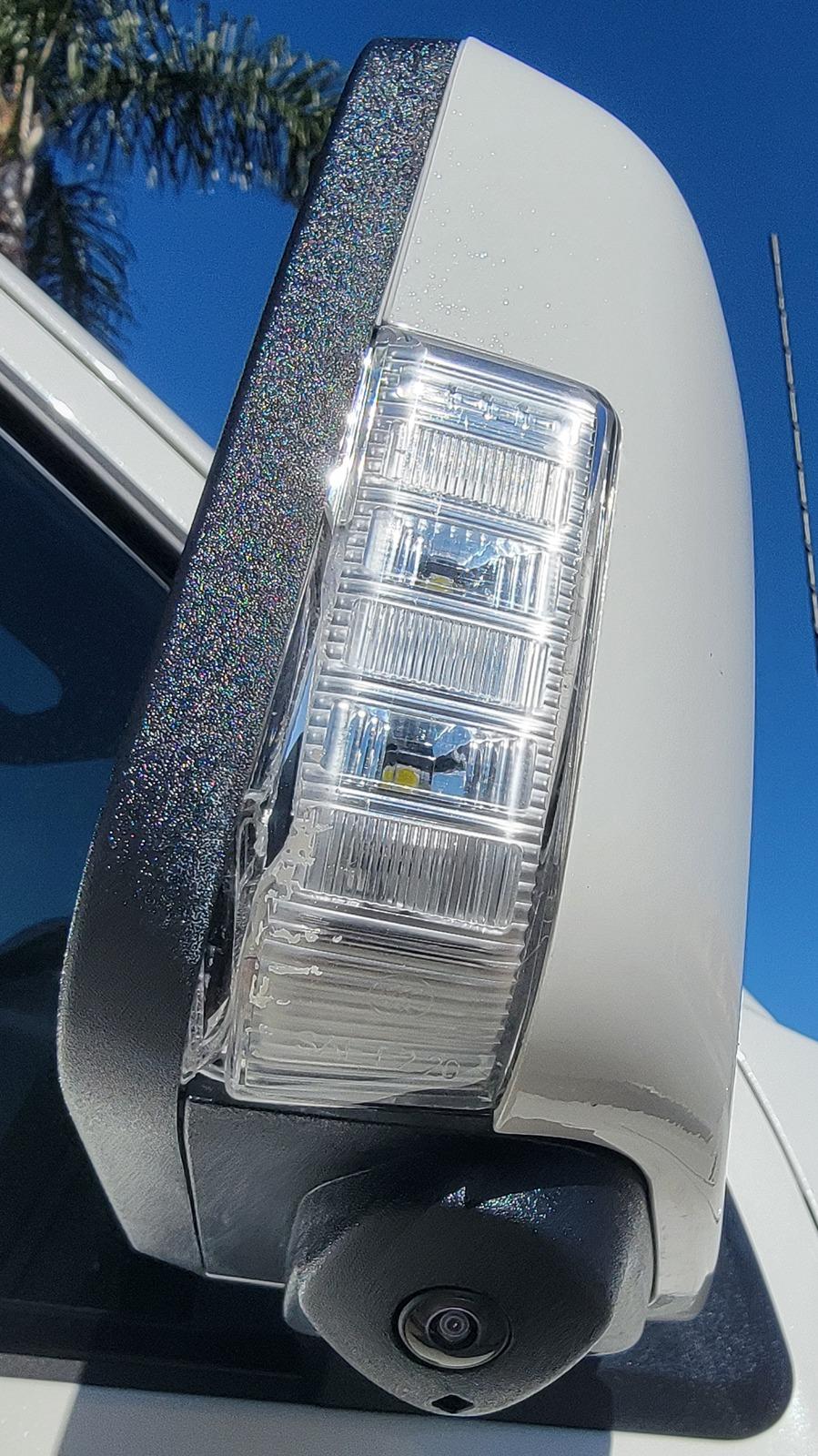

Mine has a cracked right side turn signal, I found a manual folding mirror for $159 on Ebay that I was going buy just for parts. Just not sure if I can take it apart and get it back together, do you know of a guide to do this?
It’s the same as the ICE F-150, and really easy to do.
You can YouTube a video for any guide, the tow mirrors install guides are helpful.
Short overview:
Pry the plastic off using a pry tool. Be gentle, don’t break the clips.
Unscrew 3 nuts.
Unplug mirror.
Remove mirror.
Execute in reverse.

Any update on this? I cracked my turn signal backing out of a side by side Tesla spot (fit on the way in but not the way out). Passenger mirror just caught the Tesla ev charger sign. It still works but I am concerned about water penetration. I'm also moving to the desert so if it's a pricy fix I'll put it off til I see rain reliably again.

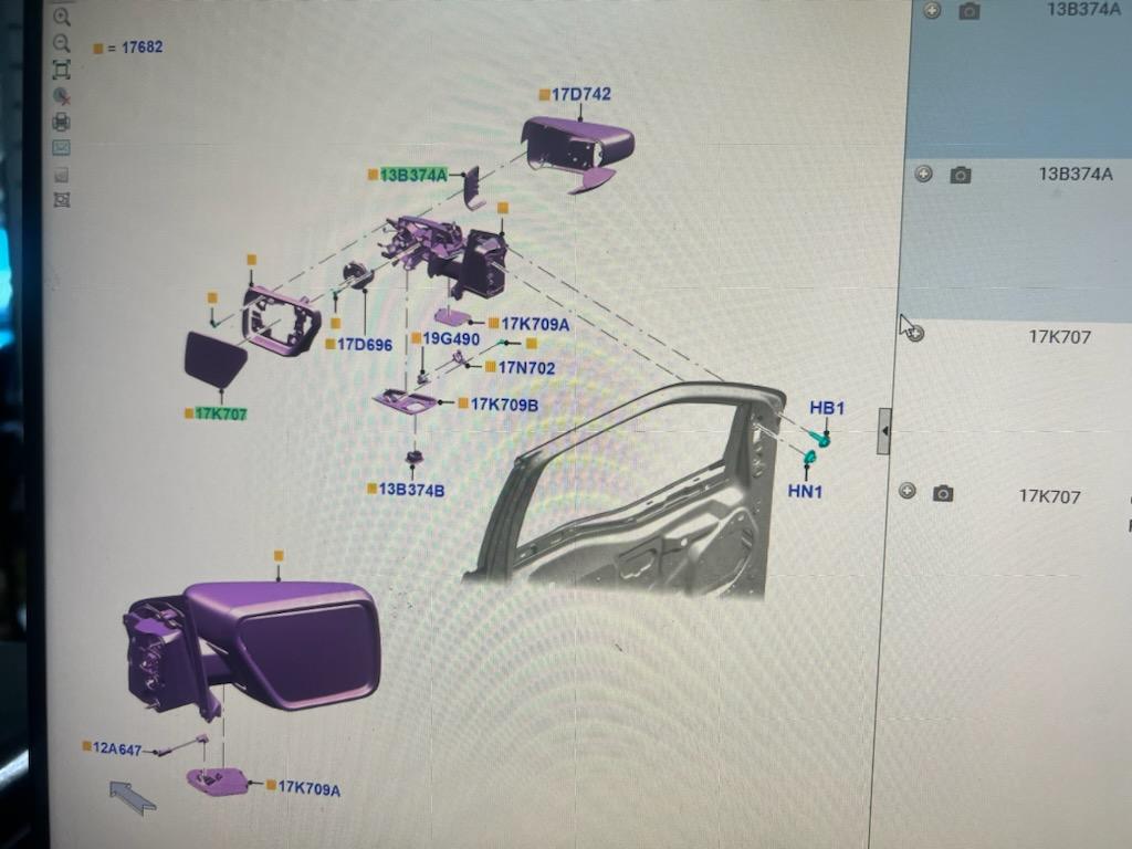

Anyone know the part number and/or how to order this part?
Ford F-150 Lightning Sad Day Broken Mirror.  OEM mirror replacement =  $1,200! Less expensive options?? 82241-de85cf9c686d115719fc7eab63a1e88a copy

You can’t order the frame. When I broke mine I bought a mirror off of ebay and rebuilt, pretty easy.
