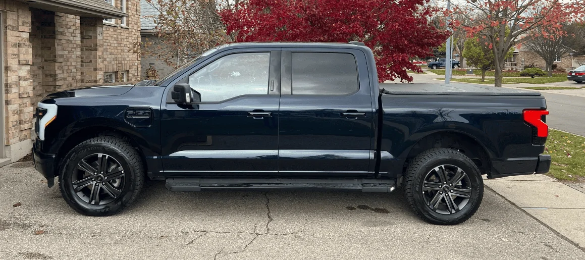

I try not to offend, however, I'm a bit opinionated on this one. Why would you uglify your beautiful Platinum Lightning with steelies when you can find a nice, new or nearly new pair of factory take-offs? Run factory 18" or 20" with snows and at least it looks decent and the price is nearly the same.
My winters are on 2020 20" black factory takeoffs that look decent (to me) and I paid just over $100/wheel. They are readily available and the price is about the same as setting up with steelies.
If you have a dark horse, one of my fellow Canadian Lightning owners did this with his winters with recent ICE wheels. Looks really good IMHO.

Those wheels look great on your truck! Wish I could've scored my wheels at that price too!
To be fair, he paid more for his wheels than I did for mine (mine are the black 2020 20" in my profile pic), but I'd have paid the difference for these ones.
