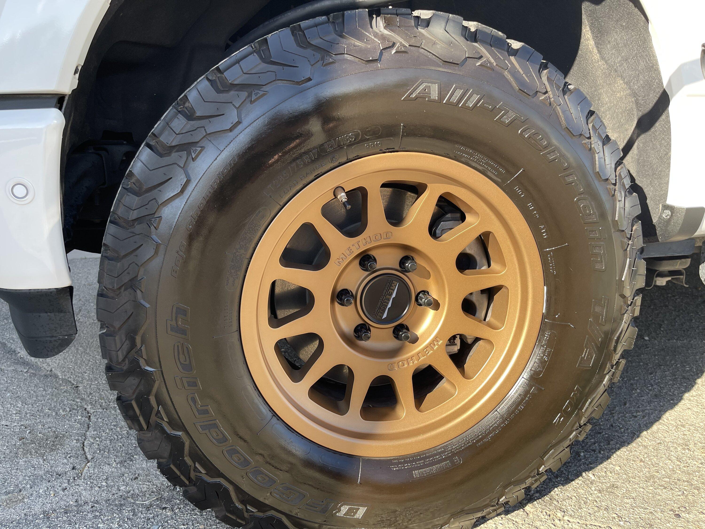

AZT9
Feb 6, 2022
604
995
Peoria, AZ
BFG AT KO3 285/75R 17
METHOD 17x9
Great tire for the truck with the right load rating. Range hit is real tho.
