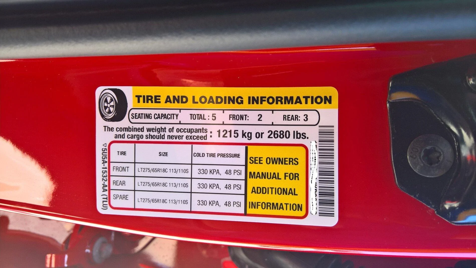

I understand the payload rating of 2120 lbs is less relevant and the actual true payload is on the door sticker. For me 1538lbs. I've been told there is no reason to upgrade the suspension for this camper until after I have it on and see how it handles. I will of course upgrade to 10 ply tires beforehand.

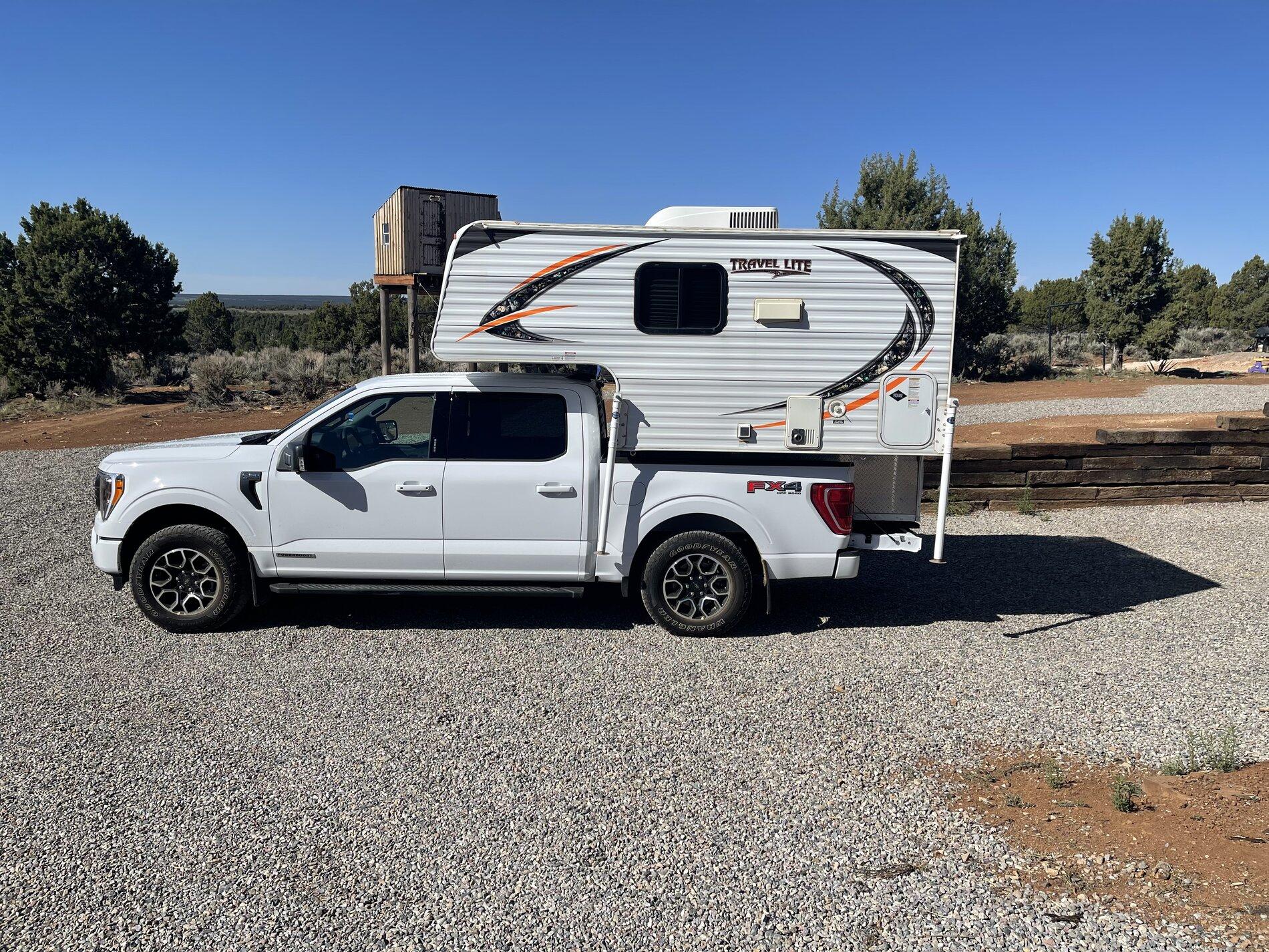

I just sold my life long slide-in friend when I tried to make it work in my PB. Center of Gravity way off even though the truck supposedly had the load carrying capacity.

I'm just guessing, but that truck probably has ~1400-1500lbs Payload capacity.
Why do you think it supposedly had enough for that camper? Not to mention it does look like it's for a longer bed.
1/2 tons have a small selection of slide-in and 5th wheel campers that match up mathematically. (unless you have an HDPP package)

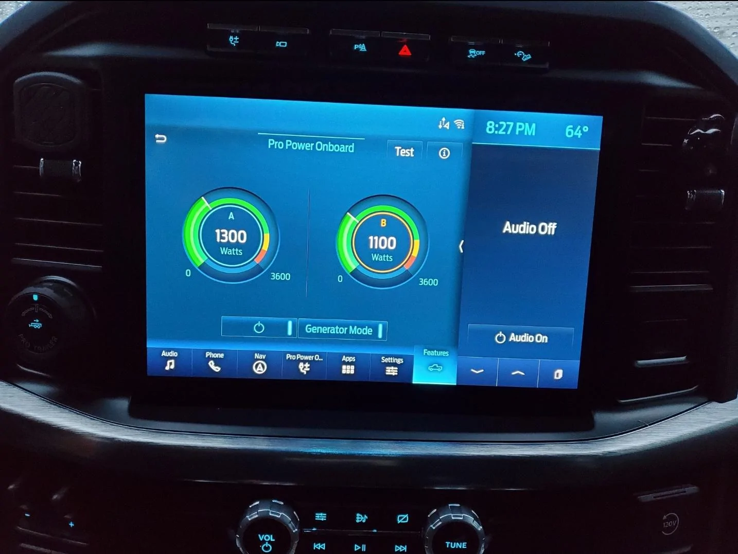

I powered my house, all lights on, can't remember if i did washer and dryer, oven and all that (left AC off for this test). I basically turned on every light I could in the house. Every ceiling fan, the detached garage.
I have two fridges, one in house and garage, both on. Normal stuff. It's 3000 sq ft and I had TVs on, too. Bigger ones.
I didn't get close to maxing out. I imagine a smaller camper would be okay with 2.4kW, but 7.2 is where it's at.

It looks like that slide-in is for a 6.5' or 8' bed, not a 5.5'.
Just trying to illustrate “What not to do”. No way was I ever going to try and make this work. Camper fit nice in the 2018 F250 8 foot bed. Camper made by Travel lite and weighs 1150
Ahhhh. OK, makes more sense now. :)
That camper WOULD work with an HDPP F150. But Ford won't let you have the Hybrid drivetrain in it, although you can get the 3.5 Ecoboost. And now they limit you to XLT trim. I think they unofficially want to discourage us from ordering one. Preferring us to step up to the F250.
With the HDPP F150, you would still have 1500lbs of Payload AFTER you slid that camper into the bed! (my apologies to those tired of seeing my brothers Payload sticker)
