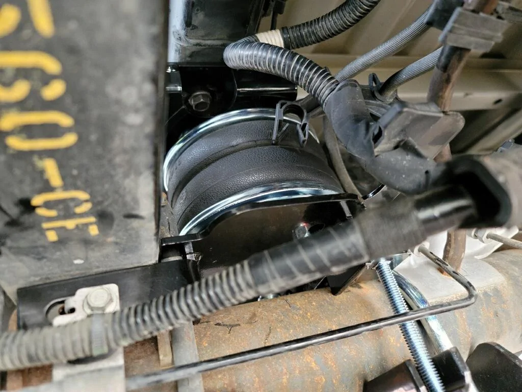

Don't know if it has been addressed, but there is an installation issue with Airlift PowerLift 5000 airbags on PowerBoosts. I have a phonecall scheduled with AirLift Jobber department and they are going to give me the full skinny on the issues. More to come on this topic. The initial report is that there is a clearance issue with the PB fuel tank and the airbags.
A few weeks ago, I ordered p/n 88355 as it was the kit listed for 2021 F150 4x4. After I received them, I went back to Airlift's website for some installation photos and they now have a subcategory on the 2021 only giving the NON PowerBoost option.

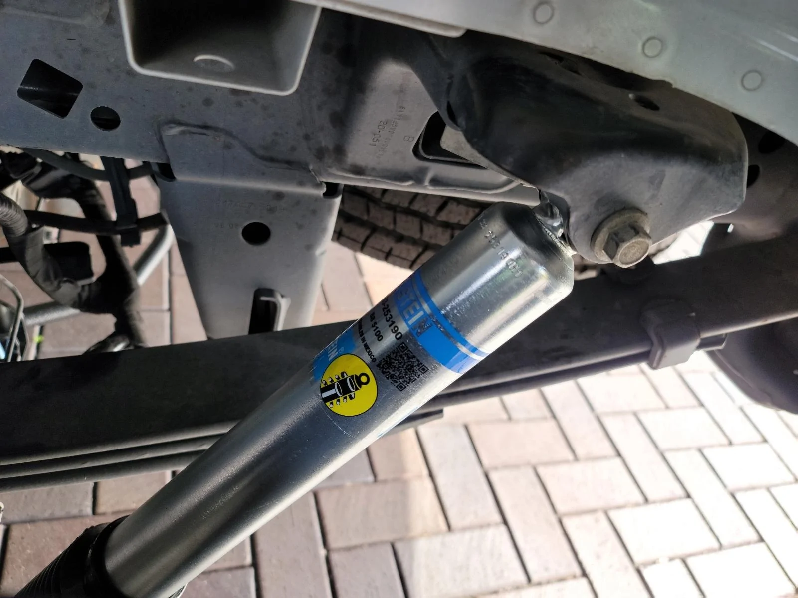

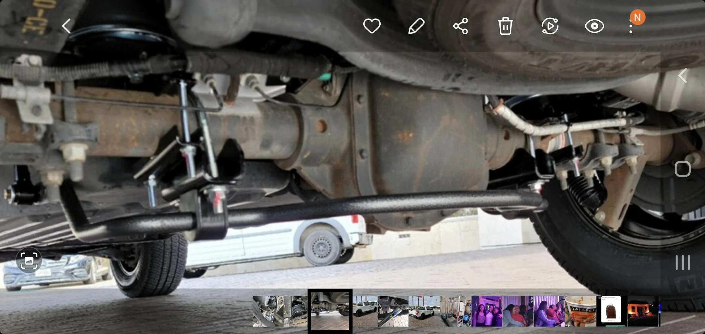

I'm not sure which brand of Airbags we put on our Powerboost in our corporate fleet, but it did get a Helwig rear sway, Bilsteins, Load E tires. We use it to tow an RV to remote airports to provide shelter for Aircraft technicians and power for tools and lights. Basically a rolling aircraft maintenance department.

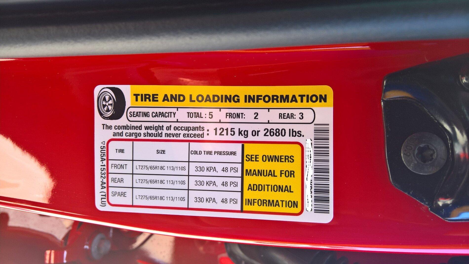

Now I'm being told I don't even need to upgrade the tires to 10 ply right away. So everything the camper dealer told me about prepping the truck is actually more about how it feels after I get it and see how it handles
Several tires places have told me the 4 ply OEM tires are rated more than enough along with the payload rating being more than enough. So hopefully the stock Powerboost will be enough to go get it and bring it back home and I can take it from there.
1538 payload rating, 870 dry weight camper with maybe 200 pounds of stuff so I'm not even at 70%.

With the HDPP F150, you would still have 1500lbs of Payload AFTER you slid that camper into the bed! (my apologies to those tired of seeing my brothers Payload sticker)
