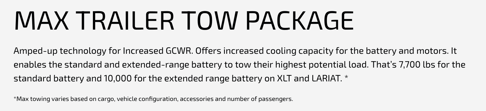

Ford F-150 Lightning SR towing capacity 1711556394962-b
according to https://www.ford.com/trucks/f150/f150-lightning/features/towing/ you are good up to 7700 pounds, and 10k pounds if you have the Max Towing feature (tow tech is a totally different feature)

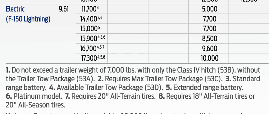

Actually, that's marketing fluff, this is your better guide:
Ford F-150 Lightning SR towing capacity 1711556657070-jc
This indicates you're not so fine and would be exceeding your towing recommendations unless you have Max Tow (referred to in this guide as "4. Available Trailer Tow Package"
You're talking about exceeding the recommendation by 40%, that's quite a lot and I don't think I would do so in my own truck.
This guide is here: https://www.ford.com/cmslibs/conten...cpo/pdf/2023_Ford_F-150_Towing_Info_Dec16.pdf Lighting screenshot above is on page 6

Ford certainly doesn't make it easy!
According to the Ford site, there's a number of packages and they aren't clear which one a Lightning owner might have just on the text description:
"only the Class IV hitch (53B), without the Trailer Tow Package (53A). 2. Requires Max Trailer Tow Package (53C). 3. Standard range battery. 4. Available Trailer Tow Package (53D)."
Class IV Hitch (53B)
53D appears to be Lightning specific. Maybe this is the Lightning Max Tow package? I thought there were other tow packages besides the max tow package when I ordered but mine is a '22.
See if you can find whether you have 53D on your build sheet, which would give SR a tow 7,700 limit.
