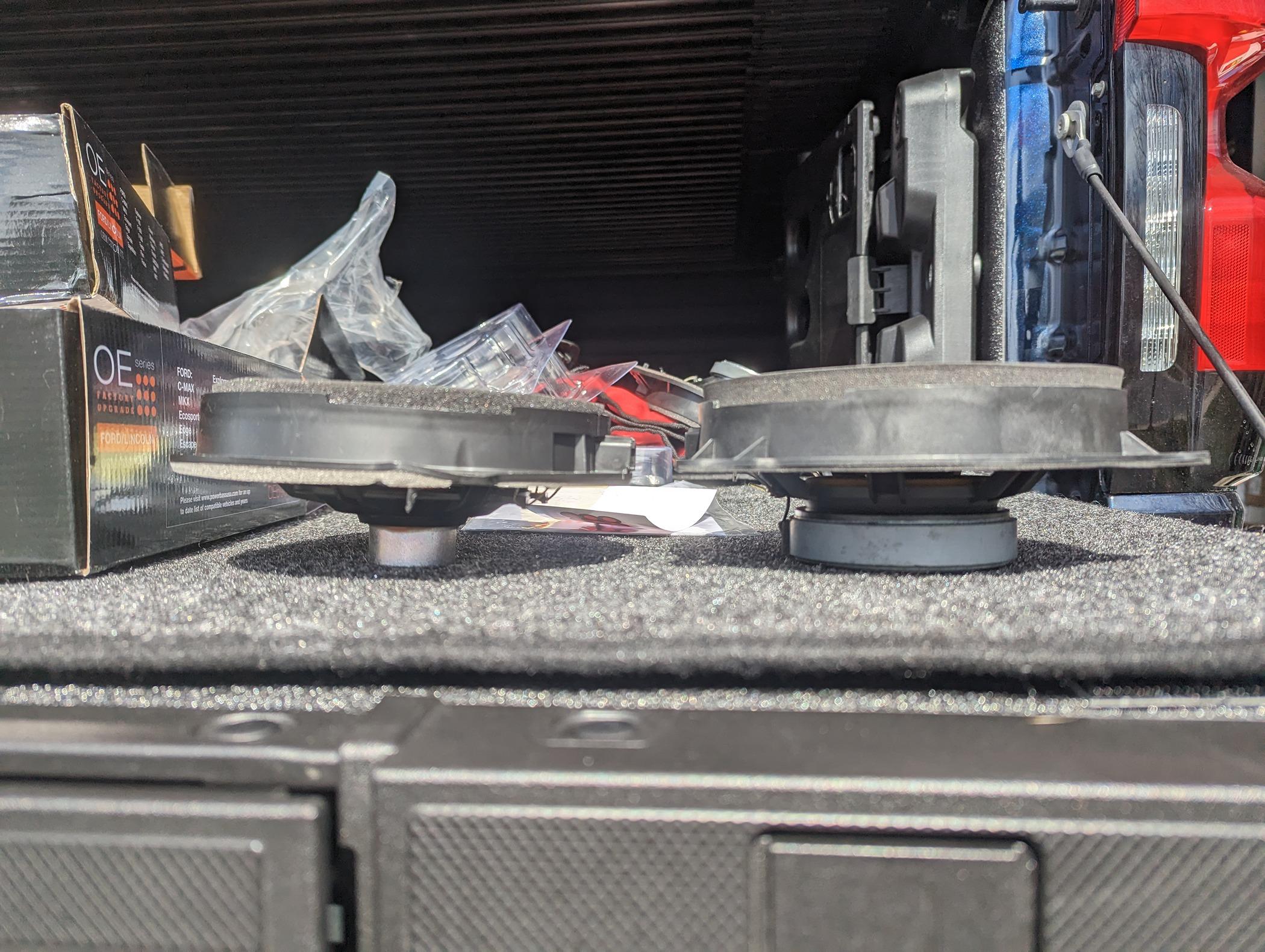

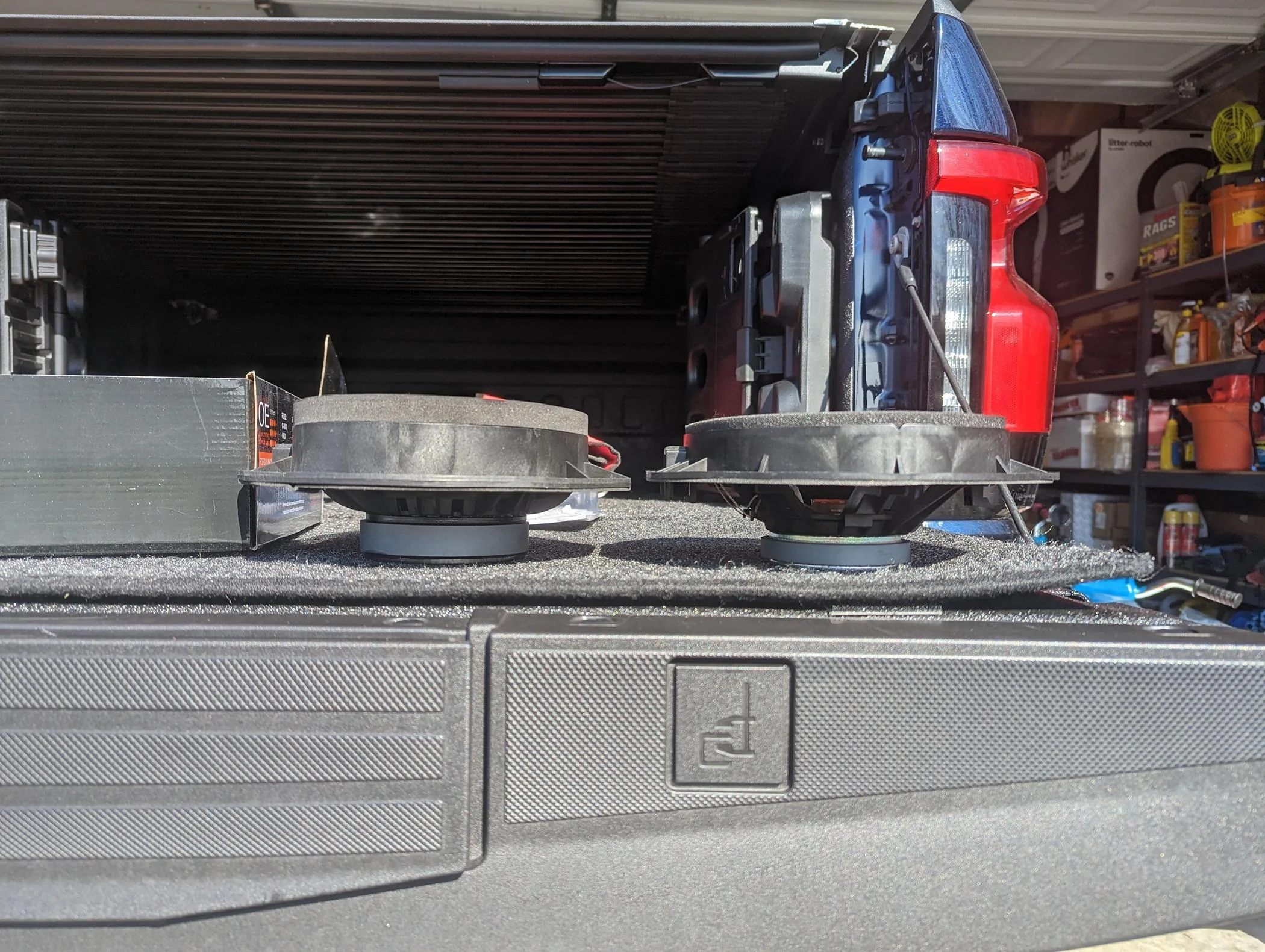

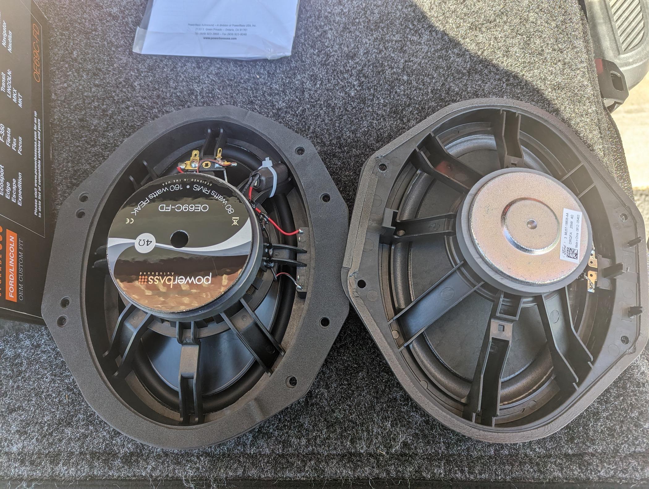

I debated posting those myself. It was so funny, seeing them side by side, how small the factory magnets are.

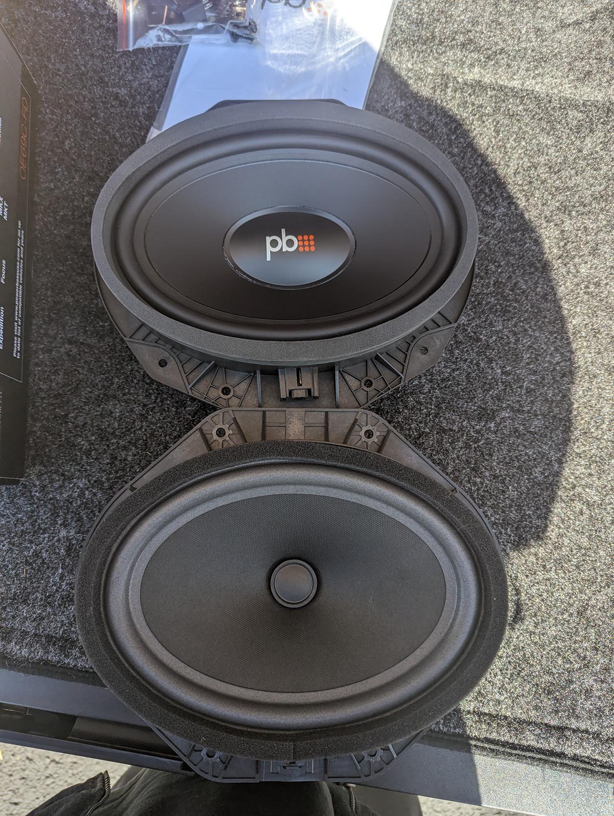

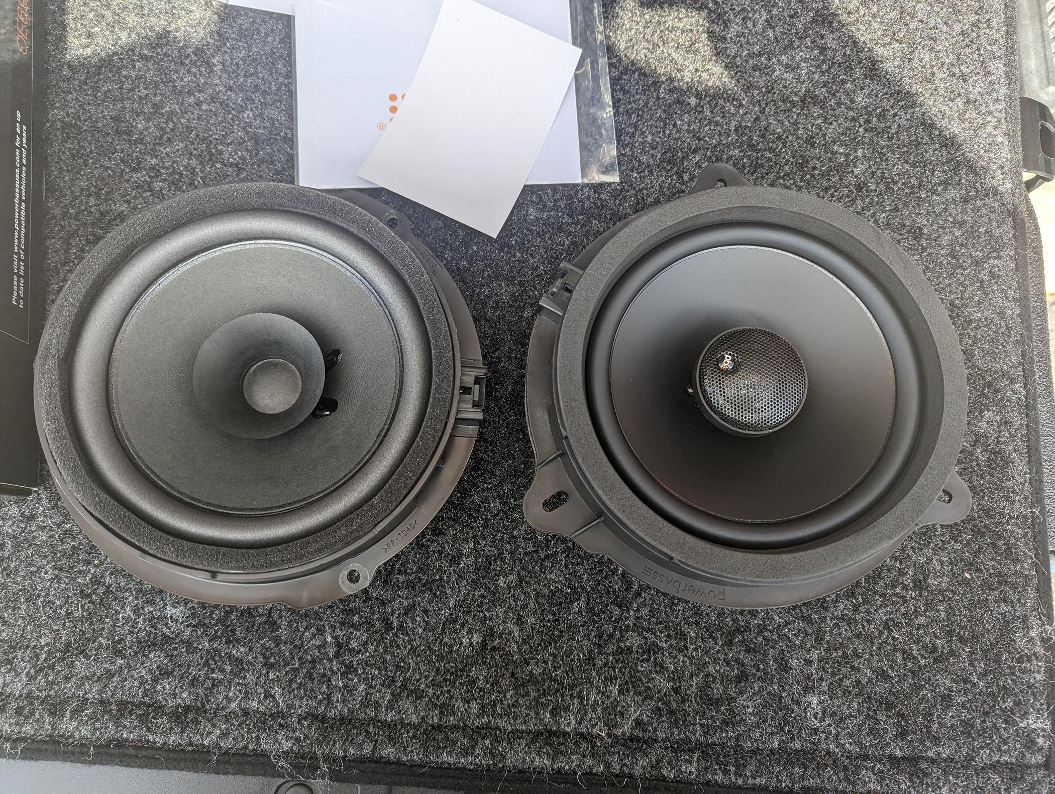

Here are some pics i took comparing the powerbass speakers to the OEM speakers.

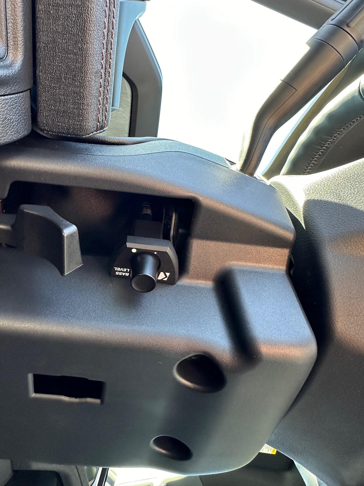

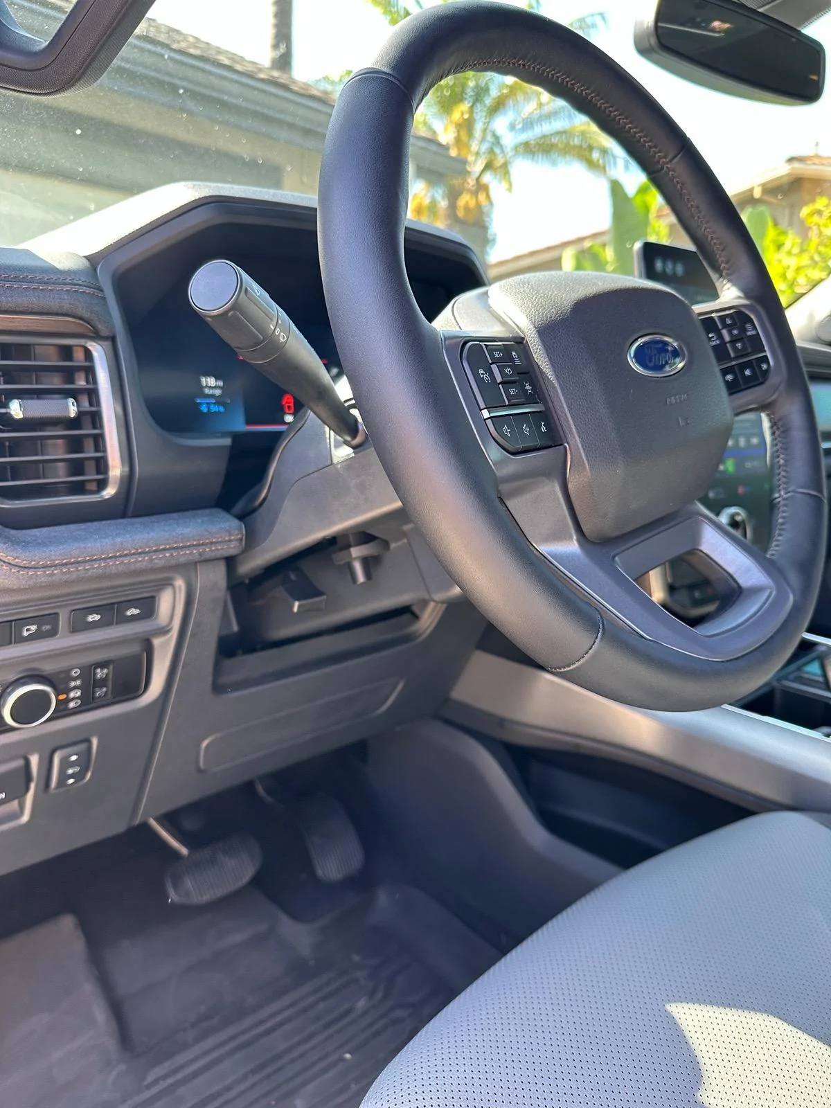

I installed the bass knob on the steering column. It’s completely discreet and super easy to control from driver side.
Interesting. Do you have a picture? How did you mount it?

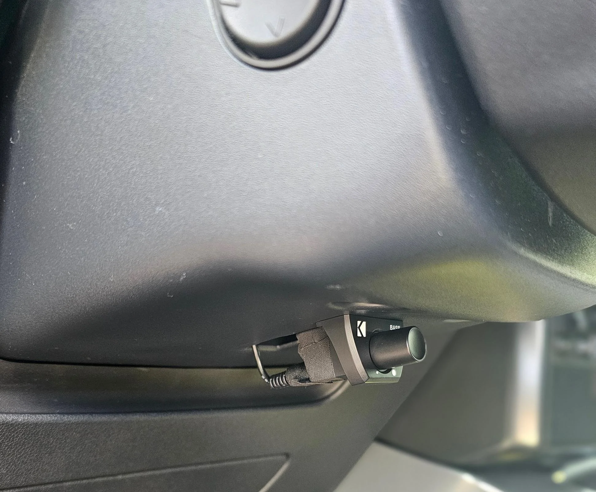

Here is a picture of my bass knob that came with the HS10. There is a square hole under the steering column, so I ran the wire through that and screwed the knob housing into the plastic. I used some loom tape to ensure the wire doesn't unplug. It is easy to reach underneath the steering column to adjust the bass as needed.

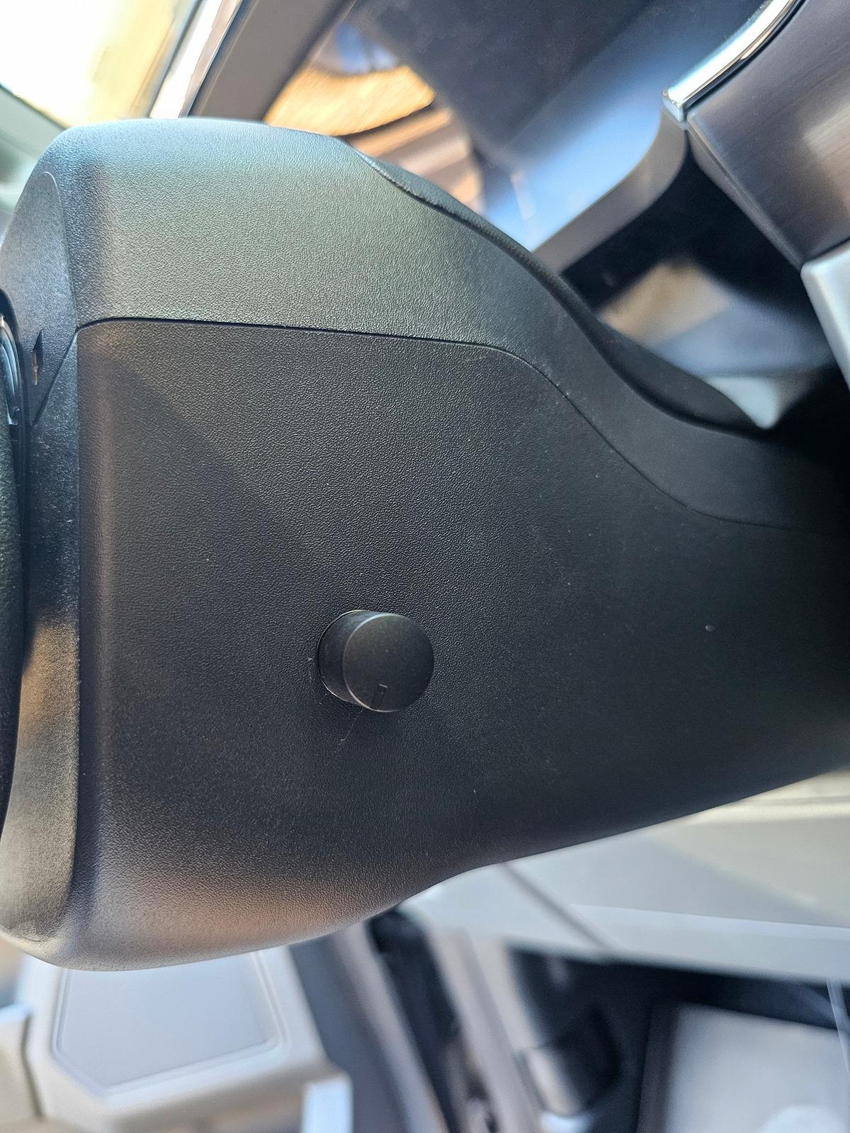

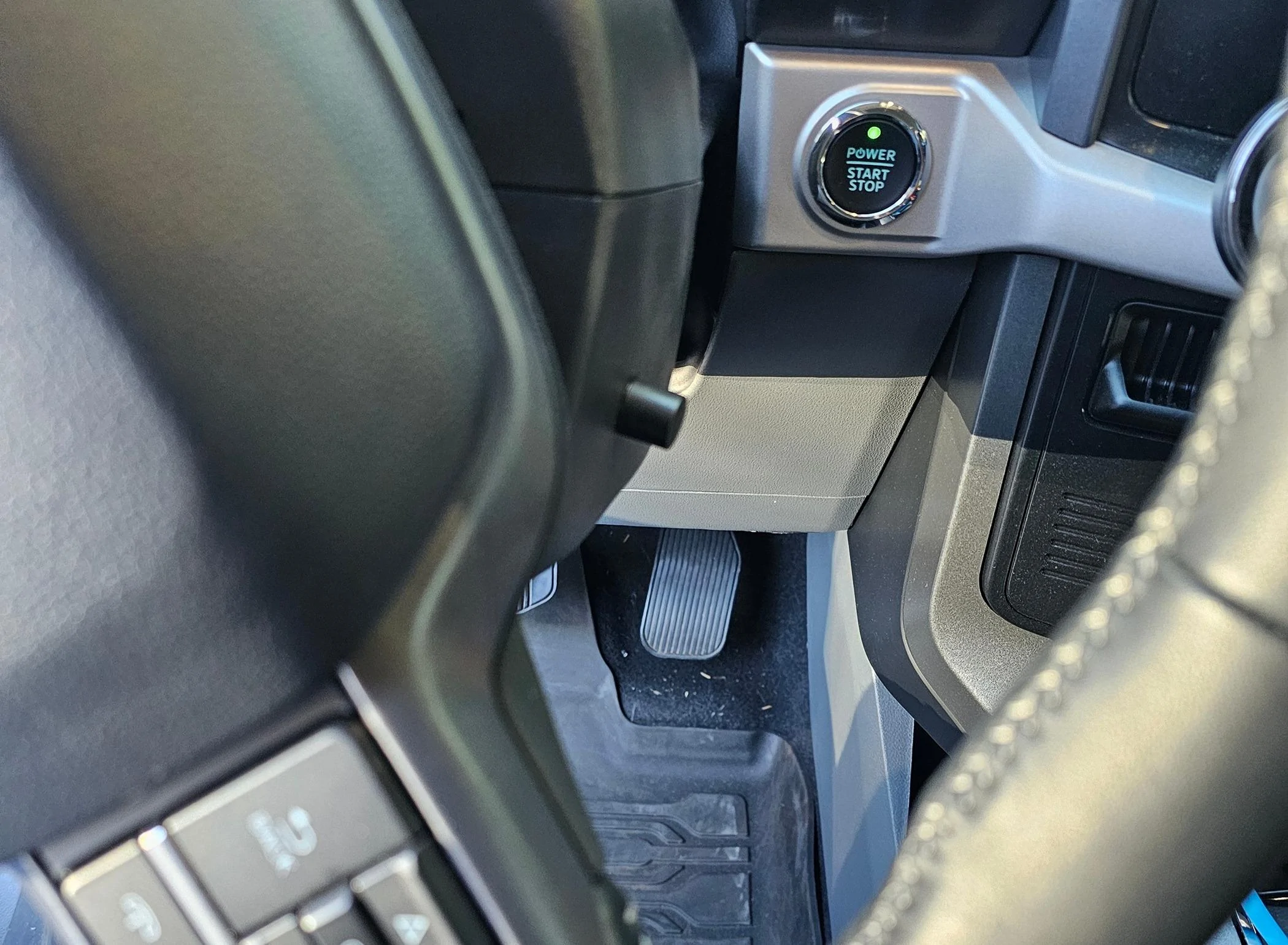

Here is my mount with the RBC-1.
Ford F-150 Lightning Upgraded Audio Project (non B&O) 20240625_094429
Ford F-150 Lightning Upgraded Audio Project (non B&O) 20240625_094632
