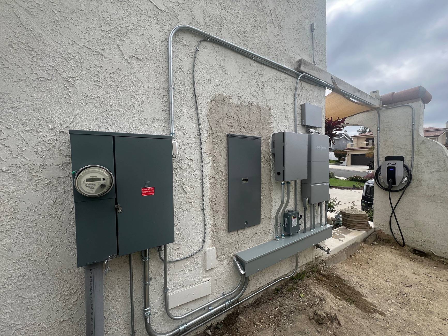

there isn’t much equipment to allow your car to charge, but a lot more equipment for the v2H capability.
The backup system can only pull 9.6KW so my subpanel (in photo with the stucco around) has the backed up breakers. Within other boxes are inverter, automatic transfer switches, physical cutoff switches for safety. And I also have solar so at least one extra component for solar cutoff.

attached photo that is my version of the schematic.
