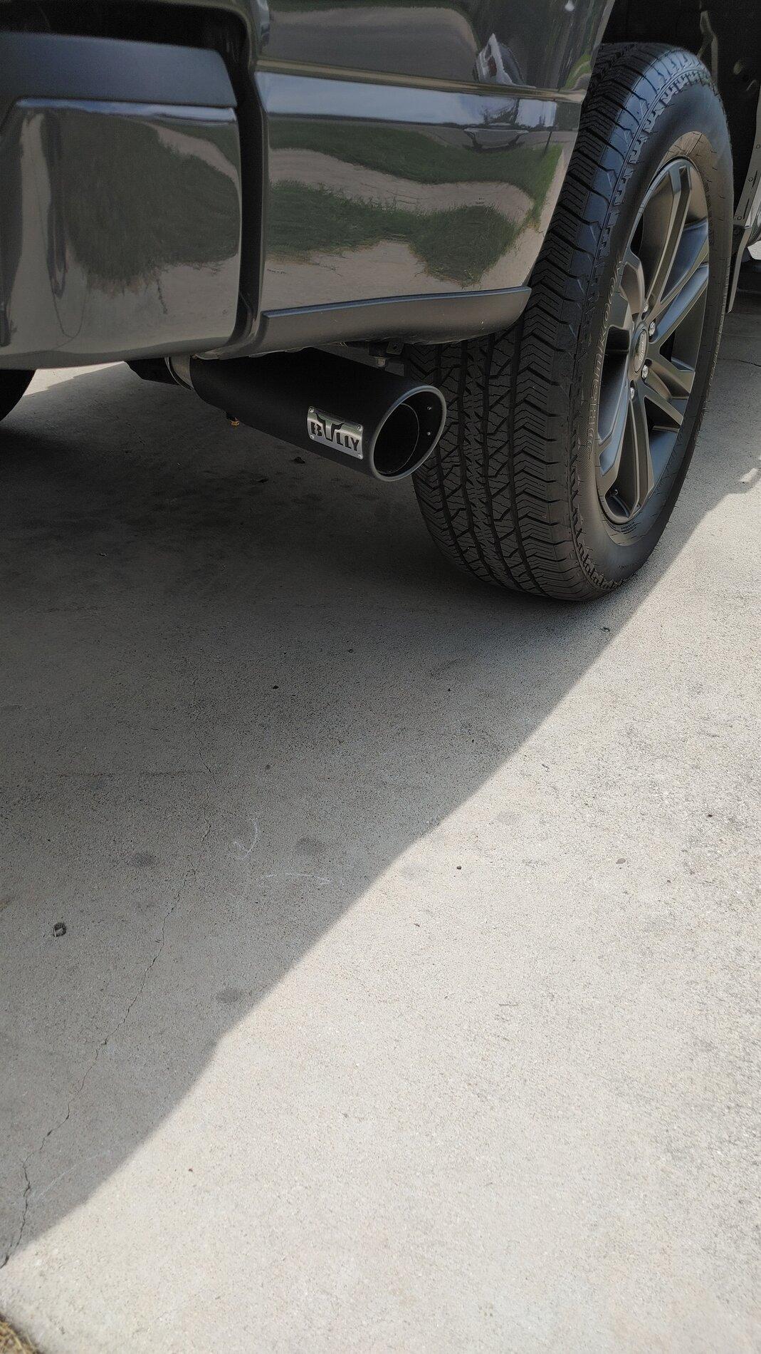

I actually bought a 3" clamp on a while ago...only to find its a little too small.
For $50 Can this Bully will do just fine
