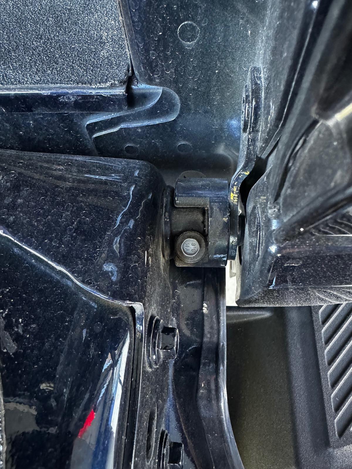

Not that you need another example but I also have a retainer bolt there.
Ford F-150 Lightning Tailgate fell off, lol IMG_1079

Well dang I have a set screw too. Seems like maybe it was forgot if the tailgate was ever removed for bedliner. I'm glad for this thread,,sorry for your damage for sure. I've never seen a set screw either on a tailgate and if I had to remove the tailgate, this would have driven me nuts figuring out;)

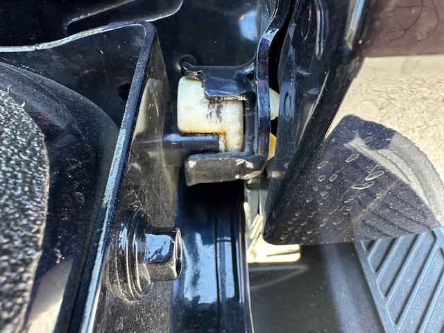

You were so focused on making the condescending post about being a “first truck” that you missed the point of my thread that I am trying to determine what parts are missing. I’m not sure any certain number of years of truck “ownership” would give someone enough experience to draw the tailgate assembly and parts from scratch without any reference, as noted by your complete failure to miss the gaping hole in my picture where clearly something belongs but I am mot sure what.
My intent was not to be condescending, there are lots of people on this forum who bought this as their first truck ever. I was just trying to add context to the situation, I apologize that it did not come across that way.
Do we know if this screw is linked to trim? Could it be an item where the power folding tailgate has the screw but the manual drop does not?

This kinda freaked me out as I am helping move my daughter to her new apartment tomorrow morning. I went out and checked and the set screw was in place.

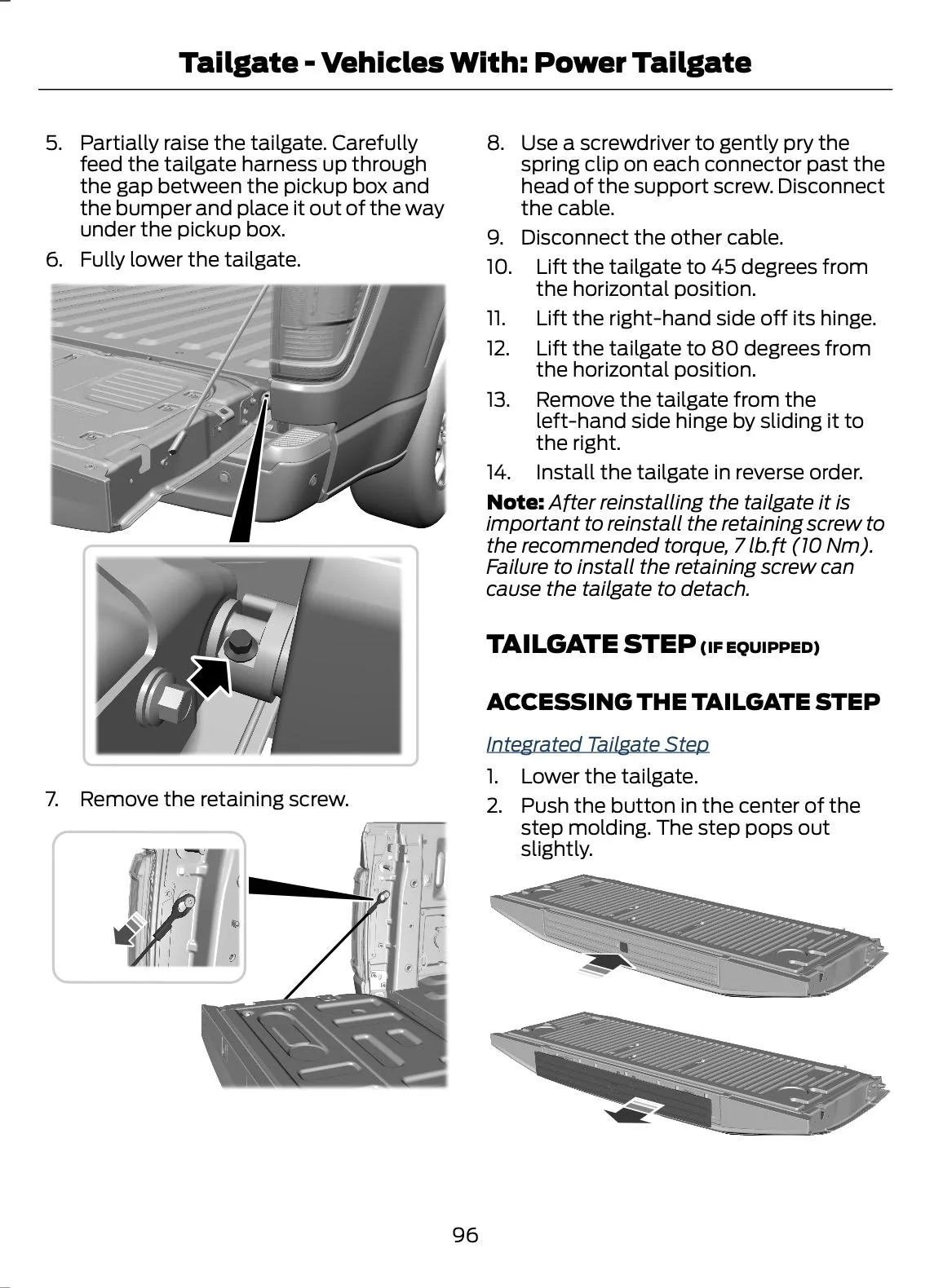

After taking another look at page 91 of Owners Manual about tailgate removal, it does not say anything about taking out the retaining screw for the Manual Tailgate.
For the Power Tailgate (p.96) it does mention the retaining screw.
I looked at my 2023 Lariat and it does have the screw.

That is what I expected to see. It does seem like the OP has a lariat is missing the screw though which is odd.
