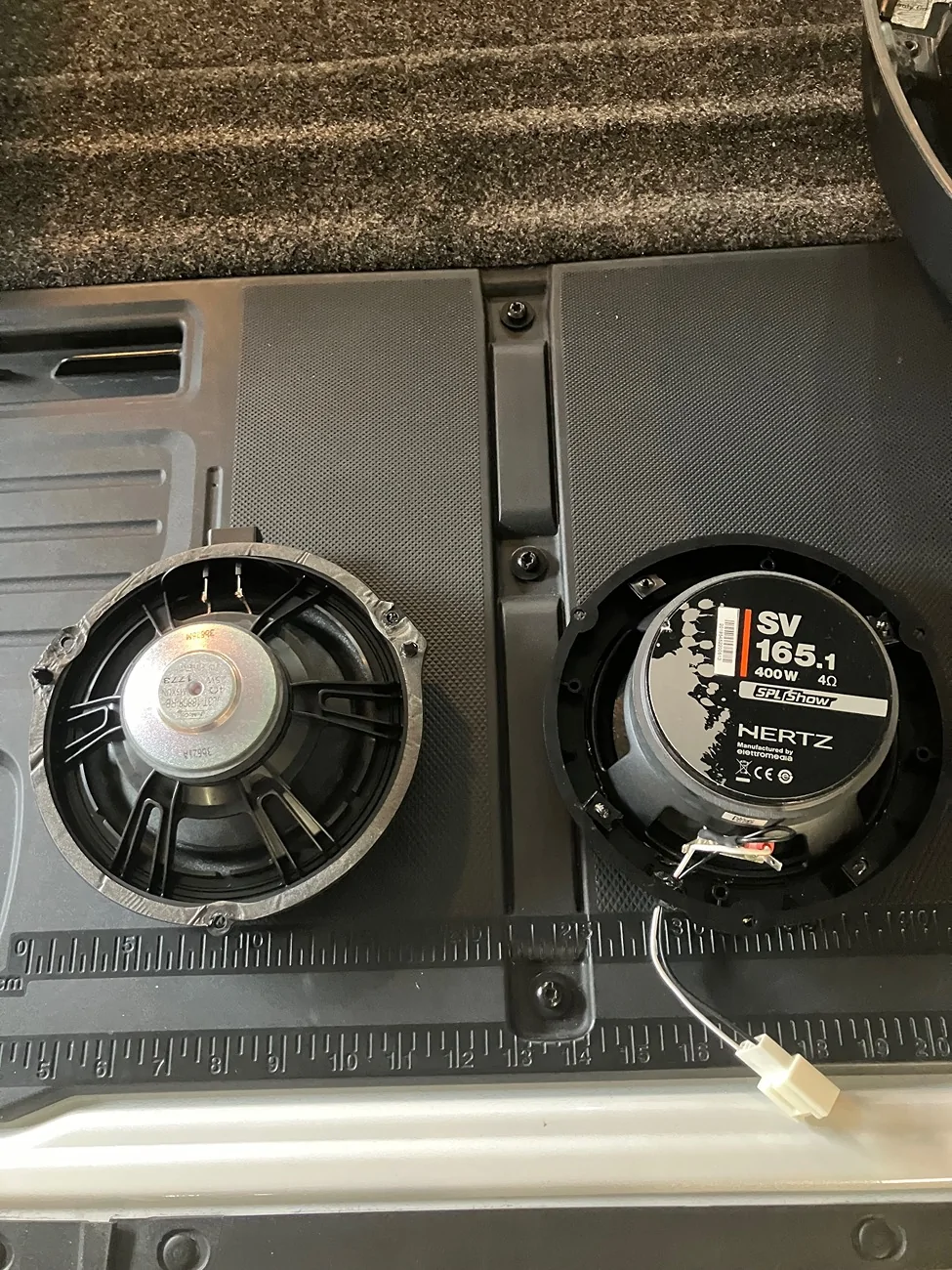

Brad
Jan 18, 2025
Lincoln phev ‘21 & Platinum Lightning ‘23
not anymore
I found that speakers with a higher sensitivity made an additional difference too.
Here’s a Hertz speaker (on right) that I used in the rear doors compared to one of the stock speakers on the left.
Agreed. I swapped out the rear door speakers for a set of low wattage, high sensitivity rated set of components. Mounted the rear tweeter on the door right above where the factory speaker goes and added an in-line filter so the tweeter only gets high range sounds. Did sound deadening behind the speaker, too. I also swapped out the front tweeter and door speaker for a matching set, but that part has nothing to do with the topic at hand.
I also made some FORScan changes to flatten the EQ and tell the ACM and/or DSP (I don't remember.....this was years ago) that there was a rear tweeter now. All said and done, it made a HUGE difference in rear speaker volume. I can clearly hear them now.
