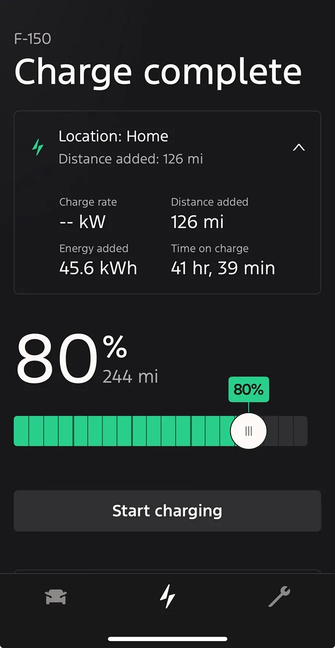

If you aren’t careful with finger placement, easy to unknowingly change the charge level. I kicked it up to 85% three times, only to discover it the next day. Turns out that if I hold my phone in my right hand, my right thumb perfectly placed to move that slider… inadvertently.

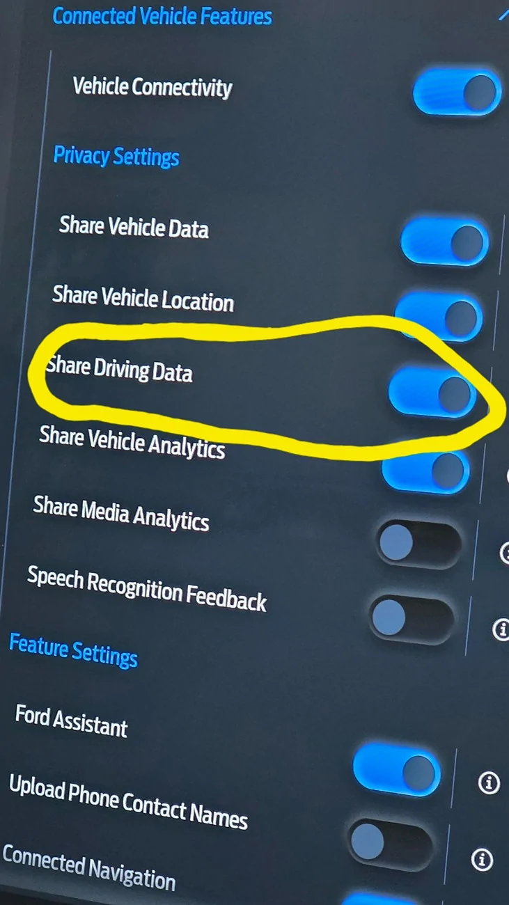

I turned "share driving data" off because I don't want LexisNexis sending my info to my insurance company. ALL other settings are still on. Vehicle analytics, vehicle location, etc. are all on.
It's frustrating, because now the only way I can set a charge target is through the 15" screen inside the truck.

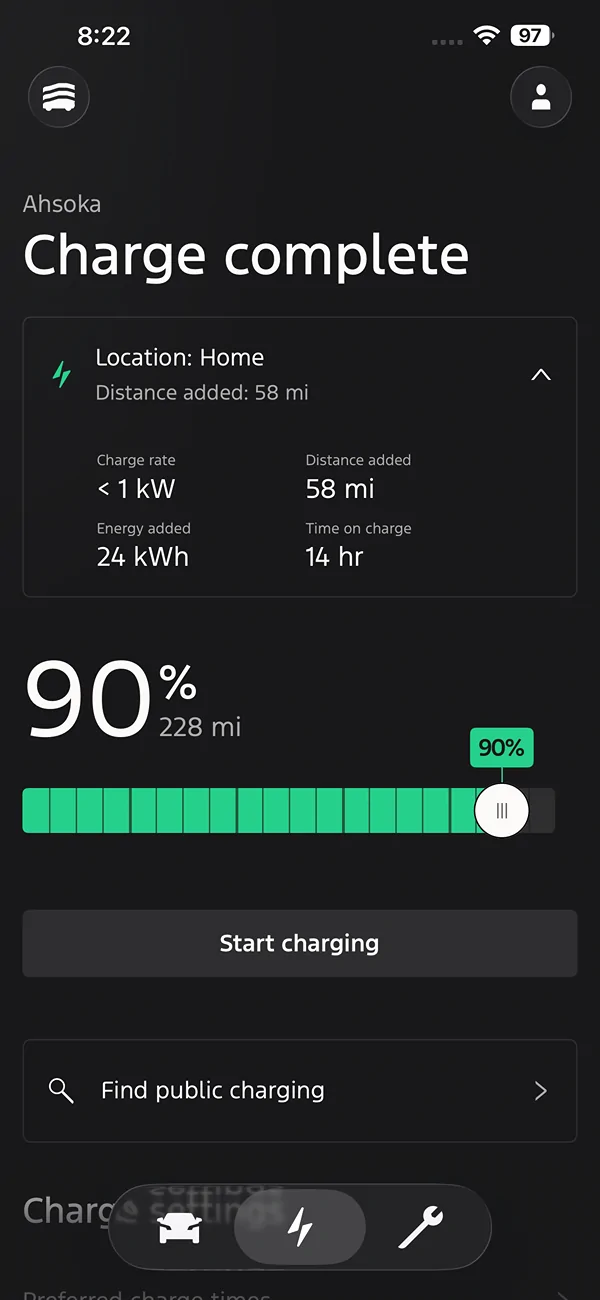

Not sure why some people can’t change it from 90% to 100% but mine is showing I can.
Just for testing purposes, can you turn that last setting one on to see if the missing energy screen functions come back? Mine came back pretty immediately, less than 5 minutes IIRC. Then you can turn it back off if you still think it's your best move, but at least you know what the issue is.
Bottom line is no functionality should be predicated on sharing with a third party. Ever. If this is actually a required bundling in the @Ford Motor Company ecosystem, they've guaranteed this will be the first and last of their product I ever buy.
I will try it. I have no idea what my driving habits should have to do with seeing charge target in my app, but I will try it.
I agree, it's frustrating that Ford really tries to push people toward sharing this personal data.
The reason I turned it off is because I got notice last week that Progressive is doing a "rate revision" on my policy and starting next month my premium is going up $477/annually. When I started digging to find out why, I saw that Progressive uses LexisNexis reporting. I have it printed in black and white. So I've decided I'm turning off every privacy setting I can get away with in both the app and the truck.
