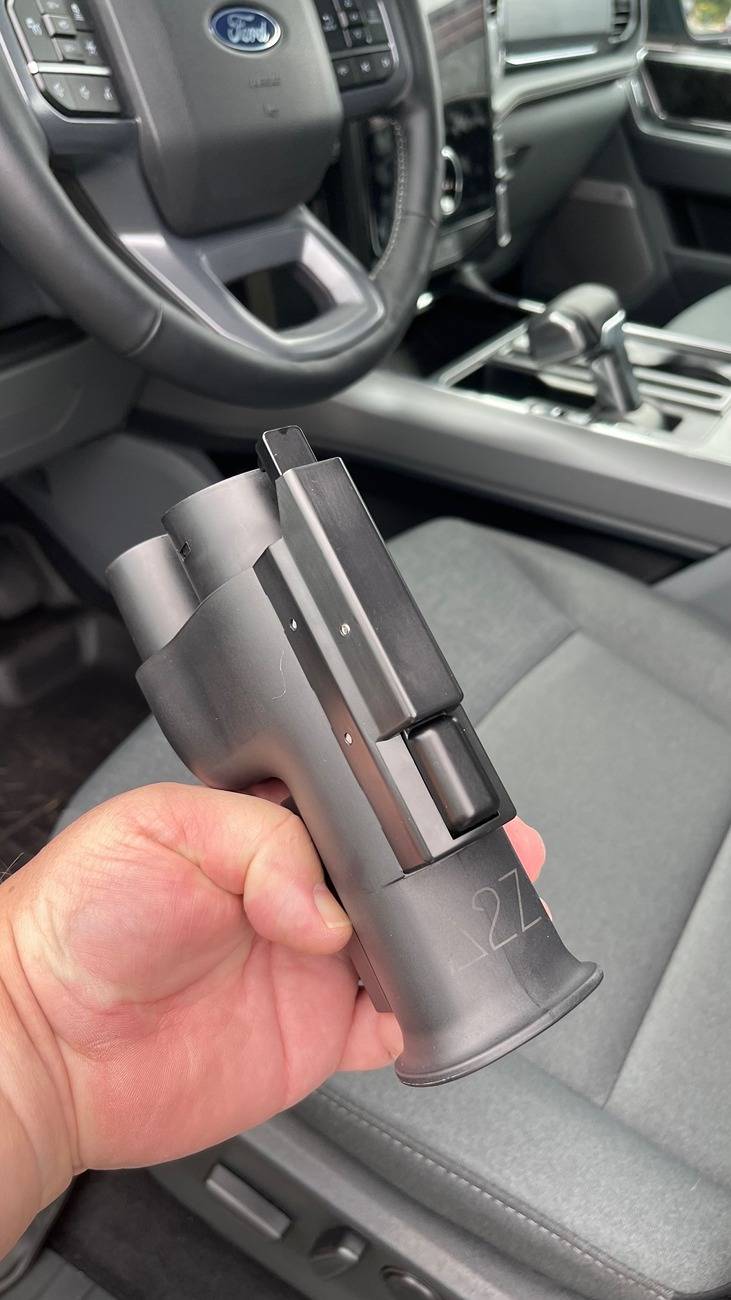

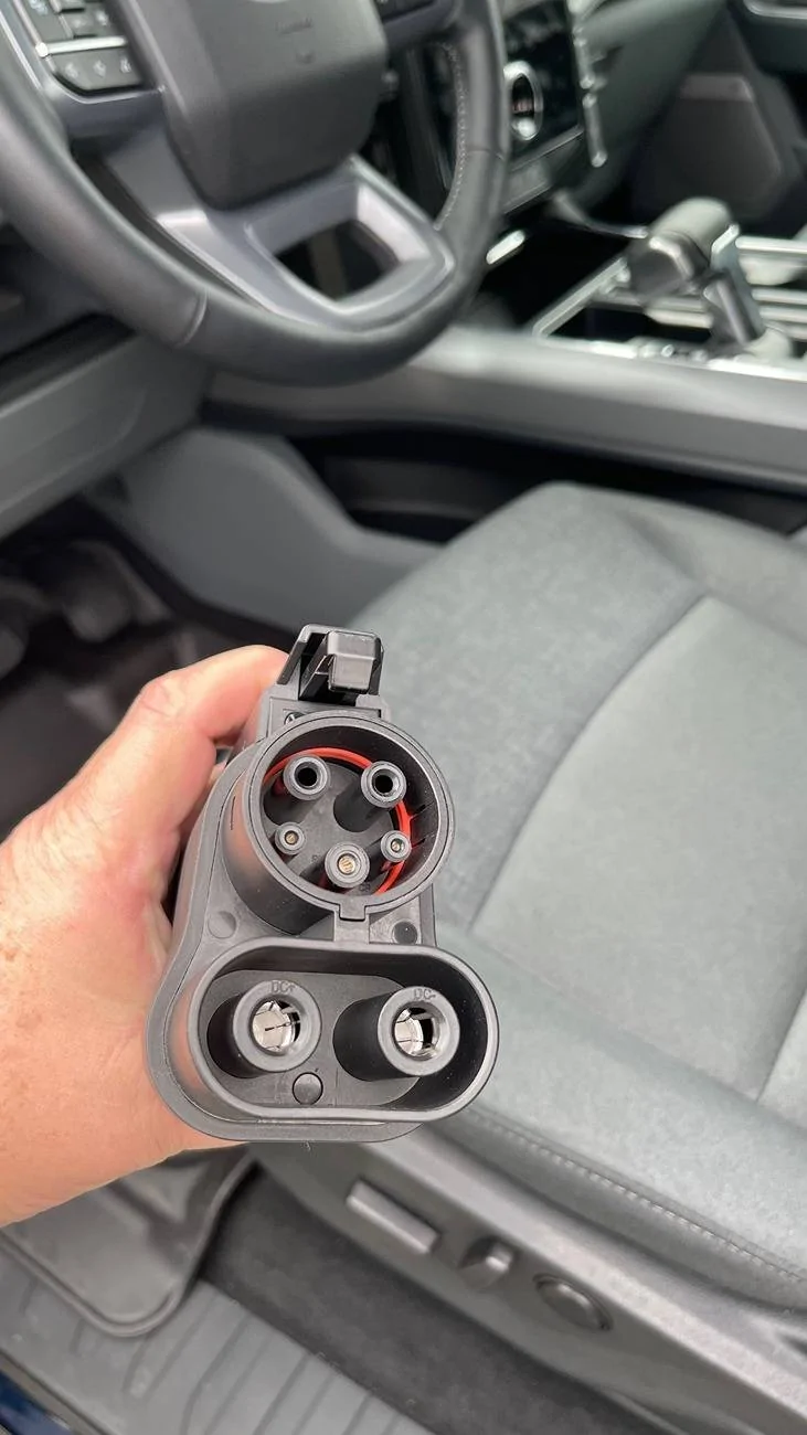

I believe it is the correct adaptor...

What is your order of operations?

That is the correct adapter.
I normally use the Plug & Charge option that Ford has for Tesla and Electrify America. It works every time.

With my A2Z Typhoon Pro, I used the Ford mobile app to activate the Tesla station charger. I did find that I had to really push the Tesla charger into adapter quite hard until I heard the audible click of the Tesla cord locking into place. The first time I put the Tesla cord into the A2Z adapter, I didn't push hard enough, and it gave me an error. The second time I tried after getting it locked in, it charged fine. However, I did notice that the Ford app didn't track the charge even though the app started the charging. The truck itself tracked the charge, so in the end it all worked ok for me.

Not sure if mine is the same model as yours, but I finally noticed the lock button on the bottom of the adapter the third time I tried to use it. Of course, I didn't read the instructions first....I'm a man.
