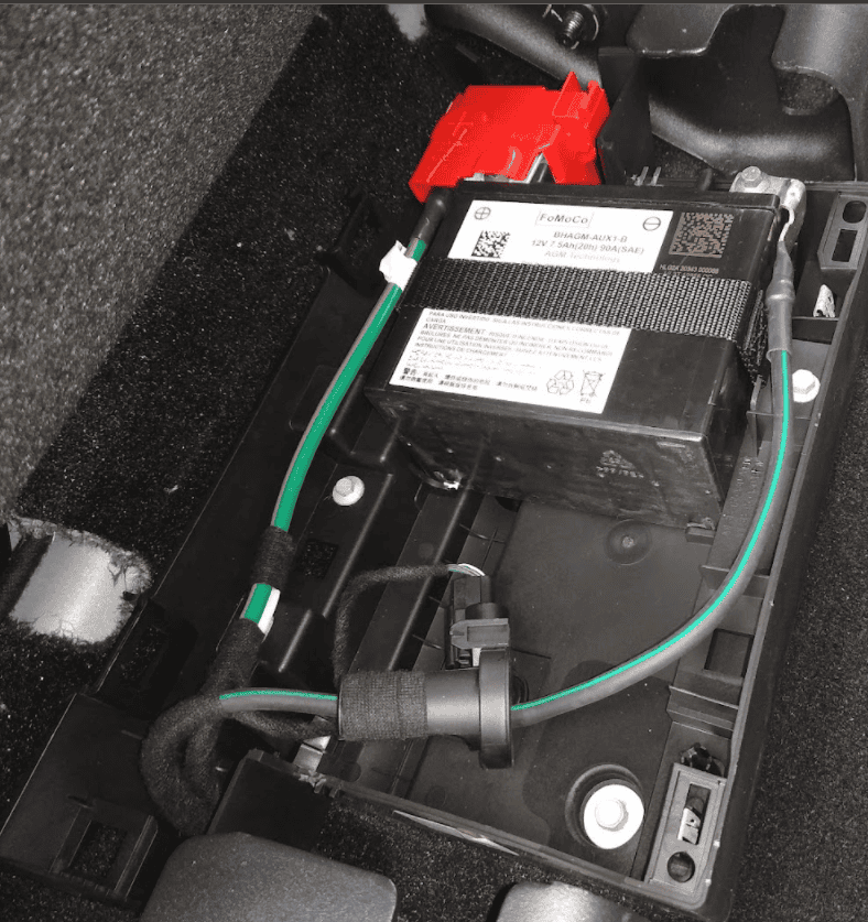

The small AMG battery under the rear seat on a Powerboost.

I want to tap into this 12V battery to run a few low amp things (USB, LED lights, etc). Does anyone see a problem with this? It appears to have some sort of amp(?) monitor on the negative lead. I don't want to cause any problems. The idea for using this is (1) don't have to run line through the firewall and (2) if the main system failed, I could still keep phone charged and run my add on LED flashers in the front and rear.

Electrically this is doable... But keep in mind that this is a "Keep Alive" Battery designed to power just a few key circuits in the truck's computer memory if you de-energize or disconnect the main 12v battery. I had an experience recently. I took my PB in to do a transmission oil change. The tech made a mistake resulting in the truck refusing to start & move. They troubleshot for nearly 12 hours shop time to include de-energizing the main battery to reset the memory. I spoke with the tech's supervisor about what I believed to be the "Keep Alive" battery. So they tried de-energizing that battery also... Voila! All was well and it ran fine. So could you tap into it? Well yes, but that thought makes me uncomfortable.

Thanks. Now that I know what it is used for, I don't want to mess with it.
