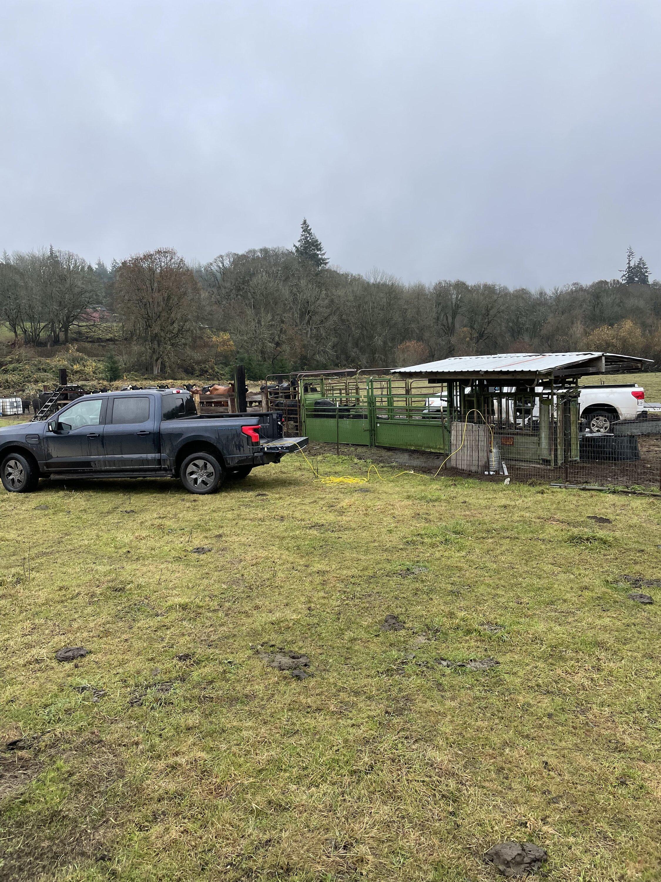

I was running pro power today branding and some other farm chores. I have the timer off but it kept shutting down. Anyone else notice this? Is there any other reason it might turn off?

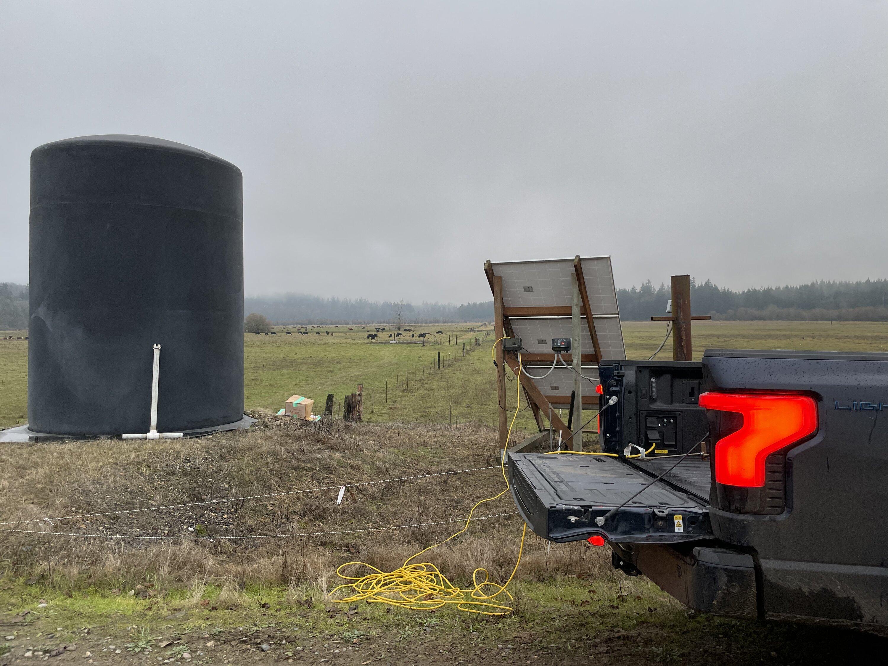

I also wish that pro power could run without the truck on. Currently I’m filling the solar well ( very cloudy this week) and it’s going to be a couple hours in a remote location. @Ford Motor Company i really want to be able to turn pro power on with the truck off for 15 hours or so with just the outlets on.
