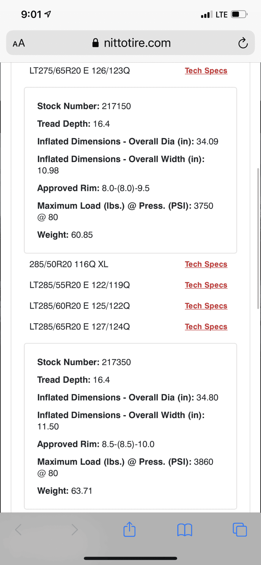

It’s debatable on if a 295/60 or 285/65 is bigger. The 295/60 is 34x11.6 and the 285/65 is 34.6x11.2. So the 295 is a 1/2” shorter but also a 1/2” wider
Also, ready lift says on a 20x9 wheel and the OEM wheels are 8.5 wider.
I’m starting to lean towards the 275/65 and make sure they fit easily. Hopefully they don’t look too narrow.
My biggest issue is that I don’t want any rubbing. Obviously I’d like to get the biggest tire possible, but I don’t wanna mess with any rubbing.

Just had the 2 inch Ready Lift level with 285/65 Ridge Grapplers on the 20 inch OEM wheels installed yesterday. Will post some pictures today for you when I can. I like the height of the 285/65 @ 34.80 inches tall in Ridge Grapplers. Definitely looks to have a little more sidewall vs the 295/60 but both look great.
Pictures added. As many have others said, no rubbing and no trimming.
