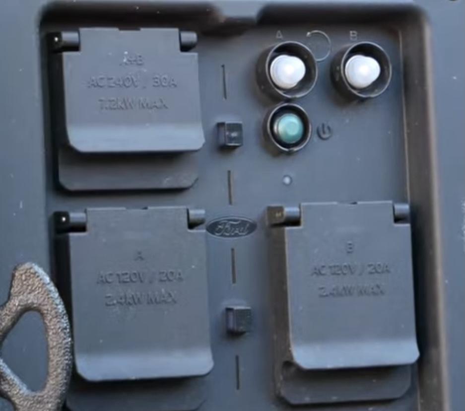

Ordered a Latiat Powerboost with the 7.2kw. I have a 28ft Keystone Hideout bumper pull. My biggest question with the generator is - the 120v outlets are 20amp, but the A/C and electric heater trip 20amp outlets and need 30amps. Only the 240v has the 30amp outlet. The trailer can only take 120v power. Any solutions anyone can think of?

So you are saying you don't have 30 amp 230 plug in on-board

You just need an adapter. 240v outlets are just two 120v poles with 180 degree phase difference. The adapter will pull 120v from only one pole.
Here is an example, but make sure to do your research first so you get the right plugs for your application.
NemaTech NEMA L14-30P Male to TT-30R Female 30 Amp 4-Prong Compact Locking Generator to RV Transfer Switch Inlet Box Adapter
https://www.amazon.com/dp/B08GFQ2WM9/ref=cm_sw_r_cp_api_glc_fabc_3sb2FbA9NDX33?_encoding=UTF8&psc=1
This is incredibly helpful. No one ever explained 240v like that. Thank you!!

the ProPower Onboard has one 240v 30amp outlet and four 120v 20amp (two outlets per receptacle)
I was asking about the power port on the camper.. a camper that size should have a 120v/30amp plug in .. which goes to a breaker panel and just like your home, divides the power up to 120v. its basically plug and play...it may need the adapter, I have both .. as I have been to campgrounds that only run 30amp, where my camper is wired for 50.

I was asking about the power port on the camper.. a camper that size should have a 240v/30amp plug in .. which goes to a breaker panel and just like your home, divides the power up to 120v. its basically plug and play...it may need the adapter, I have both .. as I have been to campgrounds that only run 30amp, where my camper is wired for 50.
I've never seen a camper with a 240V plug in! Is it from another country? I don't know where they would plug in around here as every pedestal I've ever seen is 20A, 30A, or 50A plugs at 120V.
