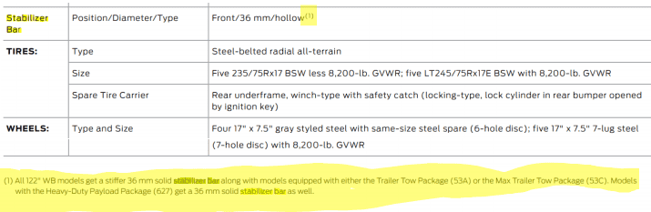

BoilerTimmay, I'm looking for the Ford link to it. That information compiled doesn't look entirely accurate.
KTMADVRDR, it could be the 5.0 Coupled with the 3.73 E-Locker to get the regular 9.75. Hopefully just how that breaks down gets ironed-out in all this too. Either way, I'll report what I ended up with when I take delivery as I tried going the individual option route.
More on the Stabilizer Bar. 36mm seems to be the 2015-2020 F150. So, if anyone that already took delivery would go measure their's that'd be cool. It seems there is indeed a hollow and a solid (slightly larger OD), but just which one ends up on which tow package is a mystery. It could be the reason for that warning though:
Do not exceed a trailer weight of 7,000 lbs. (3,175 kg) or 36 sq. ft. (3.4 sq. m) trailer frontal area with only the Class IV hitch (53B), without the Trailer Tow Package (53A).
It also seems they are swappable. If I get bored enough, I'm going to go crawl under more trucks at the dealership and take some more pictures this time of the sway bars.
The links are in the document at the end. It is from the esourcebook. It is not public but your dealer can help you investigate further. I did confirm with ford that this is the case. The document is definitely the 2021 specs. It has powerboosts, and all of the codes and weights match.
Ford F-150 Lightning Towing Specs Consolidated Document - Bumper vs. Class IV vs. Tow vs. Max Tow - UPDATED DOC v4 stabilizer.PNG

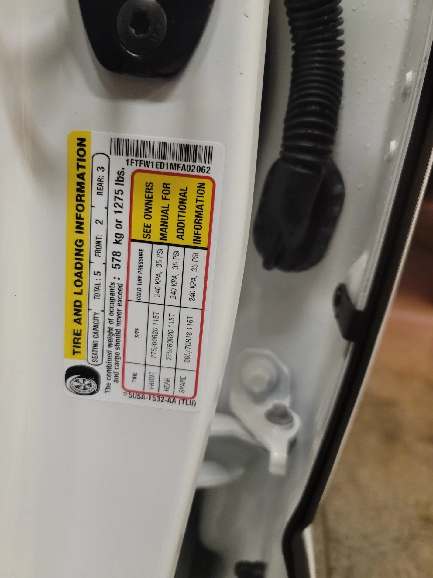

Posted this somewhere else too, for data I guess. but here is mine.
Just for comparison my KR is a 3.5 ECO, but otherwise outfitted much like yours. I have FX4, you have 4X4. You have 2kw on board, i do not. My payload is 1537 and yours is 1275. Looks like the PowerBoost takes up about 262 pounds of payload.
On my Powerboost Platinum with only Tow Tech package with 7.2kw, my payload is 1363 (Regular 4X4, not FX4).
Mine is a KR Powerboost and 4x4 and is 1465.
