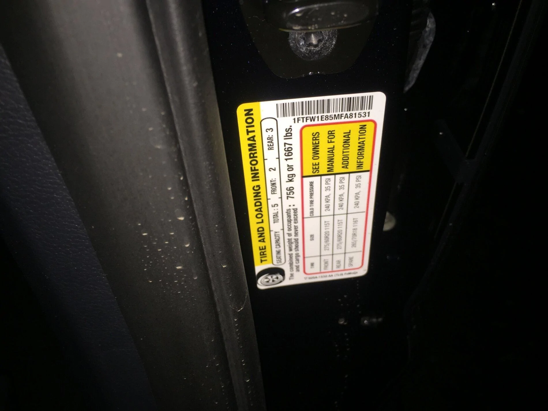

Here's mine - 1667#. 701A, 3.5EB, 3.31Std, 26gal, 4x4, Roof, Tow Tech, Work Surface.
Ford F-150 Lightning Towing Specs Consolidated Document - Bumper vs. Class IV vs. Tow vs. Max Tow - UPDATED DOC v4 Payload
